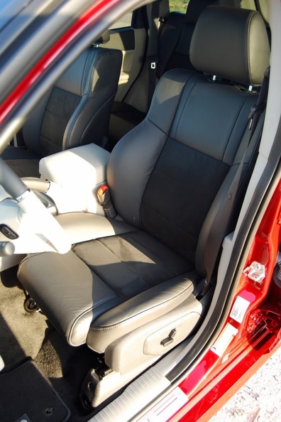

This may or may not help you visualize it. These things almost scraped the interior trim panels on my WK.
I just measured my XJ seat and my WKII seat. The WKII seat is about 2-2.5" wider.
My XJ is a 2001 model - you don't specify your model year - and I can tell you the WKII seats brace diagonally into the floor while the XJ seats brace vertically to a cross brace.
Consider also, the XJ you have is likely manual adjustment. The SRT8 seats will be power adjustment. Unless you can wire those seats to work in your XJ, adjusting the seats will not be an option.
So, unless you can find 4 - 5 inches of extra space in the front cabin, can make the XJ seat brackets fit on the SRT8 seats, and can wire up the seat electronics, I have my doubts.
