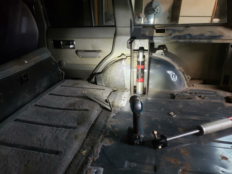

Rock Krawler Triple Rates
I agree. Ive spent some time looking at the rear.
I think the links in a trinangulated 4link will package okay.
Its the coil overs shocks or coils. That will need lots of work.
Air shocks might package okay coming through the floor actually I know they will as I've got a pair of 2.0 shocks on towers
Its al doable just depends on how much work to get it and if outcome is worth the effort over good leafs like mentioned.
Getting rid of shackles hanging down would be a plus along with adjustable suspension characteristics just bu changing link seperation
Gets me to thinking I wonder why sfr doesn't do some cantilever. the coil overs don't necessarily need to be directly tied to the axle.
Could crunch some numbers and figure out some ratios and have some tunabilty just in cantilever arms softer firmer ratios aswell as ride heith changes on the same coils

I have plenty of room in my shock towers for 2" shocks but not 2" shocks with coins on them.
Heck id run 1.5schedule 40. Oooops did i say that out loud.

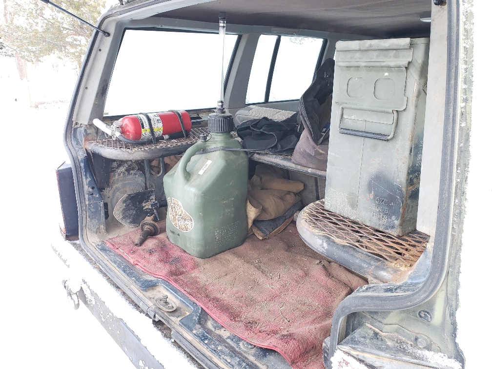

That's similar to boostwerks design. Super simple. Any plans to tie them together for strength?

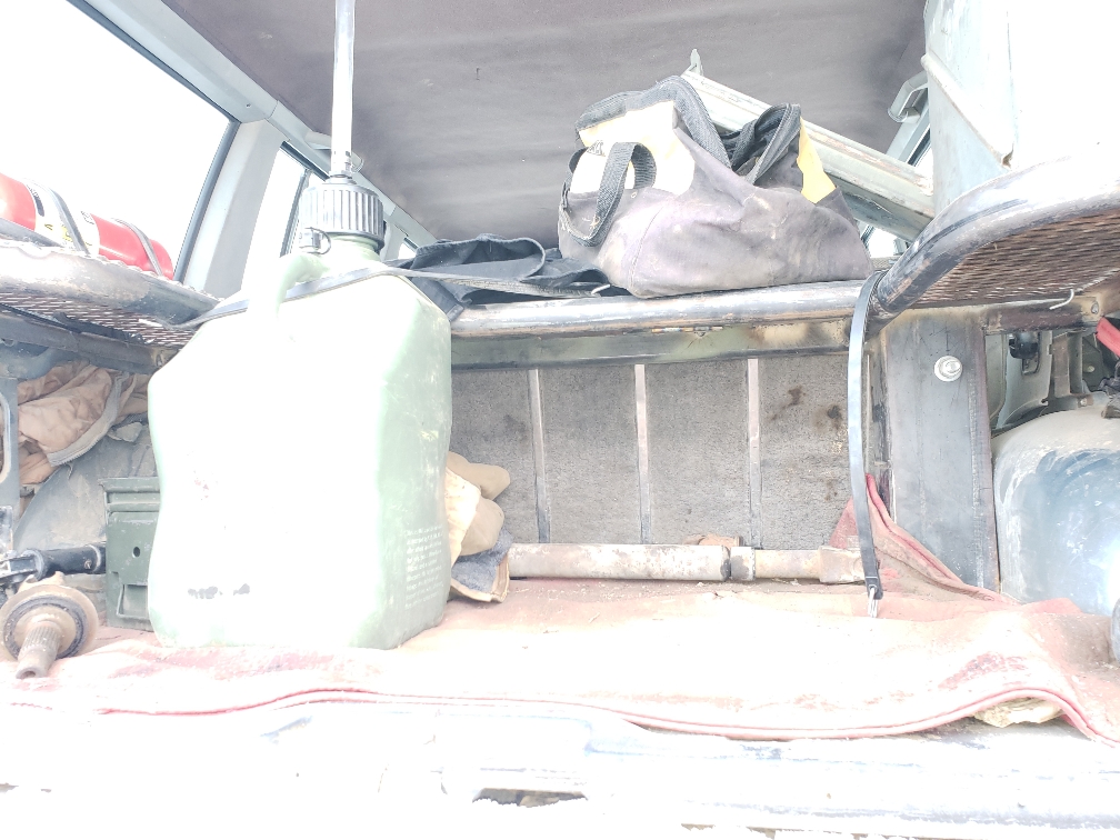

Long been barried. Was built around my cooler to creat a flat second level. The expanded metal doesnt look great but has been great for strapping stuff down
Been thinking of changing it though to creat a place for winch facing the rear. Not to mention they just fit coilovers in them.
