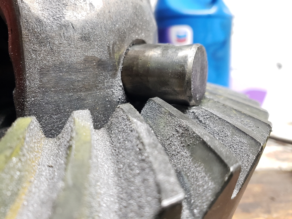

Gota make center pin fit then start trial and error
Not sure of I should grind pin or ring gear tooth. Last time I ground two ring gear teeth to fit pin.

You'd have to grind a lot of crosspin to make that work. Failure didn't come from a couple short ring teeth

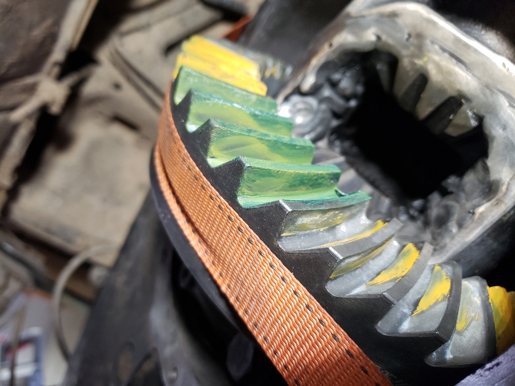

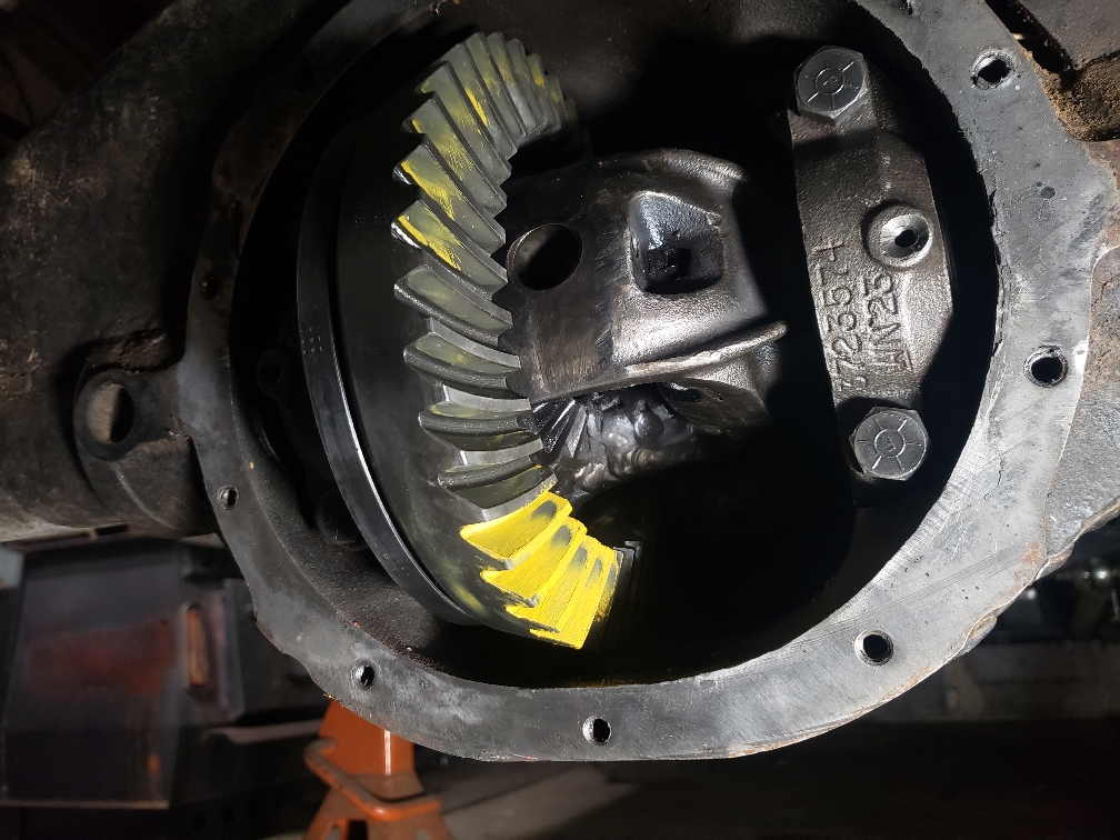

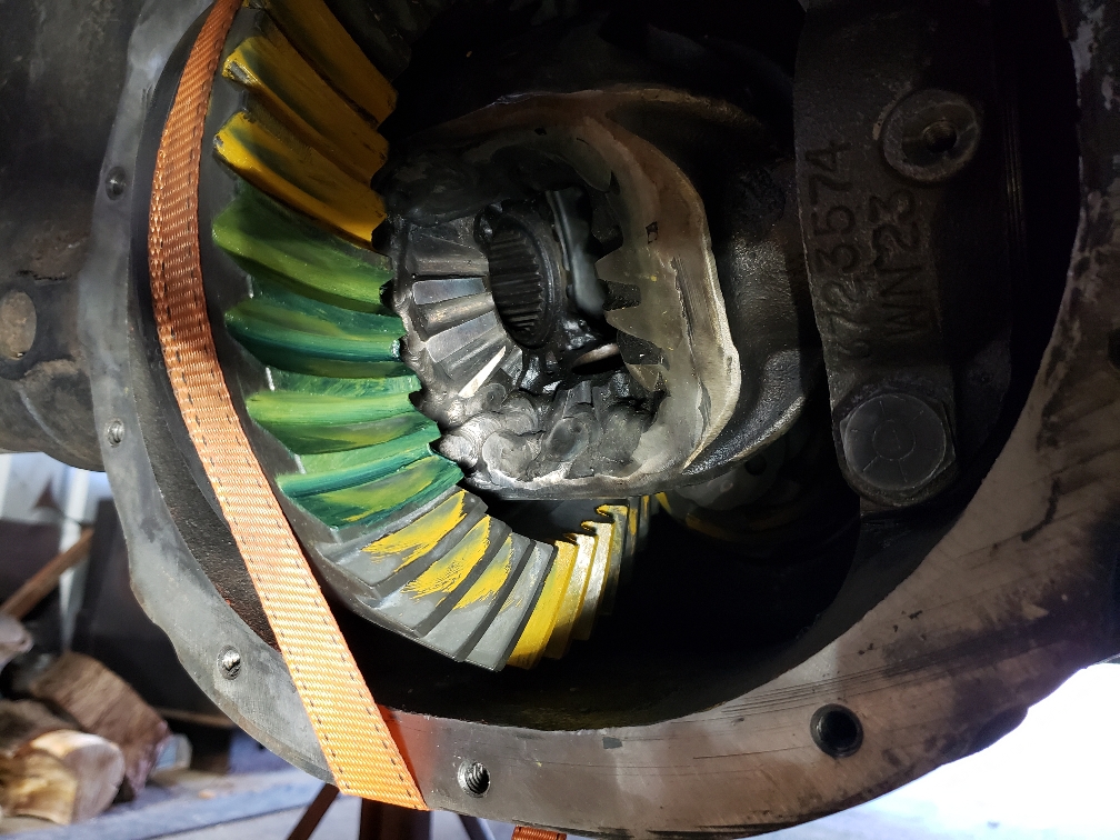

Getting ready to run a pattern backlash is a tight 6.

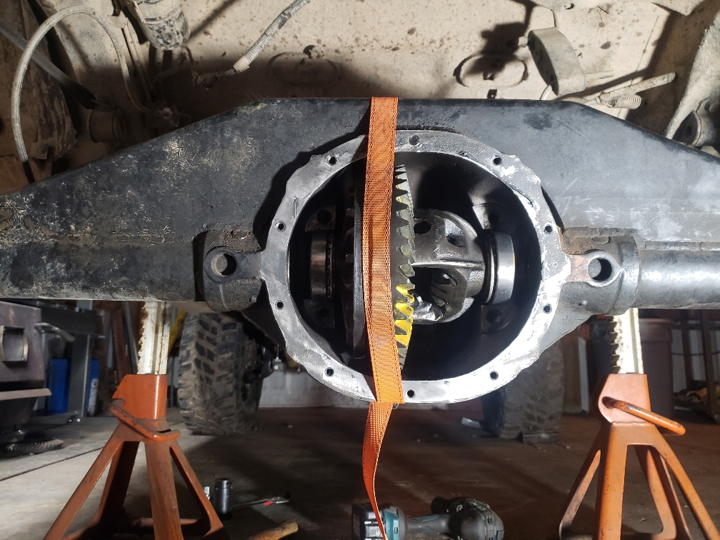

Decided I don't like the 8.25. Its much easier installing carrier shims than these damn side adjusters
You’re the first person I’ve heard admit this. Side adjusters are much quicker than stacking while I think.
That may be why the gear-set failed!
Yes I agree side adjusters may have sized me into failure, either way I screwed up
Maybe I was having a hard time. But took me forever to just get side adjusters in. Might be worth while to pull axle to do it on the bench.
I got d30 carrier pre load then had backlash set in less time than just getting carrier in and ready to adjust
There is a reason gear setups cost so much. Really tedious work and thousands of an inch matter. There are so many setting that can go wrong and then there is pattern reading. Definitely NOT something I’d personally want to rush through.

Confidence is down some but I am starting to feel backlash and hear I can make a few adjustments check it and im in the ball park at 6-8 i think 6-12 is the 8.25 backlash acceptable range. 8ish probly ideal.
I believe that’s a good pattern according to the Yukon gear setup instructions online.
