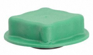

This is the cap I'm finding
index.jsp
It looks like the threads are on the outside, whereas Renix are on inside of cap.

I guess now I just need to find the right Volvo Stant cap...
Can anyone verify if the photo in the first post is the right one?
I found the same image at AdvancedAuto and PepBoys- Stant 11244
that is it.

The pressure bottle cap number has changed, it is now Stant 10244, fits mid-eighties Volvo 740 with the 2.3 L engine.
Your cap not sealing properly is most likely the coolant loss point. The Stant 10244 will seal very well on the XJ pressure bottle, it has a lower profile so when the pressure bottle expands it won't impact the hood and promote cracking of the bottle--check the underside of your hood, you will most likely see rub marks from the cap; it has a higher pressure rating so it will raise the boiling point of the coolant.
