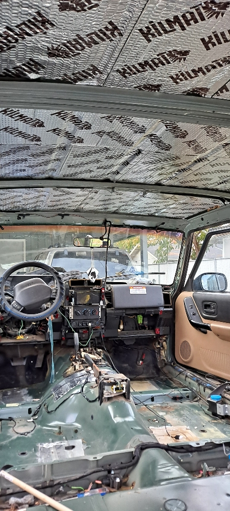

Bought kilmat sound deadener and double din panel for whenever I get around to the interior amd started ordering parts

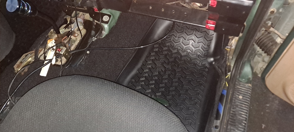

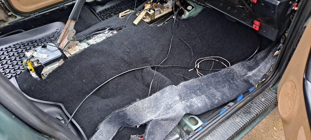

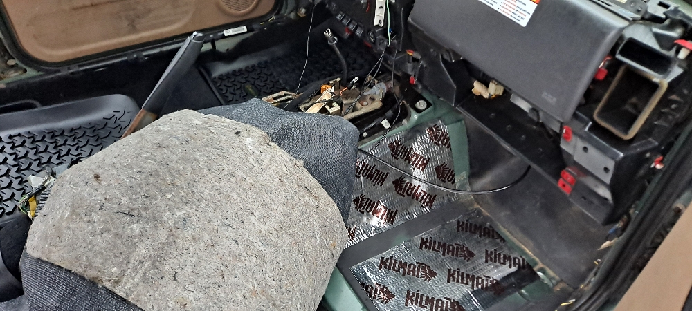

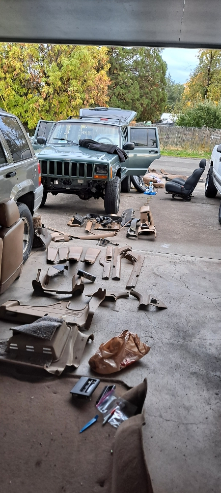

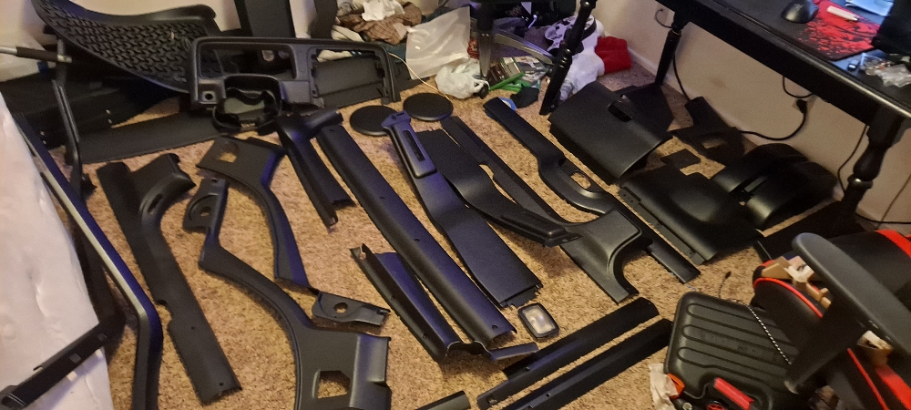

Also got a new headliner and the onewaylight kit to add to the interior. Once she up and running again and I have the time I'm gonna take care of the saggy headliner, install the sound deadener, double din and light kit.

Thanks, I got some of that kilmat sound deadener from amazon.

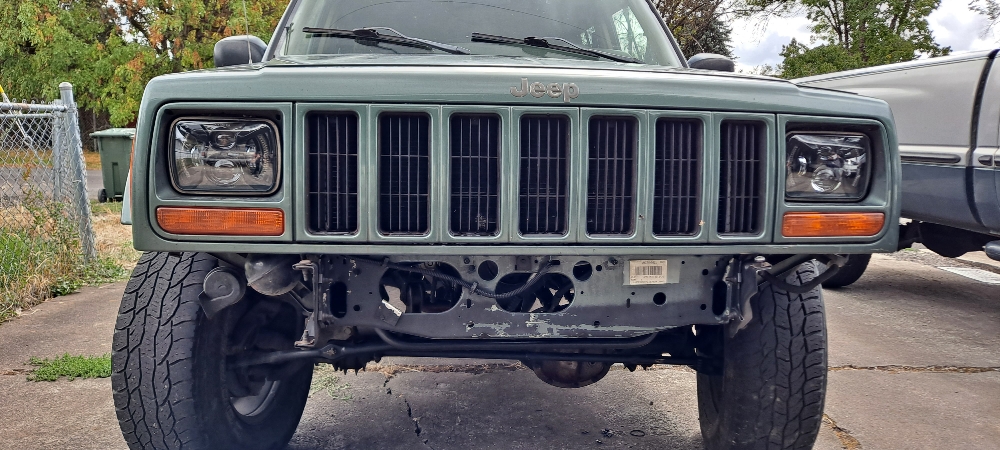

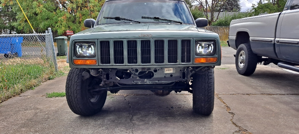

I got the downpipe O2 sensor bungs welded in and tried for a test fit. It seems like it's gonna be on the money without having to bend or grind anything, the downside is the hanger it came with was welded on in the wrong angle.

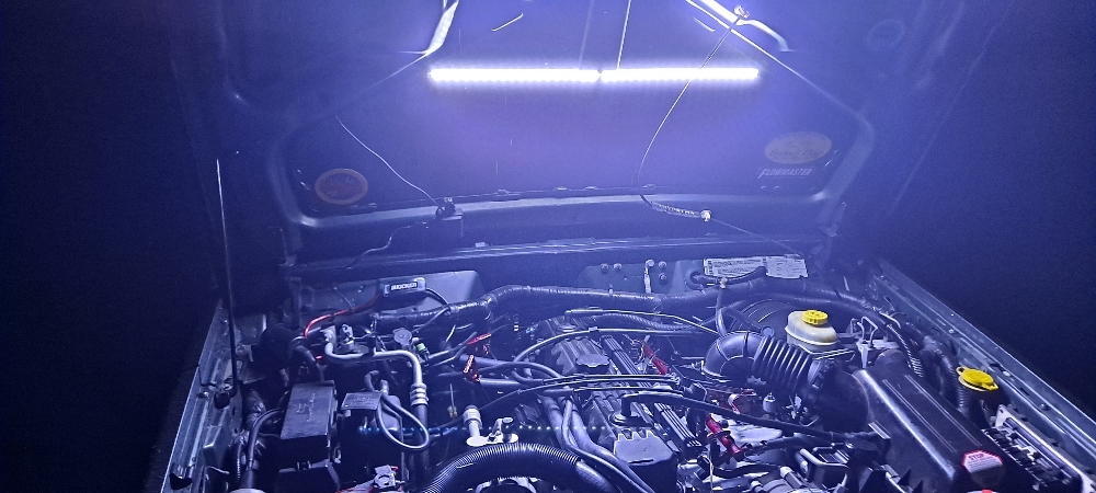

I had a little bit of time on my last R&R so I dove into it got the tranny buttoned up and today I worked on getting the engine bay buttoned up and made some decent progress. Just have a handful of things left to do before I can turn the key.

So the last two days I finished putting it all together everything went pretty smooth, put in a new transmission mount to pair with the brown dog motor mounts, got the coil pack and camshaft synchronizer dialed in to replace the distributor and hooked up all the accessories the only setback I ran into was the power steering pump reservoir I tried to fix with new o rings and rtv was still leaking which is a common problem so I just threw the one from the grand cherokee on there and it worked out.
I couldn't get the muffler on and still don't quite understand why the 2.25" inlet for the muffler won't slide into the 2.5" downpipe outlet but I have to take it in to weld the tailpipe to the muffler anyways and figure I'll leave it to the guys at the shop.
With all the seals and new parts I installed i was a bit nervous for leaks but She fired up on the first turn and after burping the radiator I took it on a test drive it sounded as healthy as can be other than being a bit obnoxious without the muffler on and didn't drop a drop of fluid.

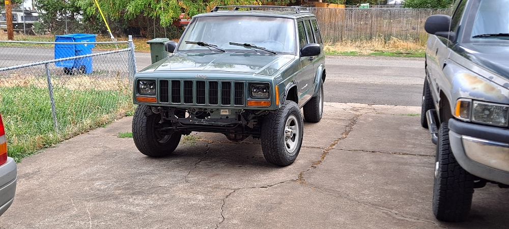

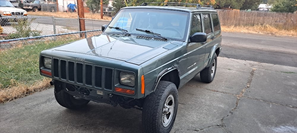

Got the exhaust welded up today at the shop and put insurance on it.
After fixing the upstream sensor code i Started getting downstream o2 sensor codes so I'll be messing with the different inserts for the o2 sensors in the next few days.

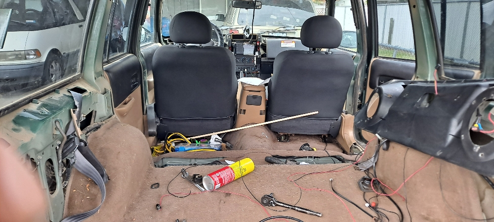

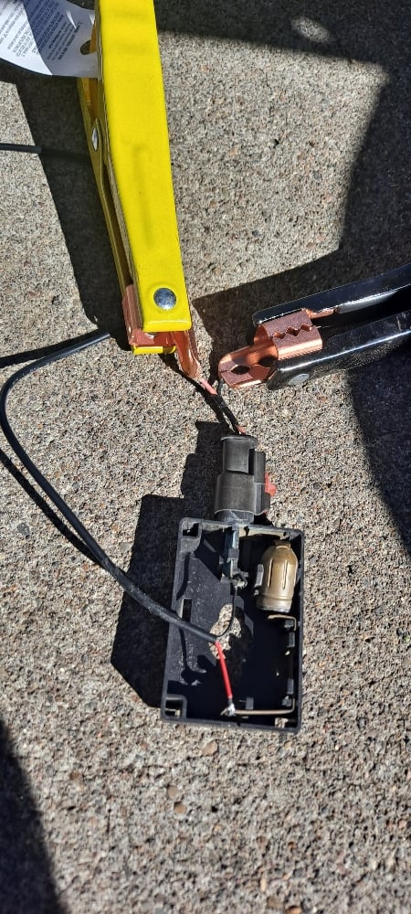

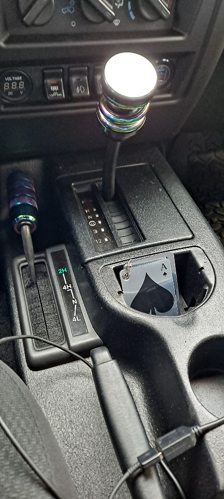

Added some of the Onewaylighting lights from the led kit and put some blue leds in the shift lights
Now I can finally start cleaning the interior lol im just Happy she's on the road.

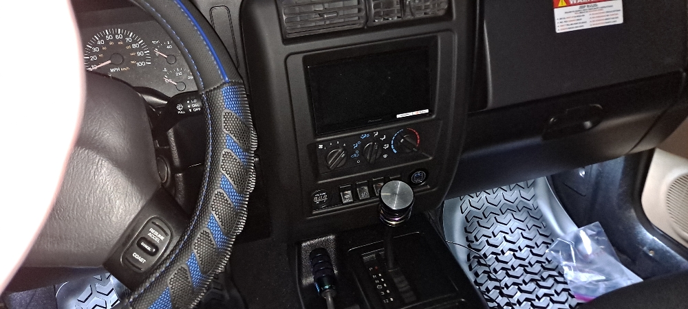

Today I added the double din bezel and installed a pioneer dmh-2660nex
Took me a while to find one that was in stock but it's nice. Capacitive touch and android auto were my buying reasons, I just plug my phone in and can use my voice to find me the nearest tacobell. I love technology.
