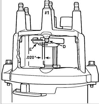

well since ive revived this thread im gonna take a pic of where my rotor sits now after cutting the ear off my distributor and reindexing for search purposes.
During my reasearch i have yet to see a pic of where the rotor sits after reindexing...(with a window cut in the cap)

Here ya go. http://cruiser54.com/?p=68

Oh wow awesome!
thats exactly what i was talking about.
Thanks!
