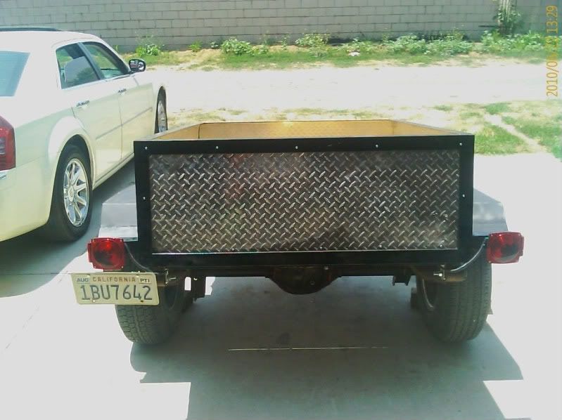

i'm still working on building the lid and i have to get some outdoor carpet for the floor and i'm gonna make sure its sealed well... doing wiring tomorrow so its road worthy then a test tug lol

i towed it on friday and she pulled straight and fine... but i need to get it out with the lights and all that u know

Sooo it's a camping trailer... just not a sleeping trailer...
It's coming along nice... I just can never get past the diamond plating... in the end it serves a function...
I wish I had your time & ambition... and temps.

its all about patience.. i wish i could do all of it in one day but if u want it right then slow and easy is the right pace... the diamond plate was picked for weight purposes.. its a 1/3 the weight as the steel and it looks cool.. there are soem discoloration of the chrome in spots so i think i'm gonna bed line the diamond plate just for looks

I'd consider tossing the 35 in favor of a trailer axle then getting some water tanks from a travel trailer and mount them low. That way you'll have your water and it will act as the counter balance. I doubt your trailer is any lighter than my M416 and I don't have a problem not having ballast in it as long as I pay attention (ie, don't go JeepSpeed with an empty trailer).

Most definetly get a 360* pintle or offroad hitch for that. My Bantam trailer has been rolled three times, once on Mojave Road and twice just on dirt roads. When it goes on a ball setup, somethings gonna break, and you'll havea hell of a time getting everything home again.

got some more done...
still need to get the lid built
