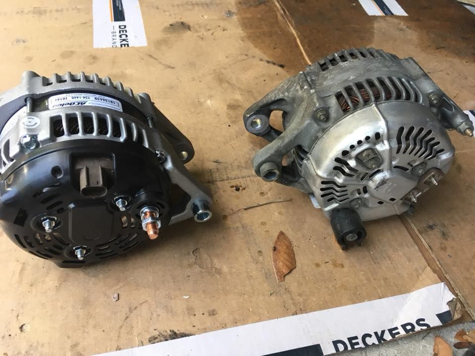

I am trying get this thing in and the bottom bolt holes is about a quarter of an inch off.. any suggestions?

I had to do some clearance grinding inside the bracket if I remember correctly.
You have to grind the bracket in 2 or 3 places. Its a LOT easier to take the bracket off of the jeep and fit the alternator do it outside using an angle grinder.

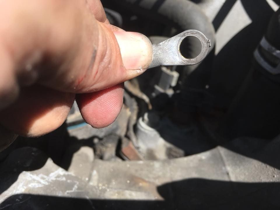

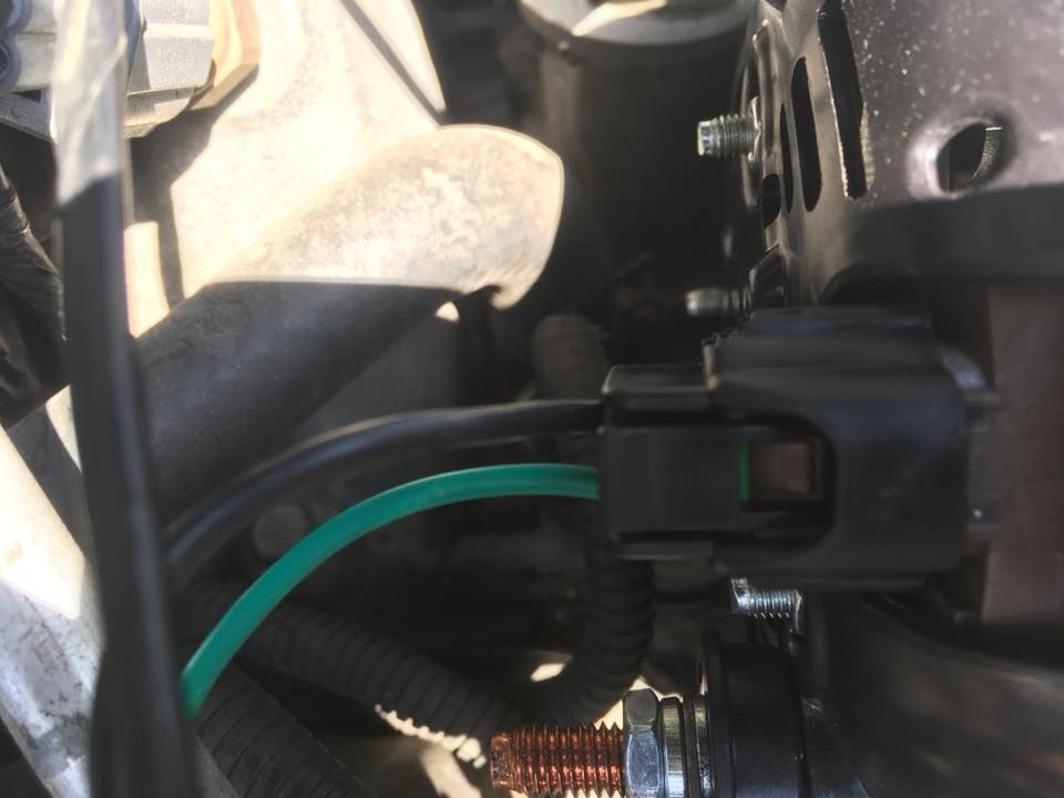

160amp 2001-2003 Dodge Durango I got AC Delco part # 334-1446 off of RockAuto. The plug for the back of the Durango alternator I got off of EBay for $12.00. - https://www.ebay.com/…/ALTERNATOR-REPAIR-PLUG-…/291611891043. You simply cut the wires going to your Alt before the black connecting box, there will be 3 wires going into the box, a green, a green with purple stripe and a thick black ground. I soldered the green to green on the new harness/plug and green/purple to the black on the new harness/plug . I then just extended the thick black ground wire and put a new eyelet on it and attached it to the top of the alt bracket (where the brace between the manifold and alt bracket is bolted) . The new post on the Durango alt is too wide for the eyelet on the original red charge wire, simply open it up a little wider with 5/16 drill bit and it will fit.
Stock ZJ Alt and new 160A Durango Alt
Alt that I used for the swap
New plug that goes into the back of the Alt
Opening up the red charge wire to fit
