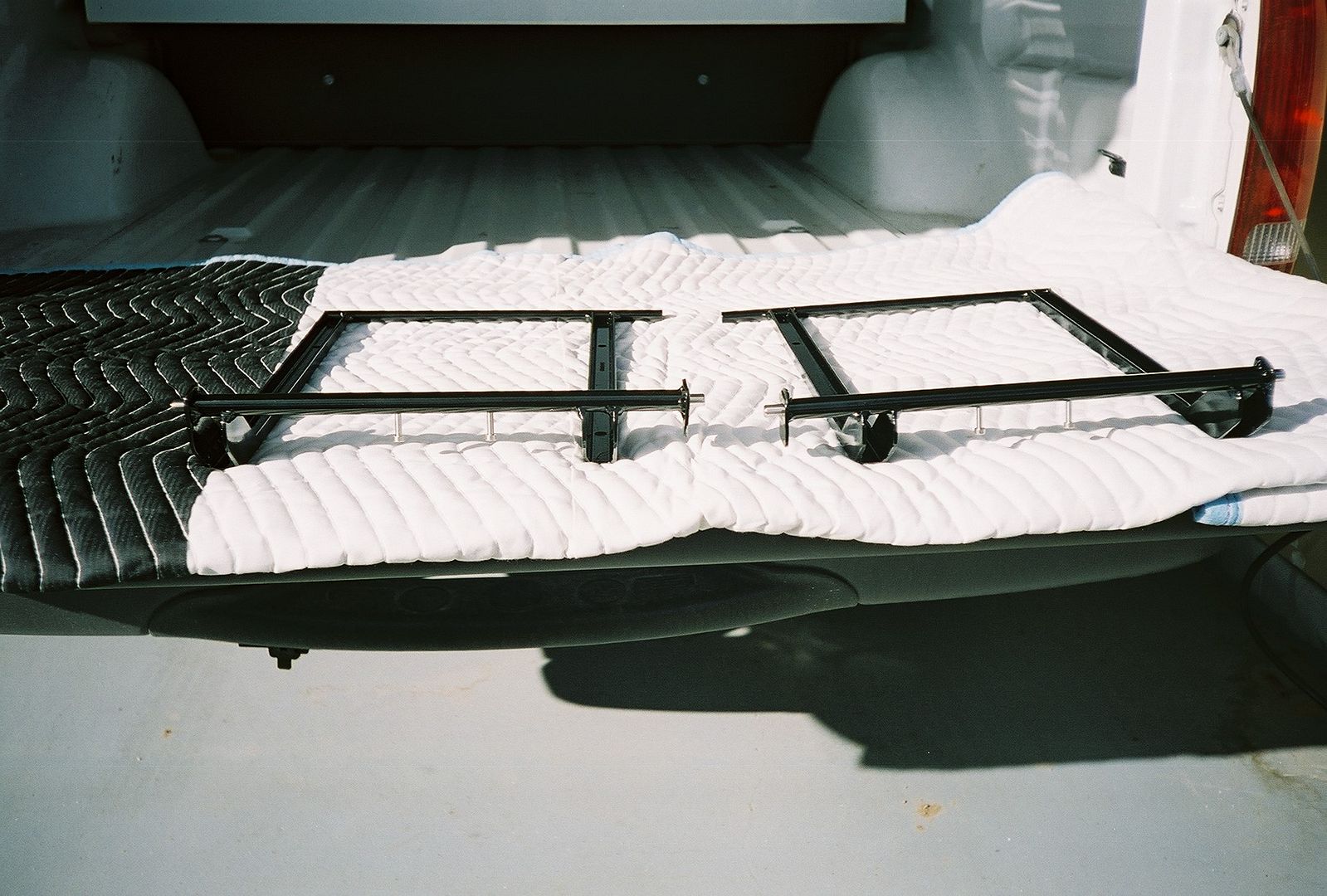

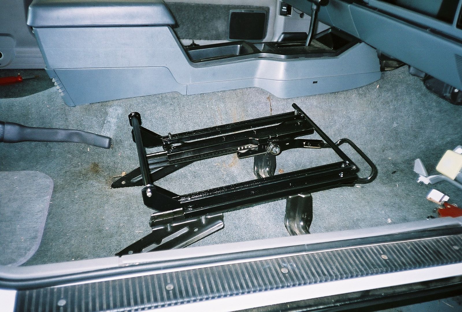

Here's the brackets I made for my '95 2dr with Baja SS's and a tilt forward feature.
