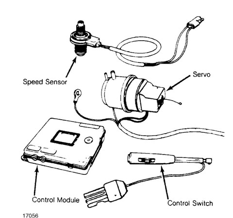

working on the cruise problems for my 92, i found that i do have the vacuum release on the brake pedal.
where is the cruise control module? as pictured below
the brake light switch sends an electrical signal to what i think is a electric servo kinda thing in the vacuum line, this is all under the dash, the vacuum hose disappears into the middle of the dash behind the heater...
how do i test this little vacuum thing? i think it works because when i shut off the jeep the first 4 or so pedal pushes, you can hear a hiss of a release of what i think it vacuum, but that could be the booster too....
any other ideas to help?

anyone know where the speed sensor wire is located? or the cruise control module?
