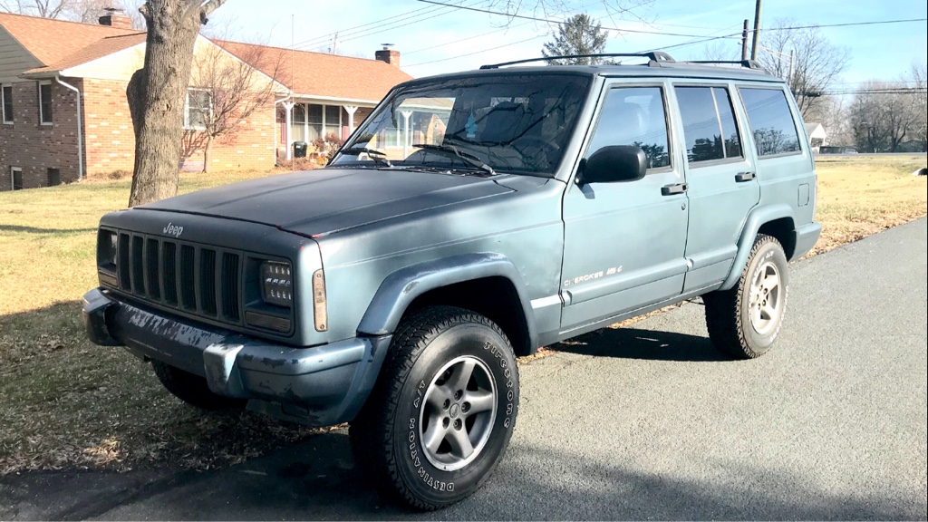

Hey all.
I’m new.
I picked up a 99 two weeks ago from Florida and drove it up to the Maryland/Virginia area for the holidays. I’ll be up here for awhile so it seems with some family issues.
In the meantime I would like to get to know this vehicle by doing a lot of work on it on my own or with a buddy. I’m not really familiar with anyone up here and these vehicles so if anyone is out there who has a “do this first” checklist, that would be great.
Other than that, I’ll be reading through the forums
I threw those LEDs on there before so left. They’re great.

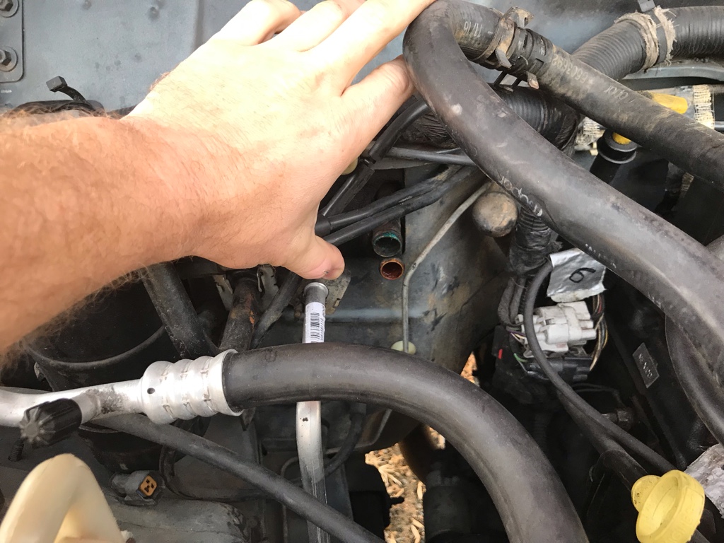

It looks like my heater core has been disconnected and the inlet and outlet hoses have been connected.
I suppose someone determined it was clogged/leaking...

Yeah that ain't good. Hope for clogged and not leaking.
I think I’m going to assume it is leaking and tackle the job of replacing it.
But I might as well go for the A/C evaporator and fan blower.

I have never done one. Plenty of write ups. It is a time consuming, 10 hours, tedious job. But not difficult. People will tell you to label everything carefully and take plenty of pictures.
The big thing for you will be what heater core to use. Google it. Not pretty.
This seems to be more of a favorite but....
https://www.superiorcooling.co/4874...jeep-cherokee-comanche-wagoneer-wrangler.html
One guy will say that his Auto Zone one worked out great and the next guy will say his Auto Zone one did make the year. And this is not a job that you want to do twice.
I think my Evap core has a small leak but really don't want to go in there. My heater works fine. But if I do should I replace the heater core while there? That is the question.
And another thing I don't really see guys talk about is bringing the heater core to a radiator shop. As long as it is a copper/brass one they might be able to deal with it just like they used to do with radiators back in the day. Before they became half plastic. I stopped by a radiator shop to ask. They said sure but the end result depends on what they start with and even then there are no guarantees. So.......
