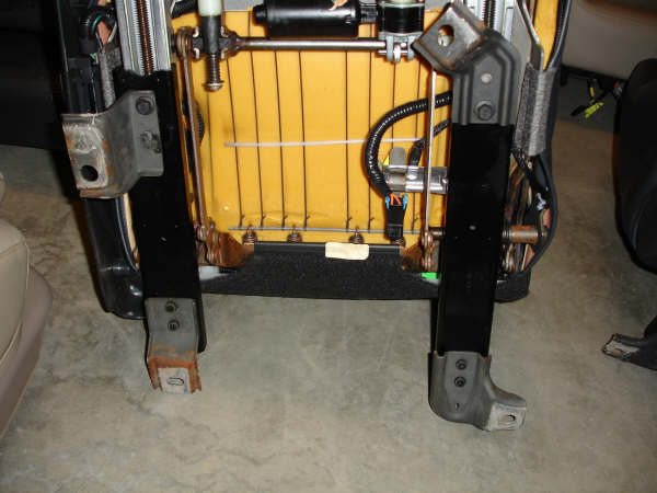

The seats have large aluminum rails with steel feet riveted on. The feet went every which direction, at different angles and heights, but the rails were straight, so first order of business was grinding off the feet and drilling out the rivets.

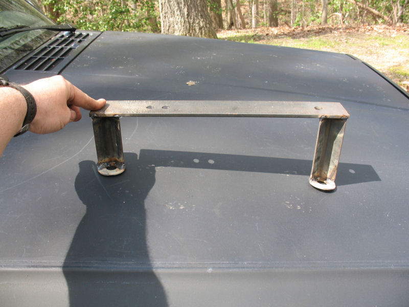

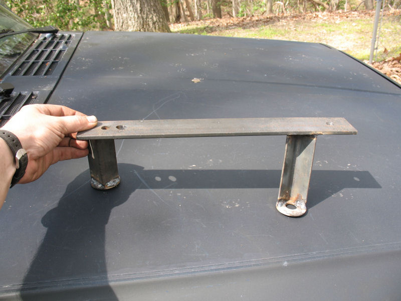

Here are the two pieces that I came up with. The first one shows the outside strip that is next to the door, and the other is the inside strip next to the hump. As you can see, the angles and positioning is kind of awkward.

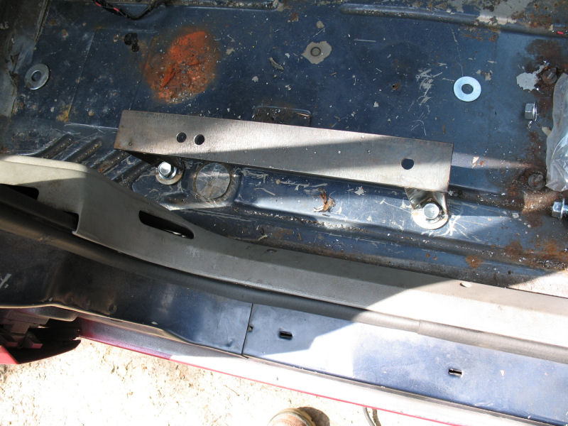

Here is the outside bracket installed. Note that the feet rest on the raised flat area of the floorpan next to the door and the drip channels are not blocked.

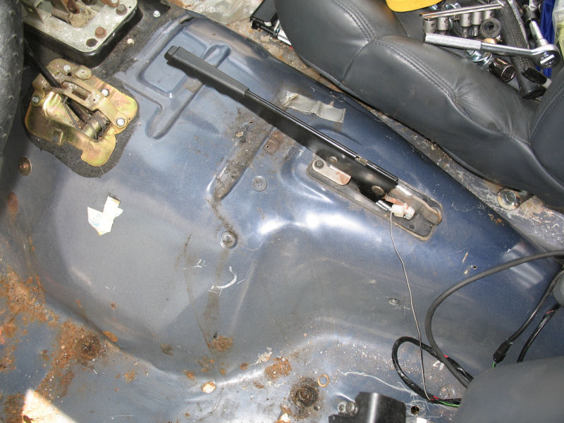

The hump was much of a problem for the driver's side. As you can see the hump shoots way out on the left, and this prevented the front inside leg from being usable.
Even thought I mirrored the brackets exactly, the driver's side seat ended up closer to the door for some reason and was rubbing against the seat belt tensioner, and it was also missing the front inside leg because of the hump. We moved the outside legs over a bit and then putting the inside leg further back on the rail so that it could stand in the open area just behind the hump (as I said, many attempts), and that seems to have fixed it. Also, newer seats have the belt attached to the seat instead of the chassis, but the XJ floorboard is very weak and would not be able to restrain the seat and whoever was in it. Besides which the XJ buckle would not work with the S-10 clasp. So I removed the clasp and reattached the XJ clasp to the body mounts, and then slipped that through the opening. Here is a shot of the driver's side installed.

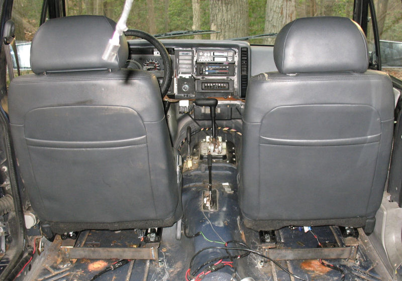

Finally we welded some ribbon stock between the rear legs so that the seats would have more bracing. Here is a shot from the rear.
You can also see the power leads there--power is from the stock plugs, with a secondary lead from ignition for the heater, which is then tied into a stock S-10 pigtail. The wiring is pretty simple since all the controls are on the seat. Really, the wiring is the easiest thing about this.
