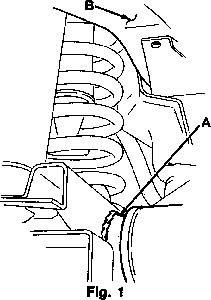

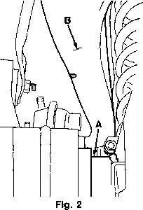

Poking around in the back of the '85 Factory Service Manual the other day, I was surprised to find a section on suspensions that gives the factory's OFFICIAL measurements by the "dirty" method. For the benefit of anyone who is interested, here they are:
Checking Front Ride Height
Measure front ride height with the vehicle unloaded (no luggage or passengers) and with the fuel tank full.
Place the vehicle on a level surface and measure the veryical distance between the top of the axle tube (A) and the underside of the frame sill (B). Refer to Figure 1 for driver's side measurement and Figure 2 for passenger side measurement. Be sure each measurement is taken from the top of the tube and not from the axle or shift motor housings.
With Standard or Soft Ride Suspension, vertical distance should be 17 cm (6-3/4 inches) plus or minus 13 mm (1/2 inch). With Heavy Duty Suspension, vertical distance should be 20 cm (7-3/4 inches) plus or minus 13 mm (1/2 inch).

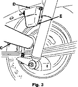

Checking Rear Ride Height
Measure rear ride height with the vehicle unloaded (no luggage or passengers) and with the fuel tank full.
Place the vehicle on a level surface and measure the vertical distance between the top of the axle tube (C) and the underside of the frame sill (D) inboard of the jounce bumper (E).
With Standard or Soft Ride Suspension, vertical distance should be 15 cm (6 inches) plus or minus 13 mm (1/2 inch). With Heavy Duty Suspension, vertical distance should be 18 cm (7 inches) plus or minus 13 mm (1/2 inch).

Originally Posted by Eagle
The letters in each paragraph refer to diagrams, which I have no way of reproducing
How about these?
Robert

Originally Posted by I_1BADXJ_I
How about these?
Robert
Them's the very ones. Thank you, kind sir.

Take note, figure 3 shows a MJ rear axle/suspension, and will look different in a XJ.
