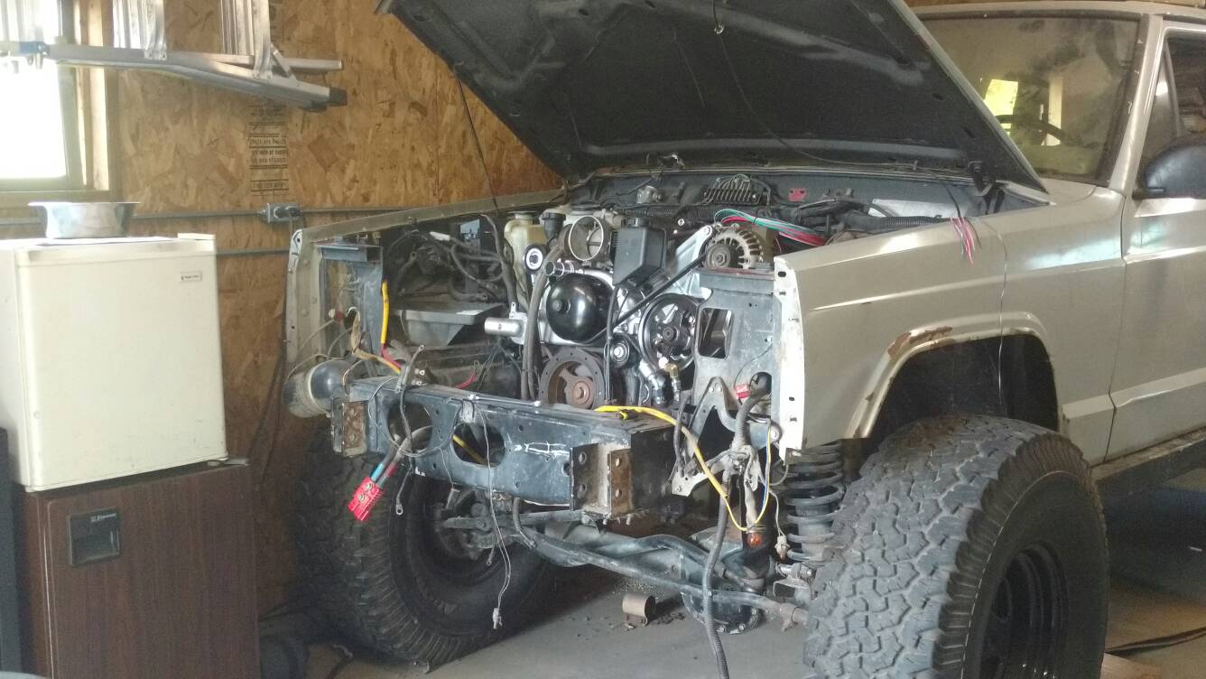

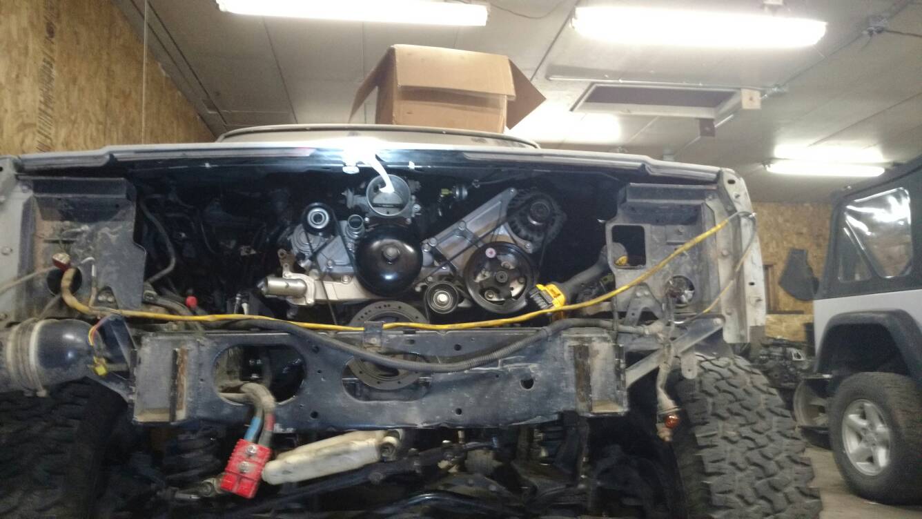

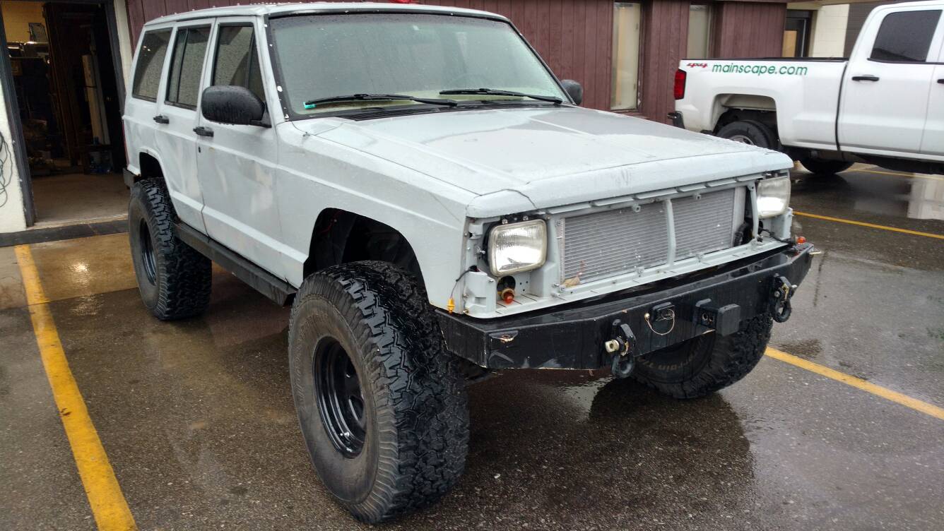

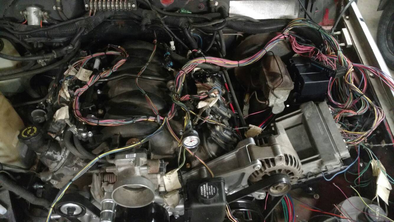

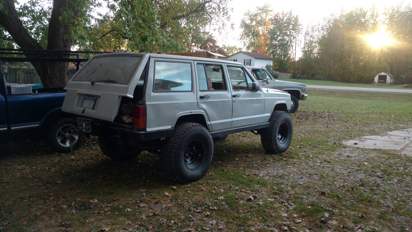

New member here figured I'd share my Jeep I just got done installing an lm7 in
Sent from my XT1565 using Tapatalk

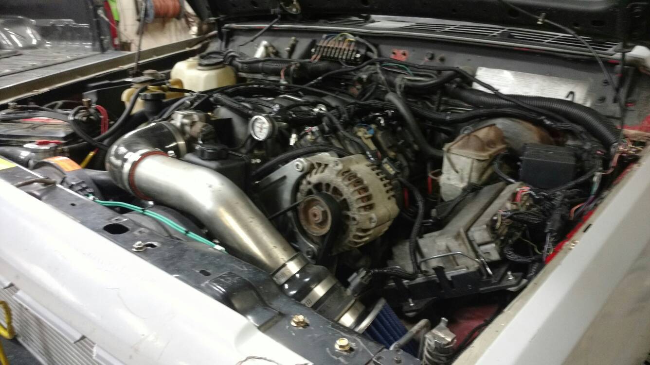

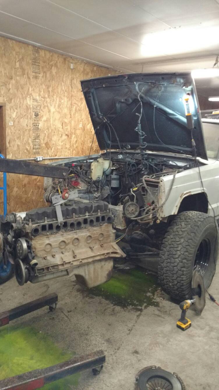

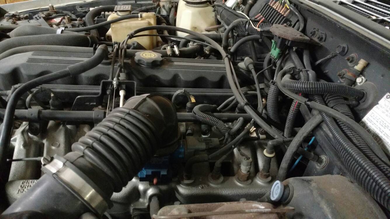

4.0 coming out

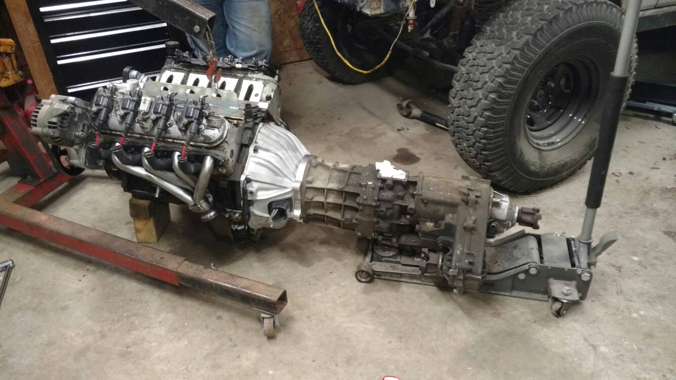

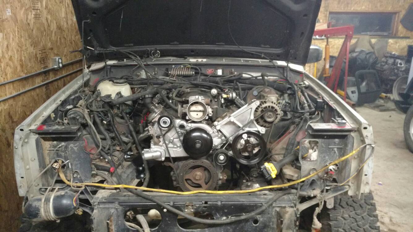

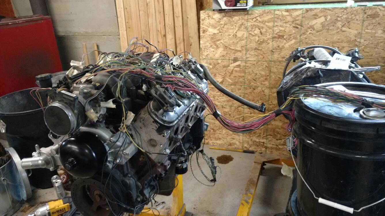

Engine getting prepped for install

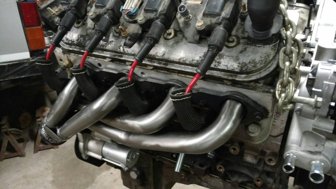

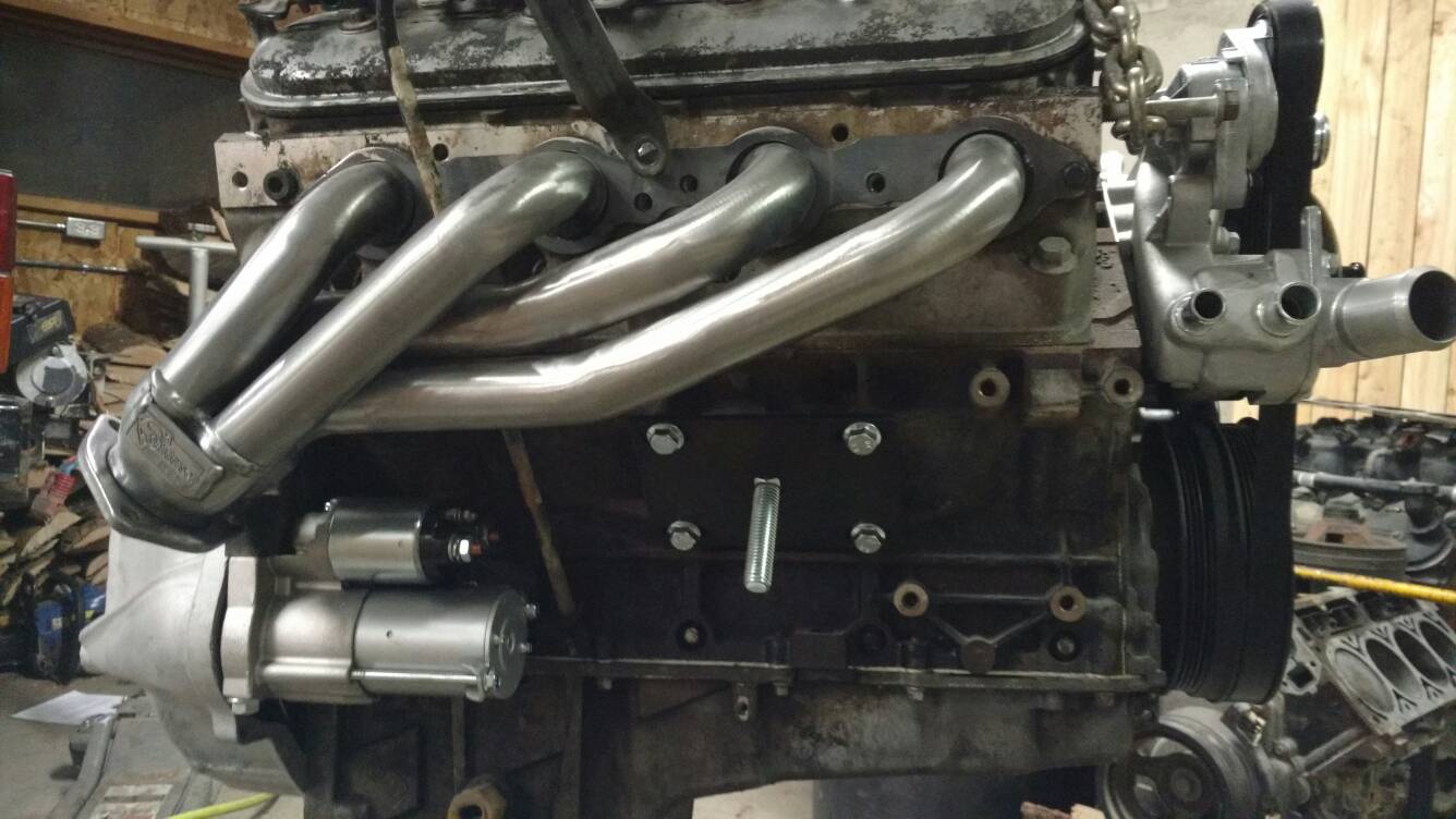

5.3 swap

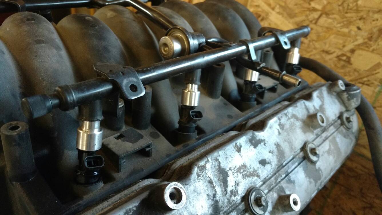

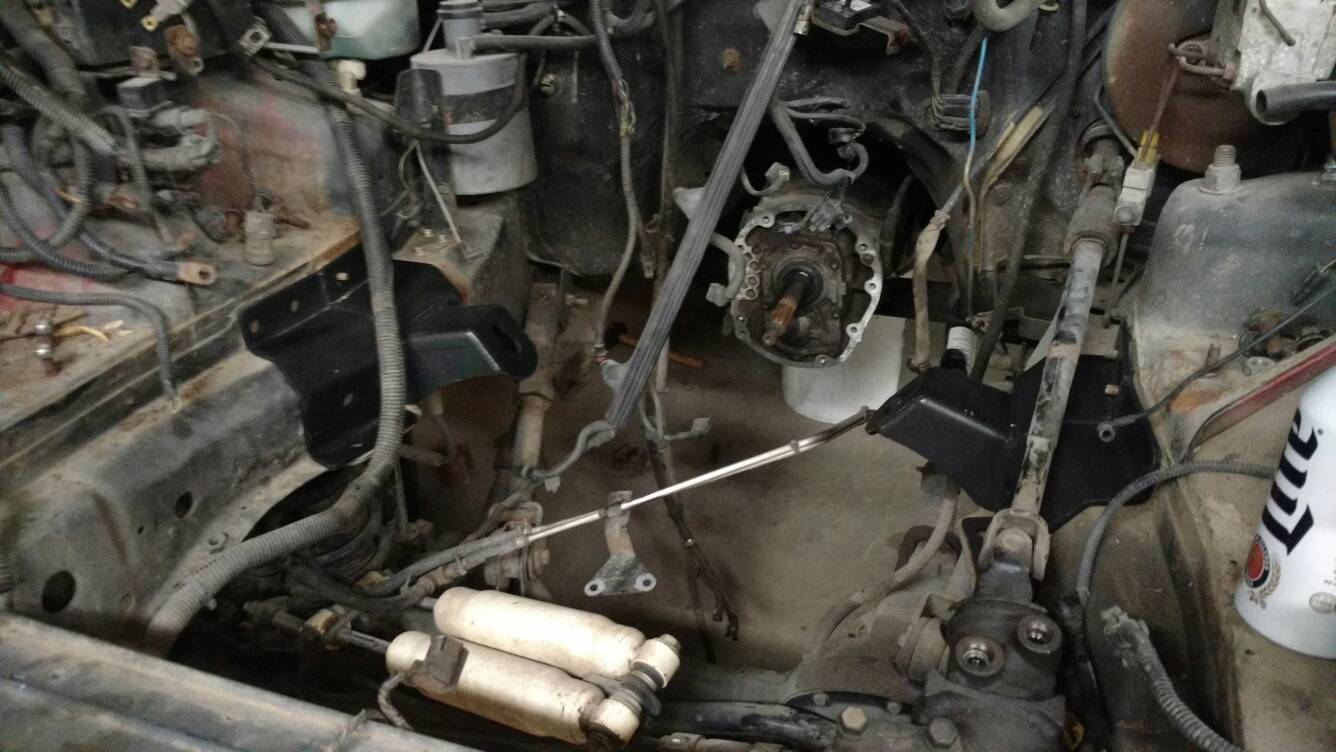

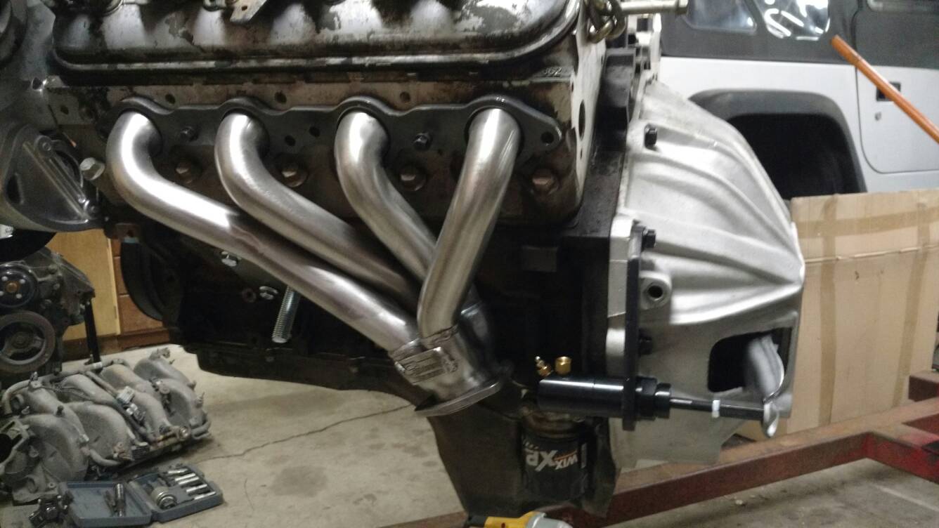

Novak headers, Novak slave retrofit, Novak ax15 to Chevy bell adapter, Novak motor mounts

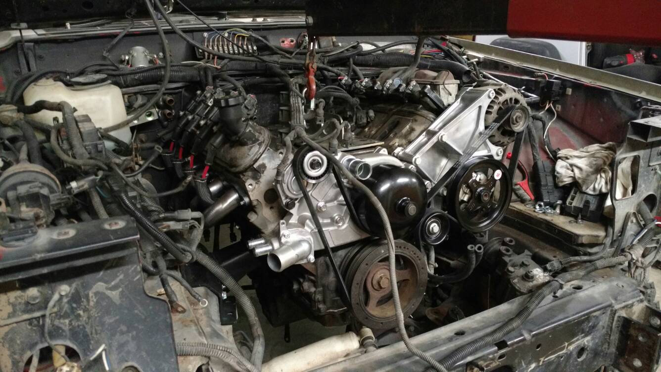

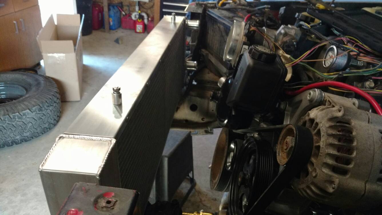

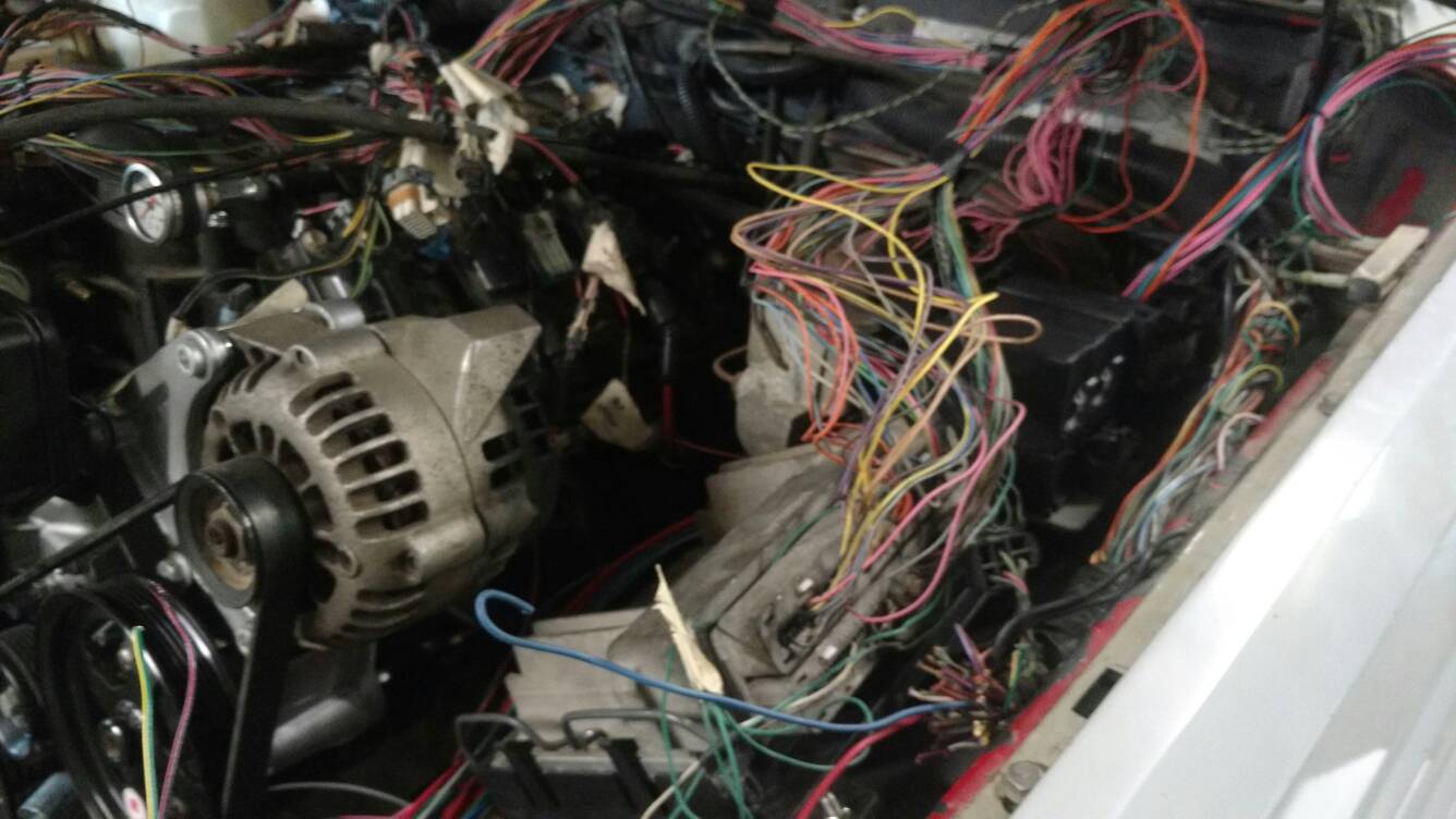

Initial install and wiring nightmare, Novak radiator

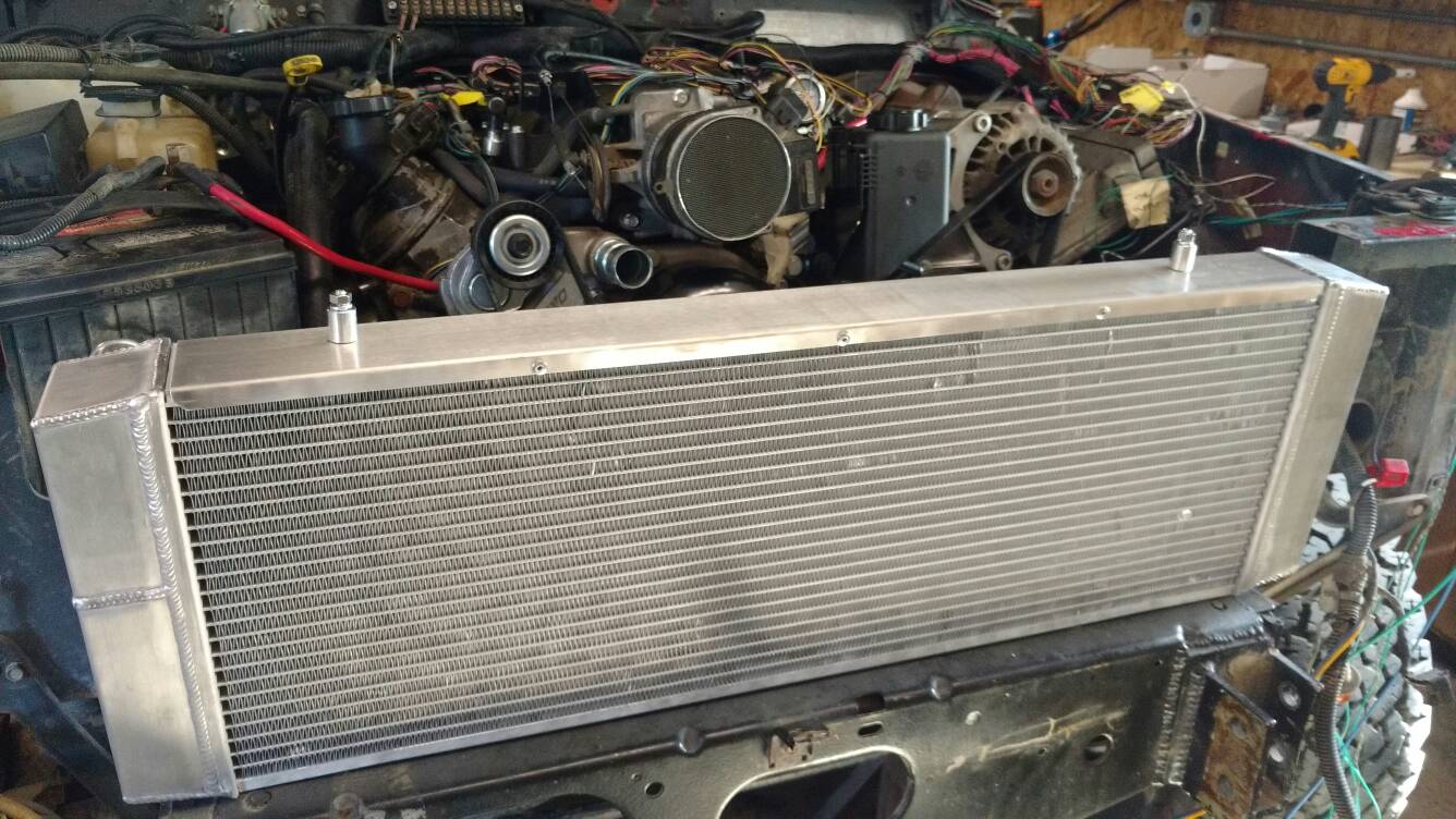

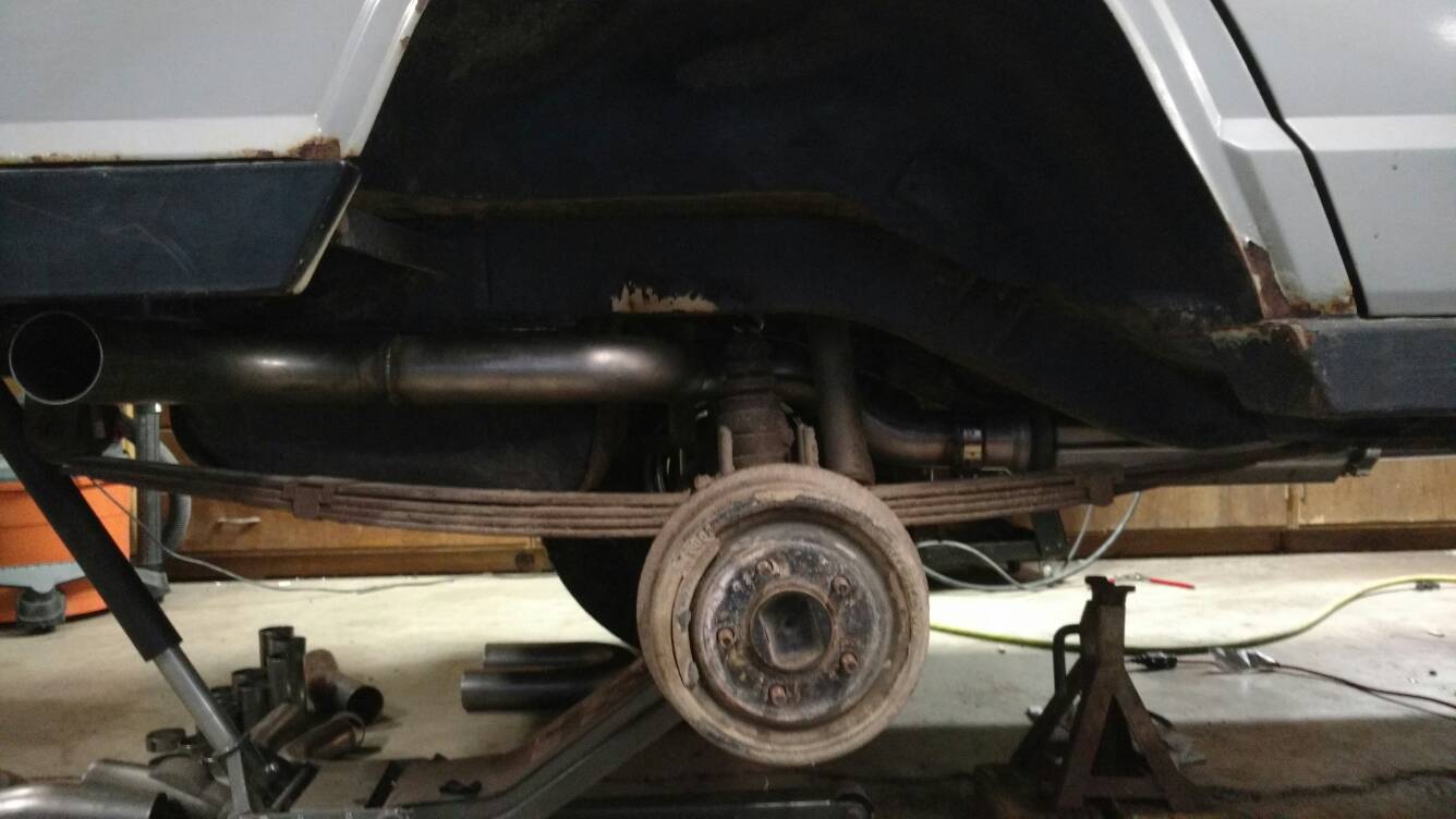

5.3 swap

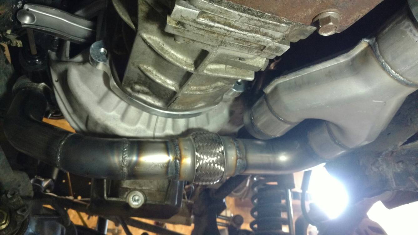

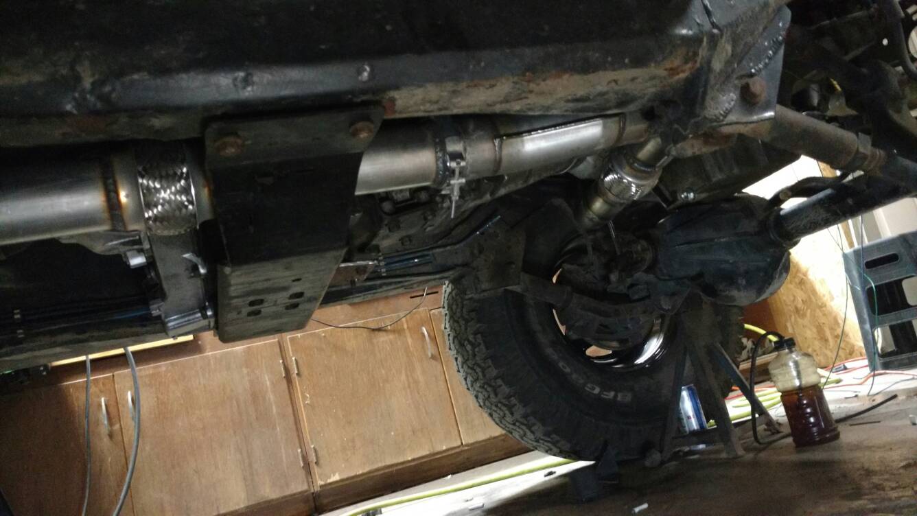

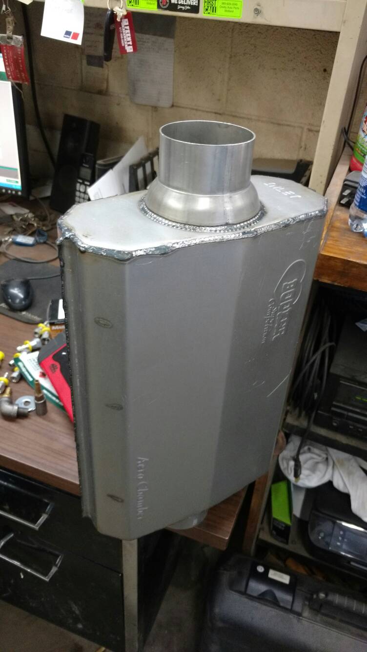

Exhaust system getting built and a couple mufflers I can quickly interchange with the whole system using v bands

Old November 14th, 2017, 10:49
sm465np205 sm465np205 is offline
Join Date: Nov 2017
Location: Midland, MI
Posts: 12
5.3 swap

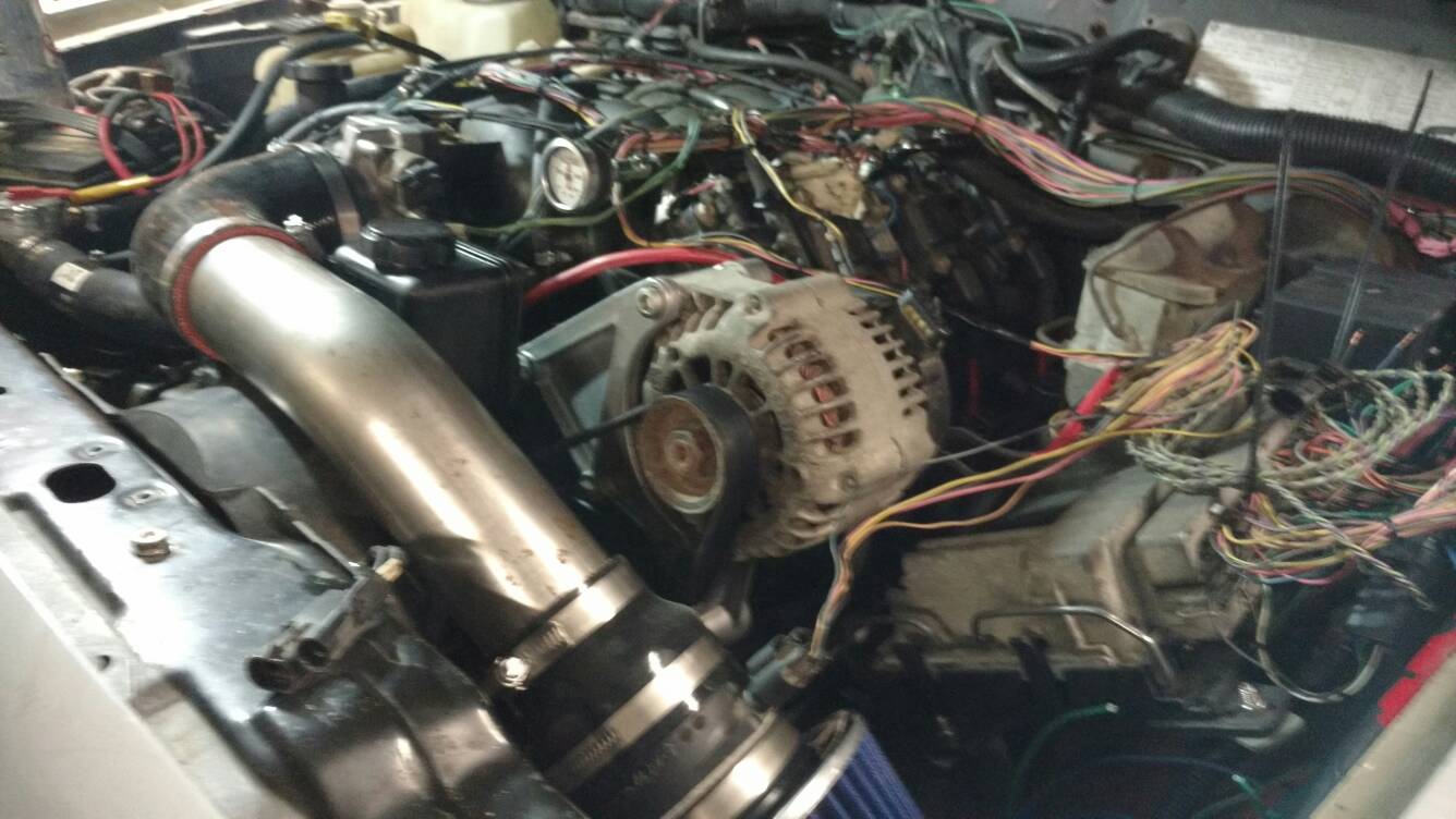

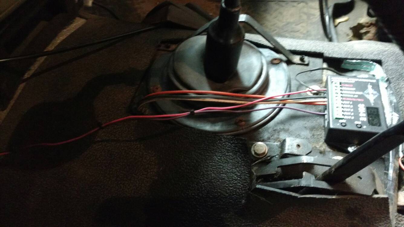

Wiring all wrapped up and Dakota digital vss interface to convert the Chrysler speed signal to 128k ppm LS compatible

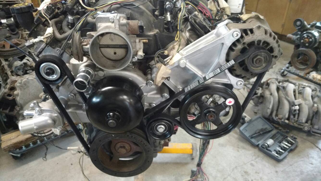

Re: 5.3 swap
What did you do to get the engine so low....most swaps I see have to cut the hood

Re: 5.3 swap
you have to use LS1 style intake, truck intake is too tall
sm465np205 - I want to see the first ride video with the manual trans

  #13
Old November 15th, 2017, 05:04
Join Date: Nov 2017
Posts: 12
5.3 swap
Yeah I'll have to rig the GoPro up on it. Been driving it now for a couple weeks. The thing is an absolute rocket ship and it's not even tuned yet. 4.10s and 35s. Could not be happier that I was able to keep my trans

Posts: 12
5.3 swap
To stay under the hood you need a car intake as mentioned and the Corvette accessory drive. The F body drive puts the alternator in interference with the steering gear. I bought the Vette water pump new, used Pontiac G8 balancer (same belt spacing as a Vette), and a Holley alternator/power steering bracket which is a copy of the factory bracket. What's cool is the Vette drive takes a type 2 power steering pump, not a Saginaw like the truck drive. I was able to slightly modify the WJ v8 pump I had on the 4.0 and use it on this bracket. Currently has a 105 amp alternator but the optional 140 amp unit bolts right up
