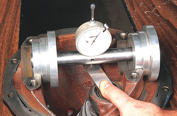

Does anyone know where to find dimension "A" for an 8.8 in the picture below? Or, "G"?
I 'built' a rear end at the junkyard the other day by taking Crown Vic 3.08 Gears and putting them on a '97 disc brake Explorer 3L55 carrier (to get disc brakes, the 'highway' ratio and a limited slip), but forgot to measure the 3.55 pinion+spacer so now I don't have a don't have a starting reference point for my pinion setting.
Ratech makes a funny little offset tool that you can use, but I think it would be more accurate to put a parallel across the bearing cap mount or even across the low point that they reference rather than just to one side. http://www.powerperformancenews.com/...10/REAR-10.jpg

Yes, I am considering this as a 'new install' at this point. The Ford manuals show setting up the pinion depth first with their fancy gauge; I'm trying to explore other options. I think their setup is a bit 'over the top' for a relatively simple measurement.

I'm looking for this type of info, but for the 8.8 of course.

PDF Including most common pinion dimensions from TD Machine, who makes a very nice pinion checking tool:
http://www.tdmach.com/Deluxe%20Pinio...er%2011148.pdf
