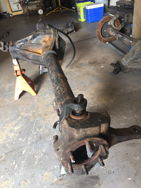

Only real question I have at the moment is about Dana 44 knuckles. My FSJ 44 does not have flat top knucks. I have found a 1978 GM Dana 44 that has flat tops for cheap. Uses 6 bolt spindles as well. Driver side already drilled and tapped. Question being, can I use just the GM d44 knuckles and bolt all my FSJ d44 spindles, hubs, rotor, caliper? Or do I need to stay GM from knuckle outward?

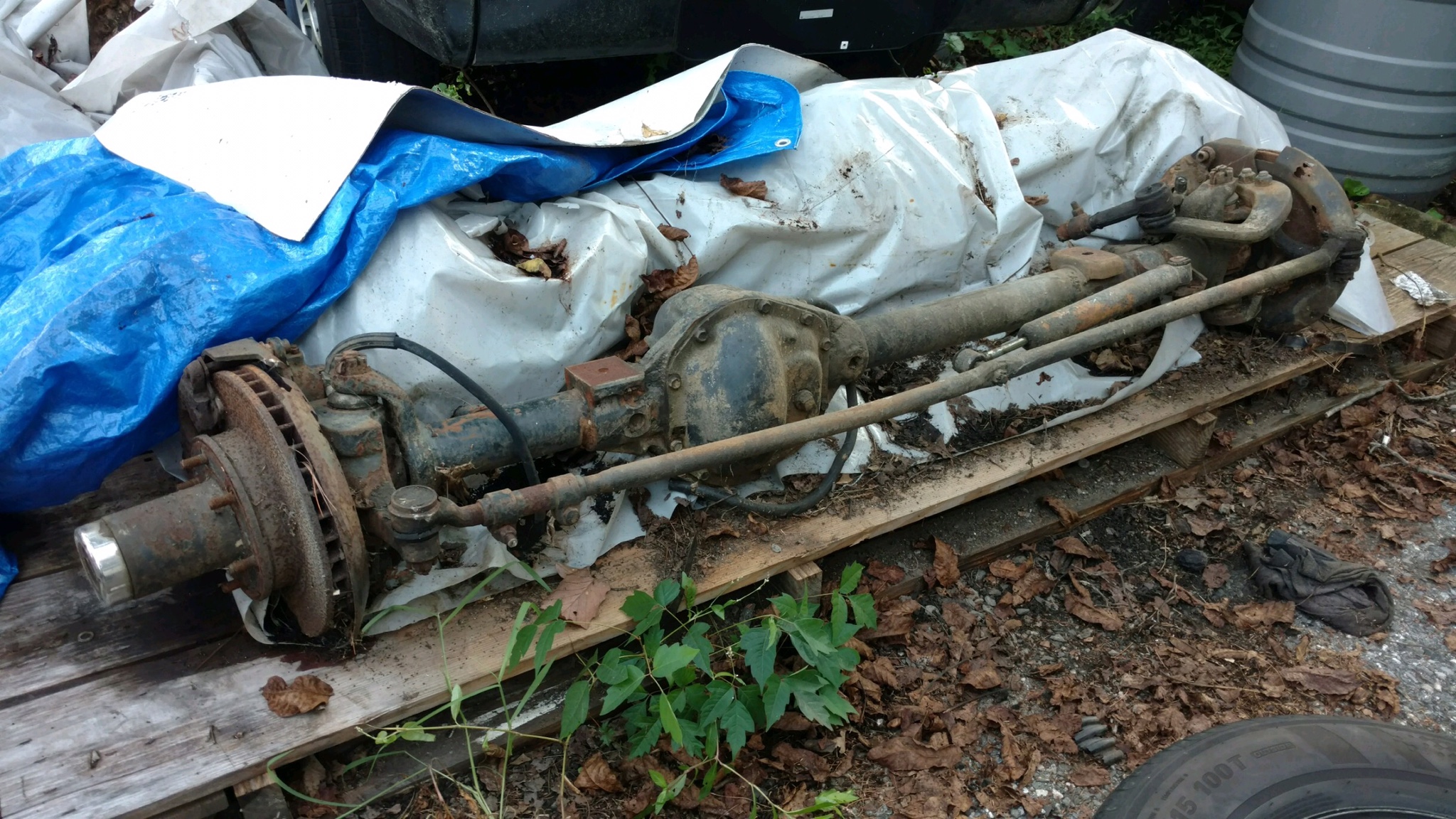

Pic of GM d44

Yes, you can use the chevy flat tops and bolt all of your FSJ stuff to them with the right years.

That's all I needed to hear. Thank you
I was unsure due to that page talking about 73-76, since they started phasing in the 10 bolt in 77. Plus there's a statement about having to use brand specific from knuckle out, so I wasn't sure if you could swap between Dana this and that.

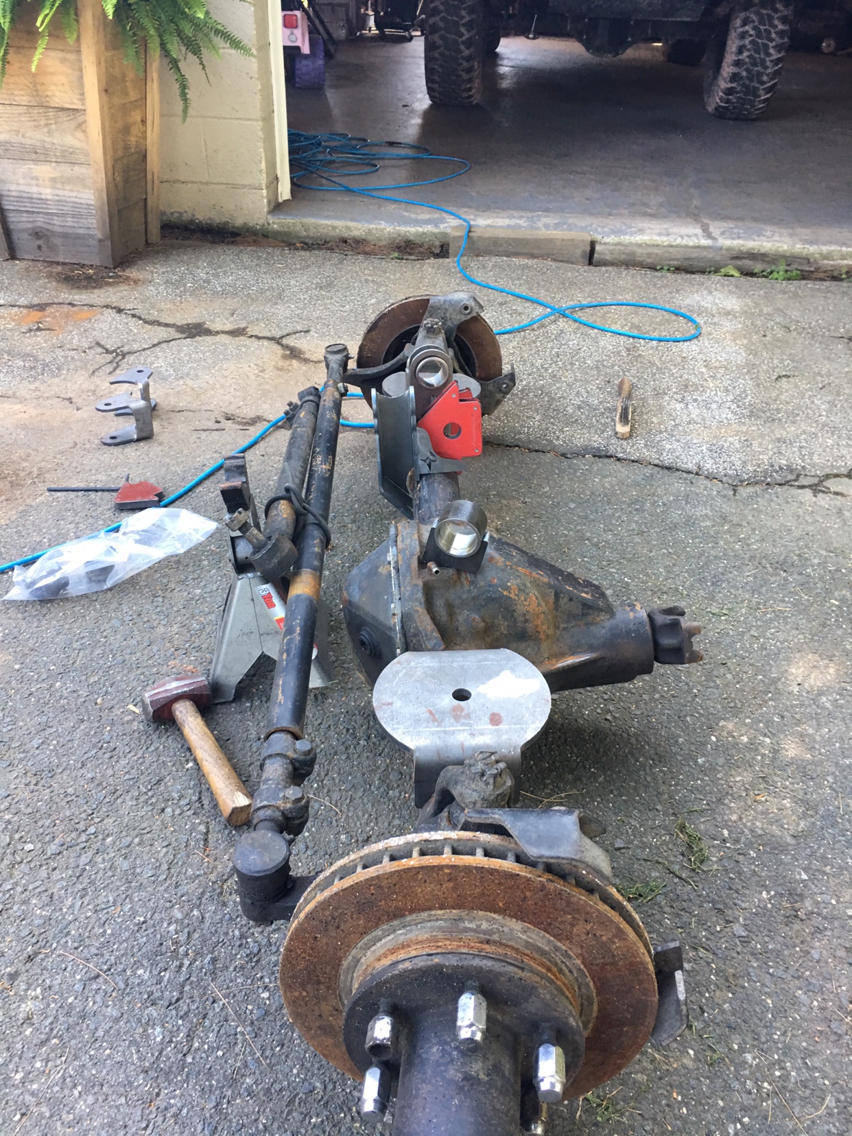

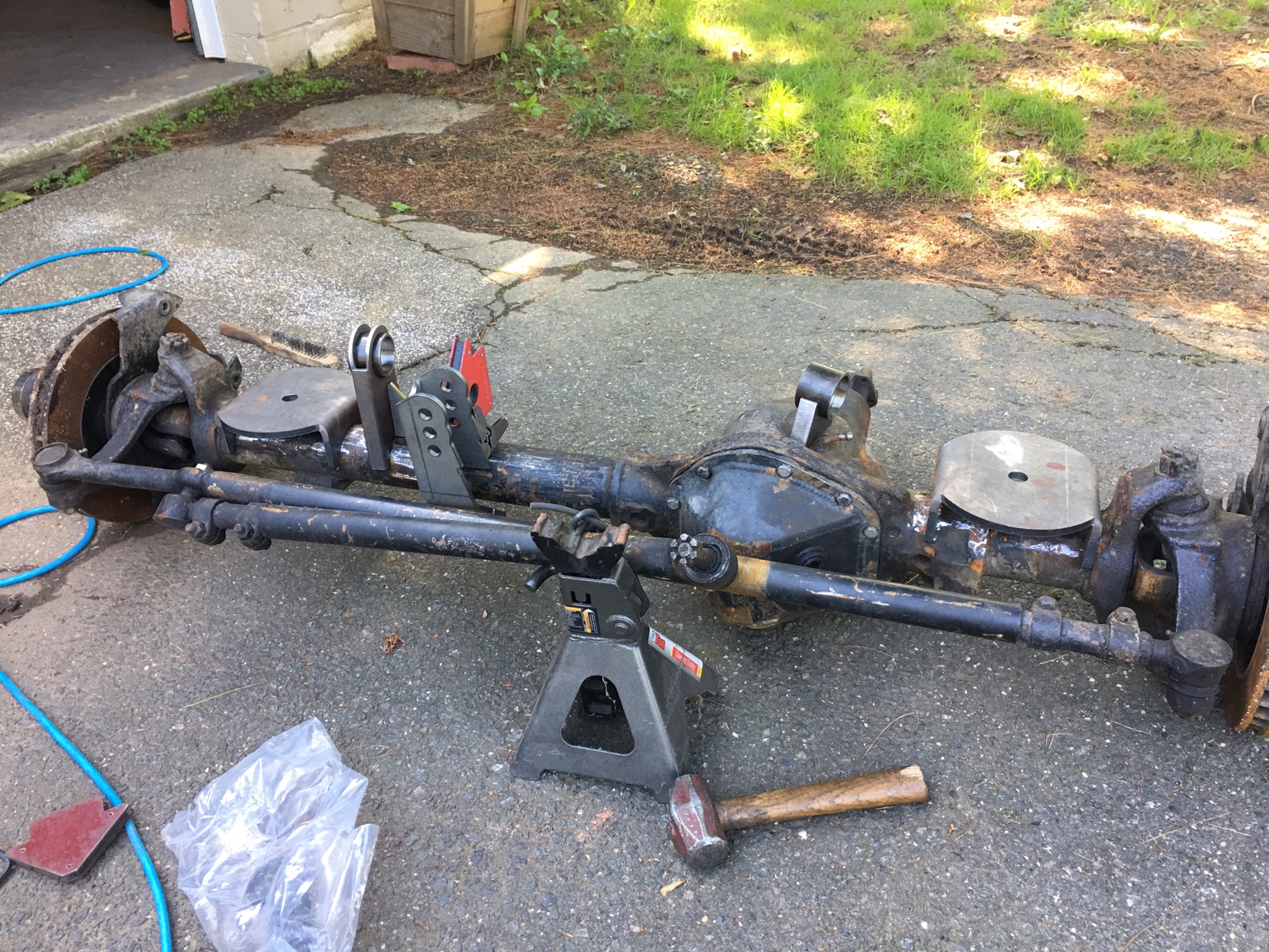

these photos were mocking up the track bar:

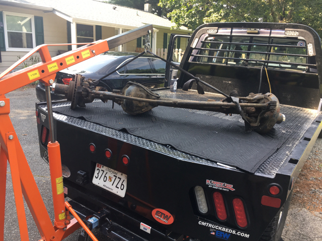

Picked up the GM axle. Got pass side knuckle off and ready to send out for machining. Trying to compile a list of seals I need, and will be throwing in fresh ball joints while I'm in there. Never had a problem with Spicers, but I think I will go Moog for trail use because I can flush the grease as needed. Got steering and tube on order. Will clean up housing some more while waiting on parts man.
