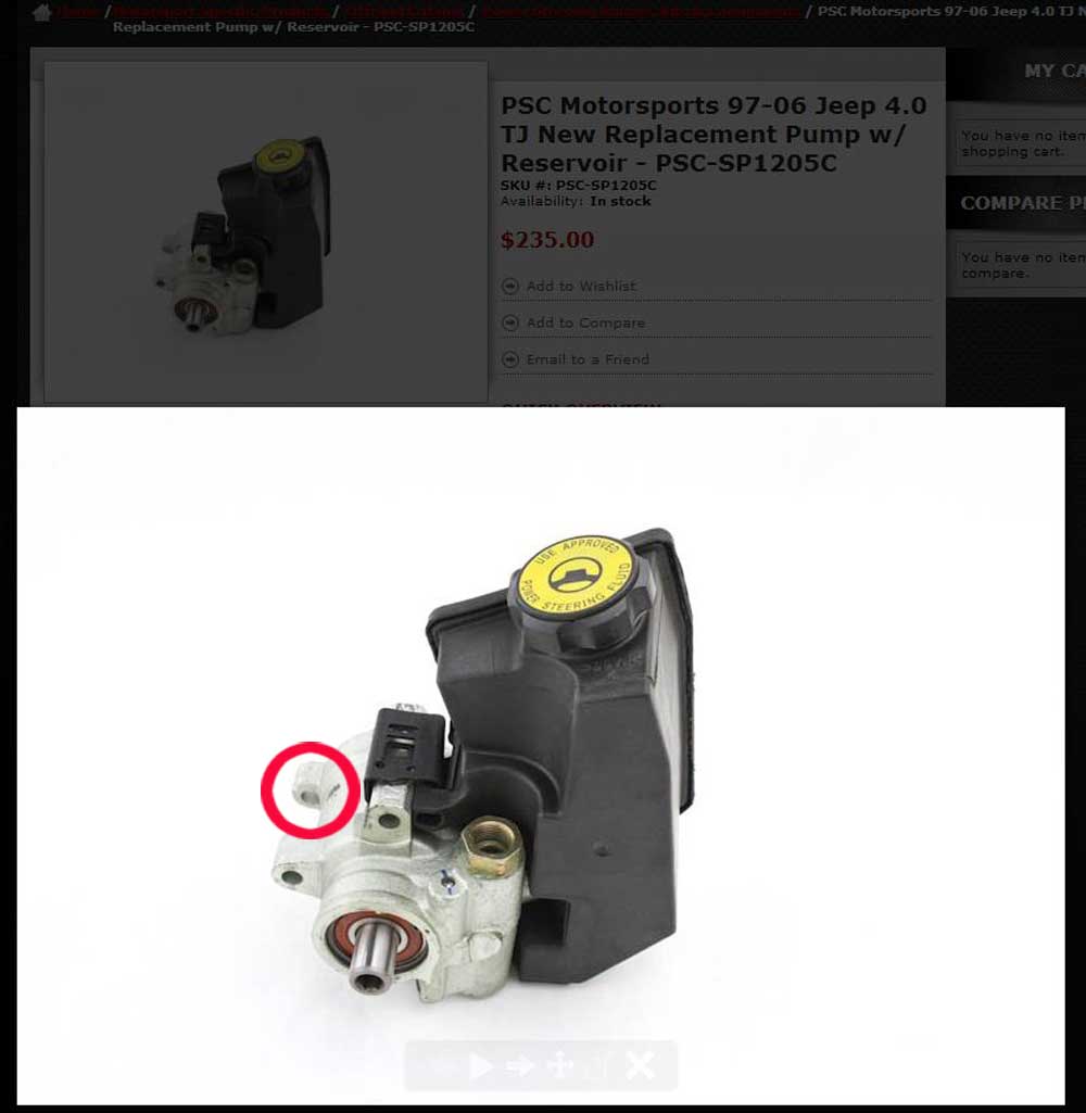

There are a couple of details that would have been nice to know up front. Most importantly, the marketing image of an SP1205C is not an accurate representation of the current product. One of the mounting lugs shown in the image is not present on the pump.
Here is the marketing image, with my red circle added to the relevant lug:

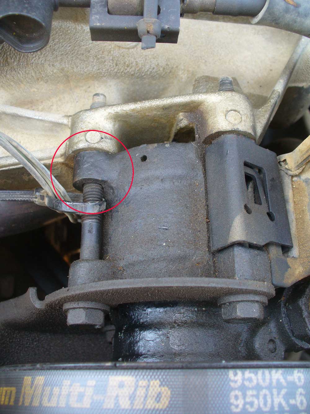

Here is that lug in its application:

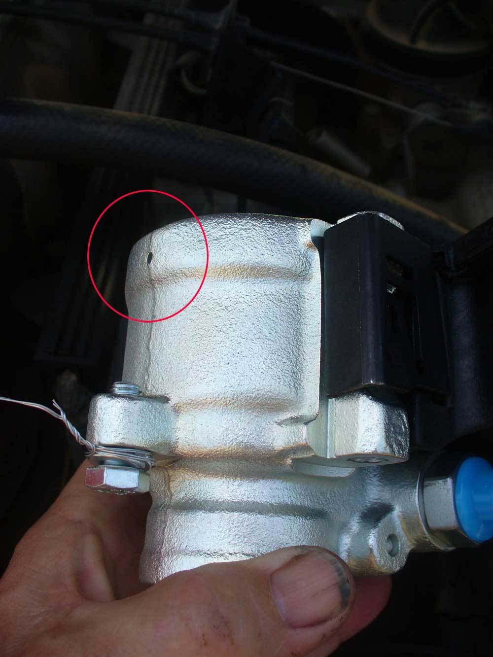

Here is the pump that I received:
I called PSC to find out if I had received a mis-boxed product. No. This is the current production. The foundry that casts these pumps hasn't made the version with that lug in ten years or so. PSC provides the short bolt that is necessary to mount this pump without the one lug. And I am assured it will work just fine.
I still have my reservations. The pump I received appears to be the older style such as is on my '93. That would mean that someone at Chrysler decided the additional lug was needed in '96 (and later). In my mind, if someone persuaded the bean counters that this lug was necessary then they must have had a good reason.
This also tells me why my core is so valuable to someone. I will be hanging onto it to have it rebuilt. I will then move this new pump over to my '93.

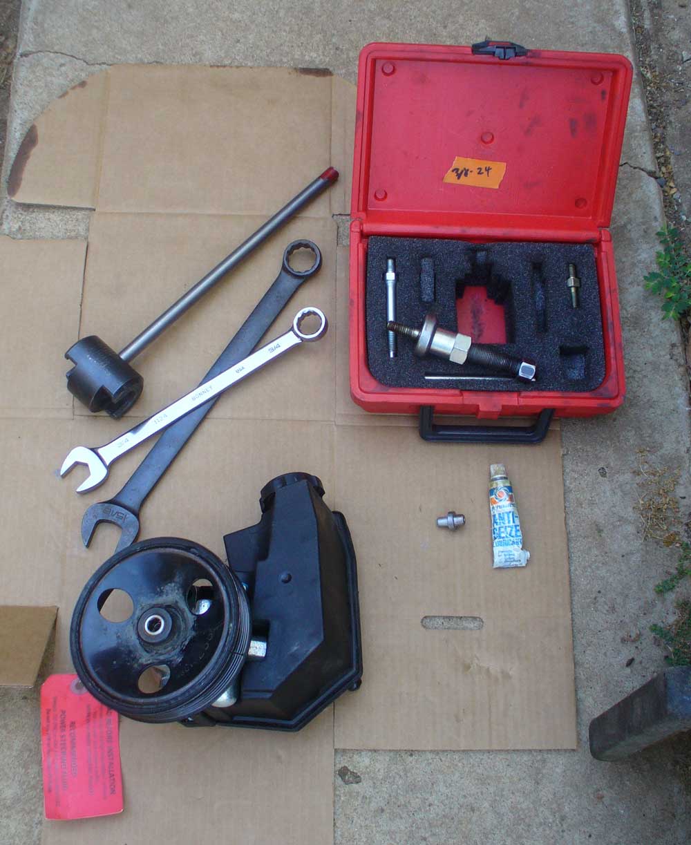

One last note: In looking for information about swapping power steering pumps I came across several comments about pulleys being flimsy and not holding up to pullers. Evidently some folks are not aware that the pullers for power steering pulleys are a unique type. They are not the jaw type. All force is applied at the very center of the pulley, none at the perimeter. Use the right puller (and installer) and there should be no issues with the pulley. The right tool for the job should look something like this:
Note that is in the "install" configuration. The black cylinder with the 1/2" rod sticking out of it is the "puller" part.

I have been running without that missing lug for years.
Just go for it.

I just did this on my 2k. The bolt/lug is no issue and the fluid cross references to "mineral oil" which most power steering fluids are! Yes you need a "clam-shell" puller/installer tool!
