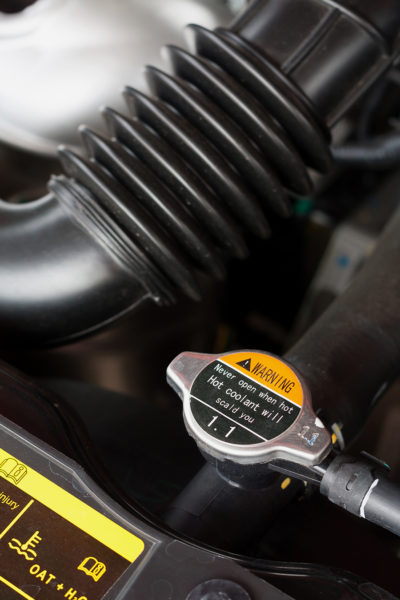

Steam coming from under your carís hood?
Steam coming from under your carís hood? Donít panic! Visit our blog to learn what you should do if your car is overheating.
Read what to do if your car is overheating here: http://tiny.cc/9dc4my
