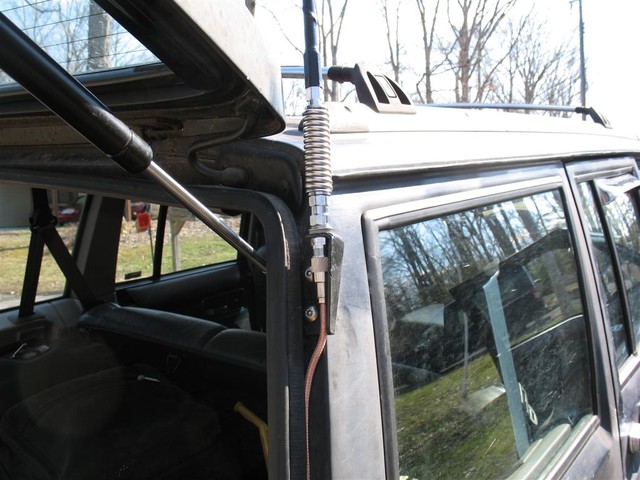

Use your roof as the ground plane. I have my antenna on the D-pillar and am able to get the full frequency coverage, pretty good signal.

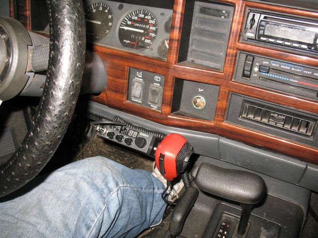

The cab is pretty tight. I mounted on the knee panel but had to use a small Pro 520 XL. Good radio but they are not big enough for all the features you might want (TX gain, weather, etc)
