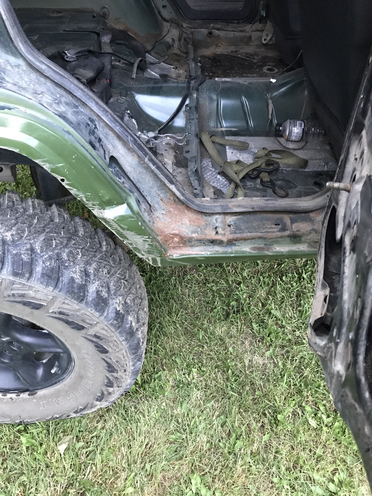

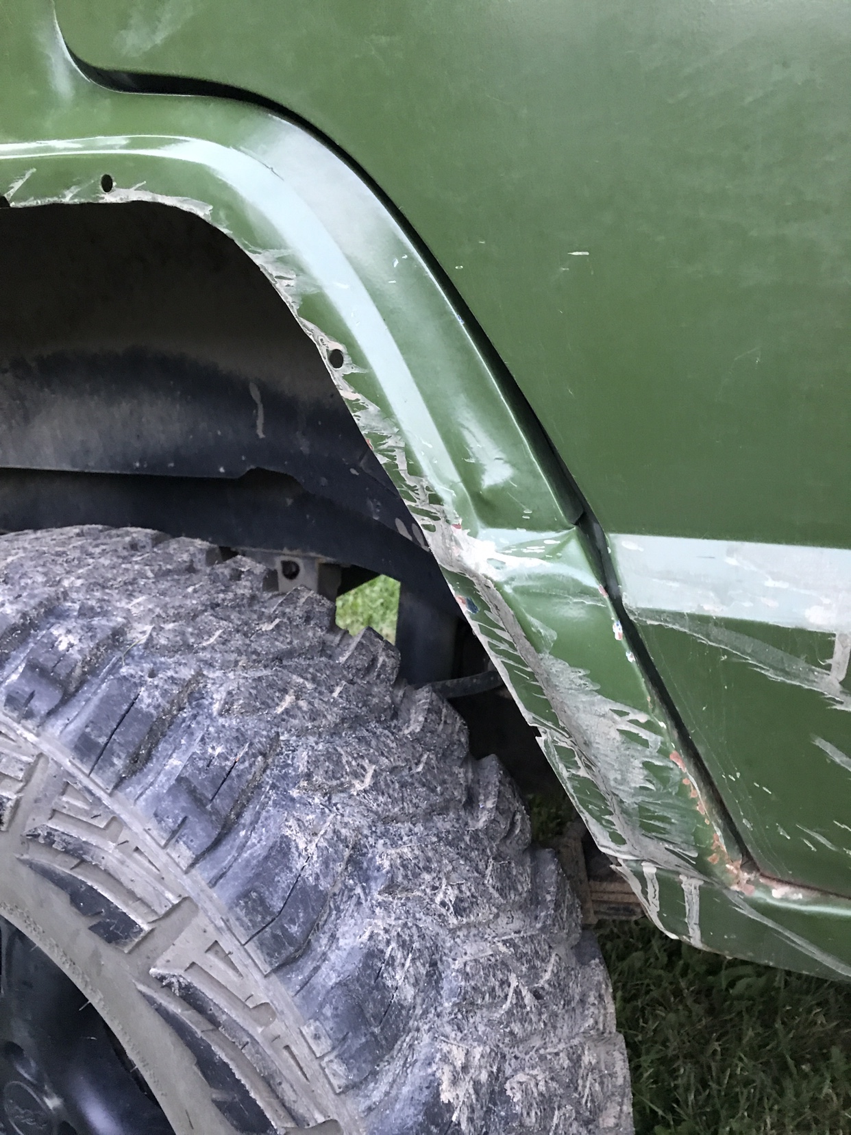

Collision damaged xj and bent unibody
Just wondering if this i should attempt to fix this or not waste my time.... I've had the jeep like this since I bought and and used it as a daily driver for almost a year, just want to build a budget jeep for trails and fun...etc
Not very experienced in auto body or welding but i do have a can-do attitude! 😃

I am also wondering if anyone has any ideas on how to fix this?

Can you fix it, yes!
Will it look good...probably not the greatest.
You can cut out the rockers and put in 2x6, cut and fold the rear fenders then try to smooth out the sheetmetal as much as possible.

Should I try to push out the dent? The rear seat support is kinked in

Think that rear seat support might be something you can buy separately (like floorpans or door skins), or just go to a junkyard, cut that piece out of a wreck, and install in your rig via glue-and-screw.
(edit) forgot - if you splice in a new piece on that side, leave a couple inches of overlap for attaching to the existing one once you cut out the kinked bit...
