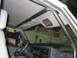

I think the dash bar is kind of high I am going to try and lower it down but there is not much flexibility as I think I have it set were it should be. You can see that there is not a lot of space between the dash on the driver side and the bar.

Will that top spreader bar on the front move down any? I have an overhead console I would rather not lose.

EH I can't edit my original post. As I was working this out in my head (over thinking it) I found this picture:
You don't want to do what I asked as it defeats the purpose. However, I can you move that top bar back a shade as to not hit the computer?

That is the old design the top spreader bar with their new design has two bends in it for more head room and there isn't much flexibility for placement.
