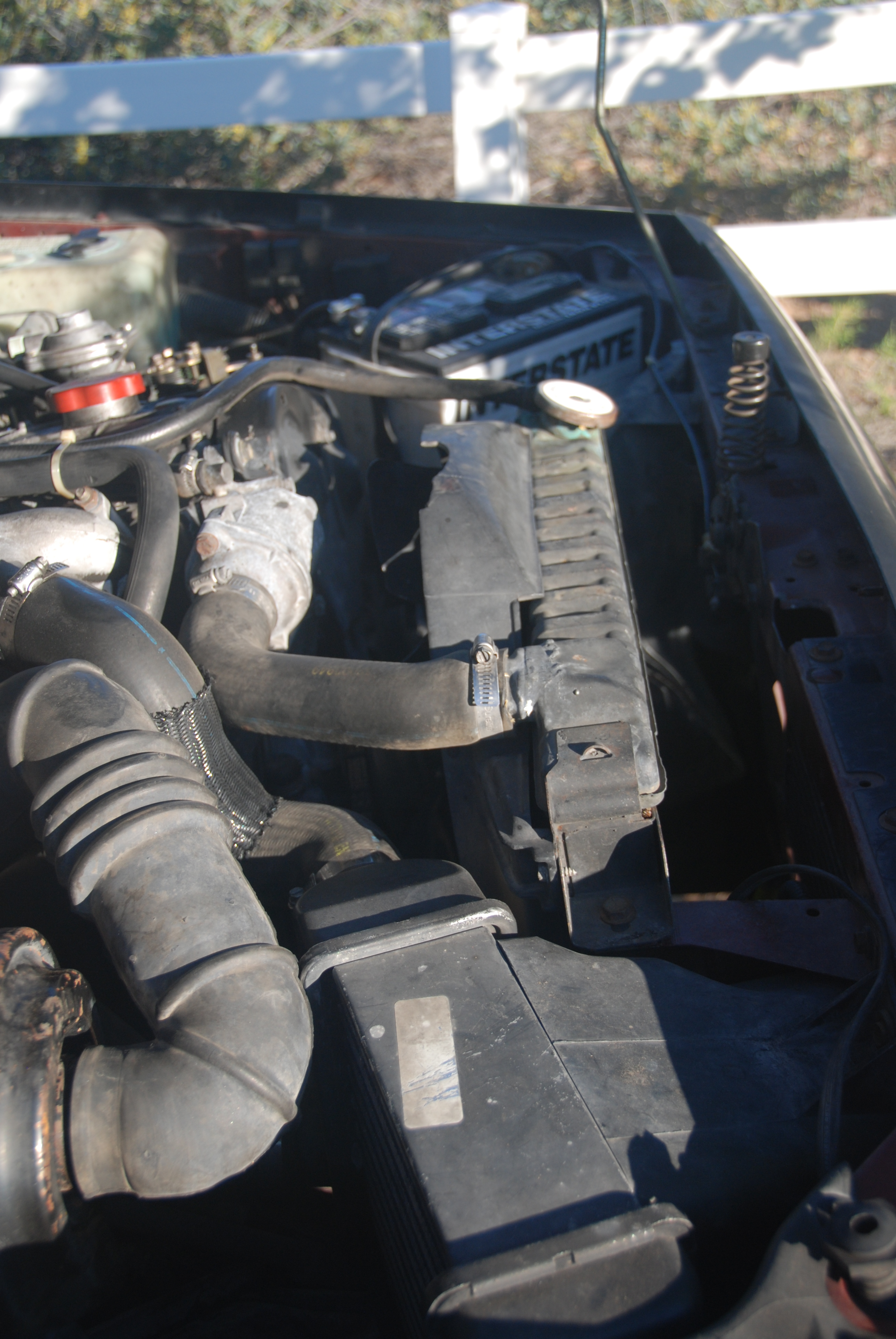

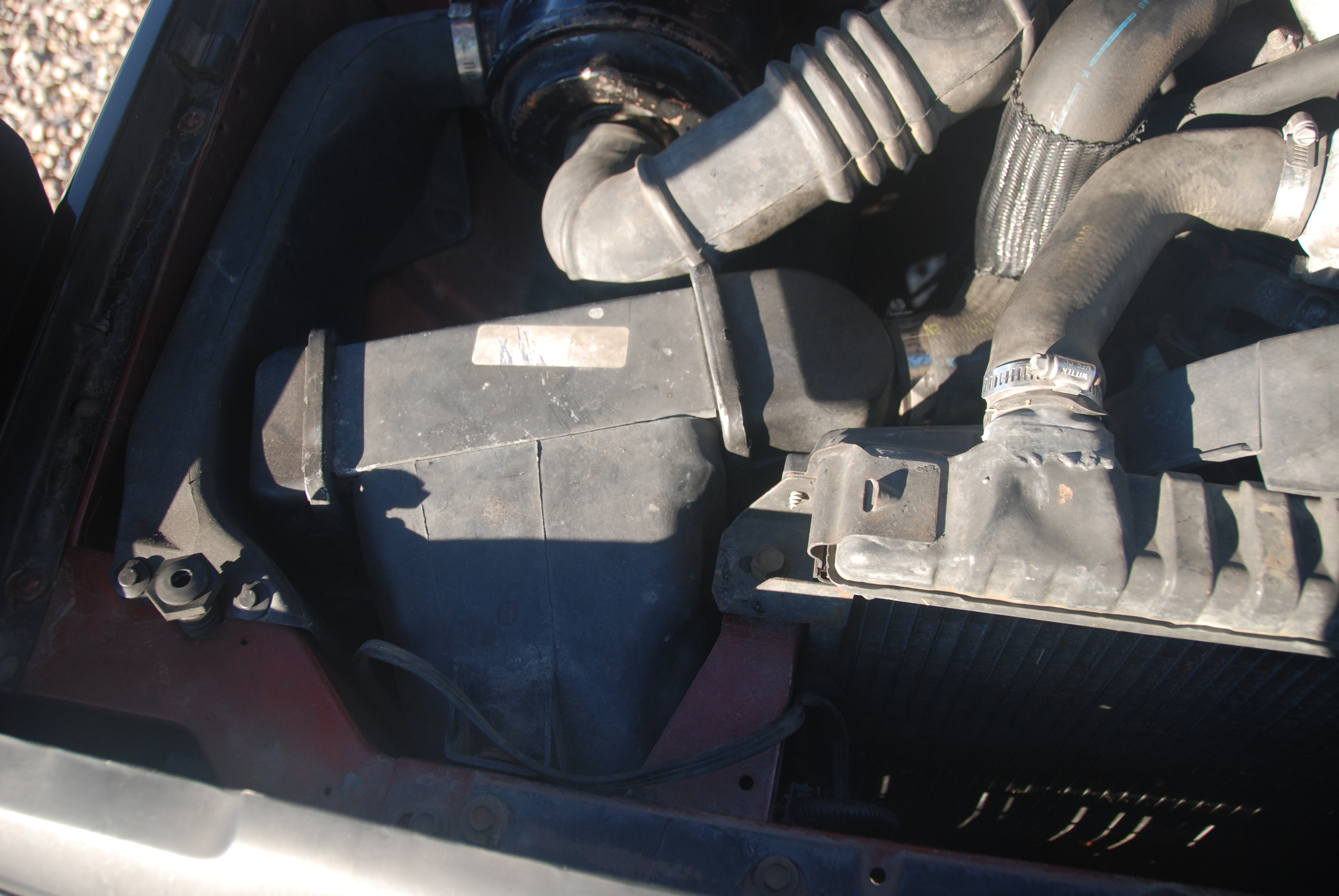

Welcome aboard.
I have a couple of pics which show the relevant details, but my regular computer is in the shop. I have no software with which to resize them.
I will try to post them as they are for the sake of the discussion. The first pic shows the bit of a dog-leg that represents different sheet metal from that with which I am familiar. The second pic shows how the radiator is moved back, closer to the engine. I think it is that dog-leg that is going to drive the difference between what works gracefully and what does not.

This may be the key point for your question:
With the change to the 4.0 engine, the engine bay of the Stage II Jeep XJ was changed in 1987, including small changes to the firewall, inner fenders and most significantly the front clip. This is one of the key facts that individuals who don't care for large levels of pain and expense should consider, and not make the mechanically dangerous assumption that a 4.0L should swap into a Stage I Cherokee. We at Novak have fielded many a sad call from people who have tried it hoping for a much easier conversion, further supporting one of our leading maxims, that "Jeep parts are often the hardest parts to swap into Jeeps."
That is from Novak's site, here: https://www.novak-adapt.com/knowledge/xj_swap.htm
If no one else knows you might try contacting them.
