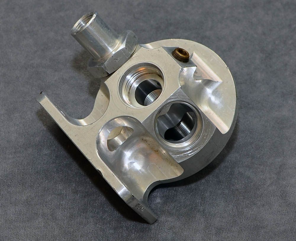

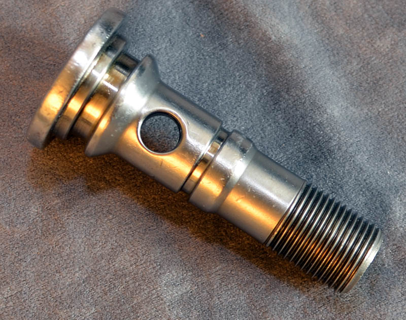

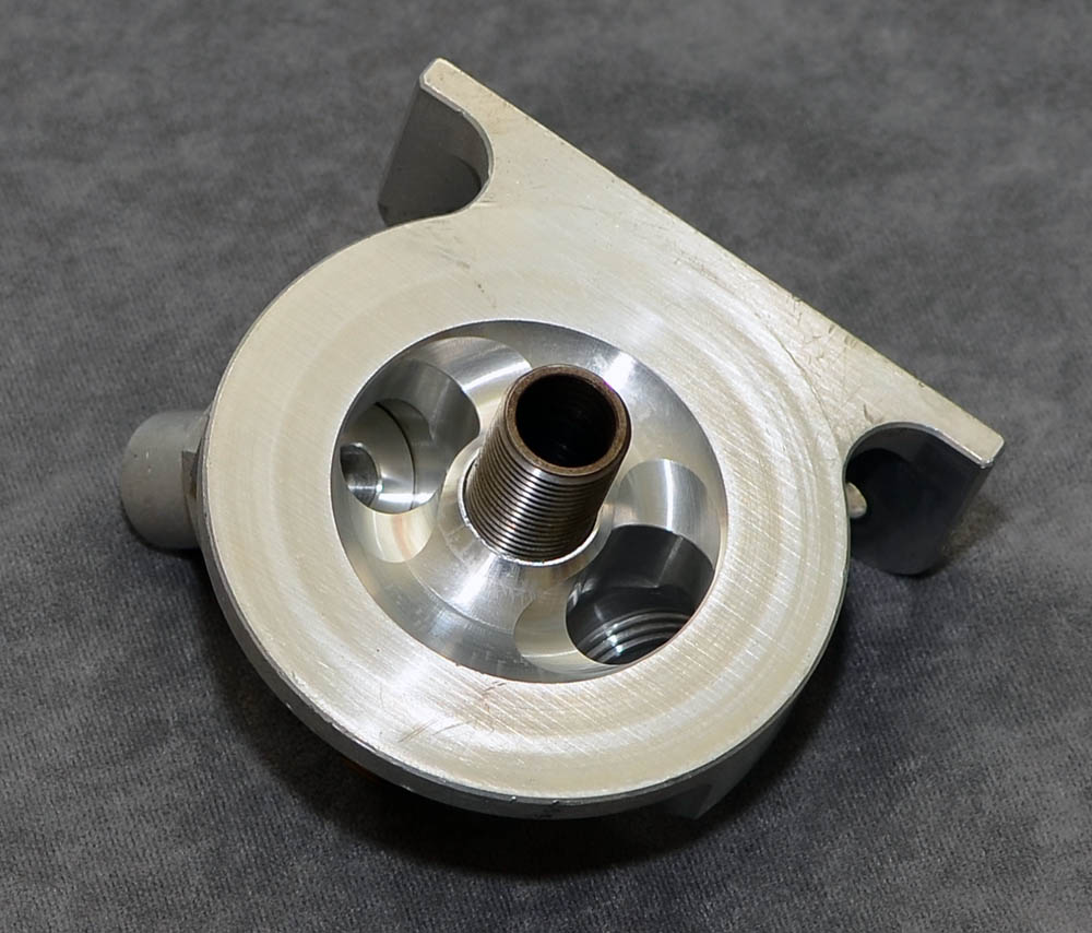

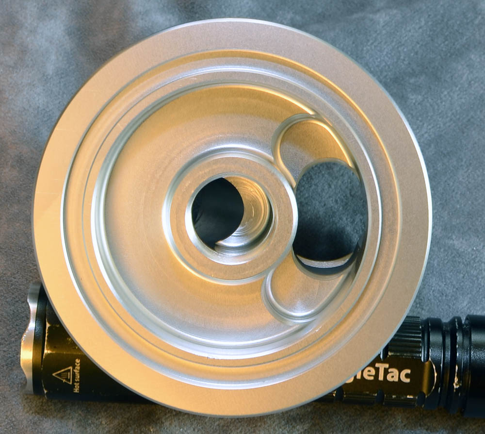

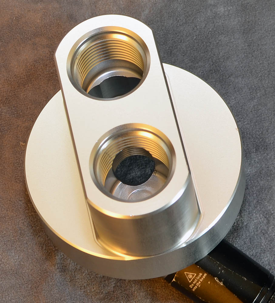

So some pics:

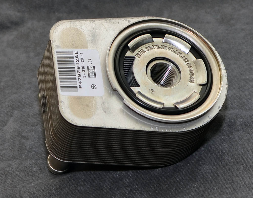

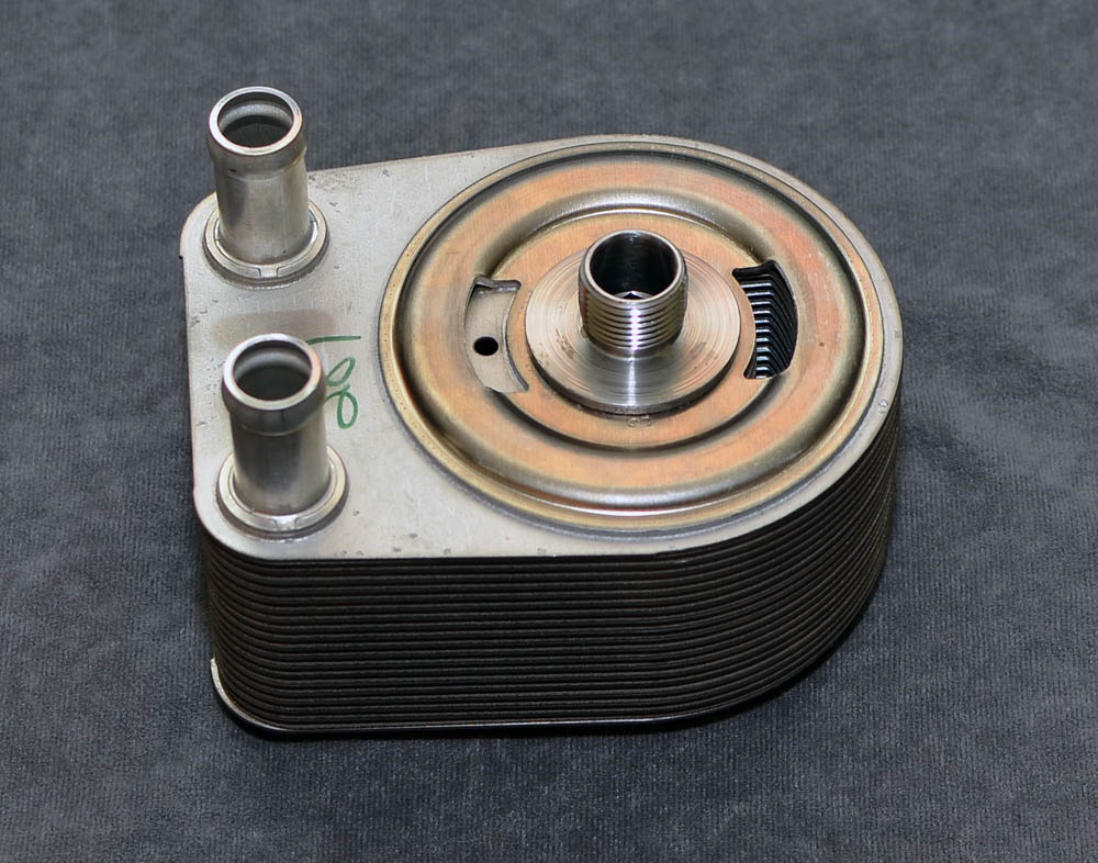

Filter/adapter side of the heat exchanger.
Block side of the heat exchanger:

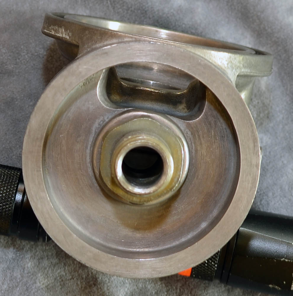

CV745 filter mount:
Hamburger 3320 adapter:

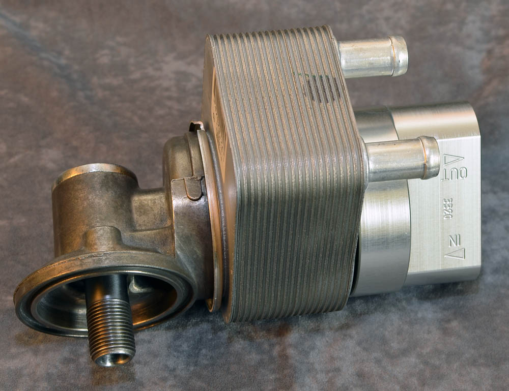

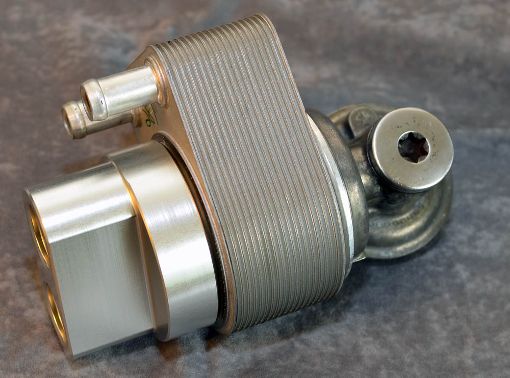

Adapters and heat exchanger together:

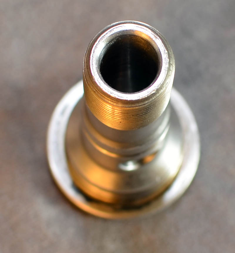

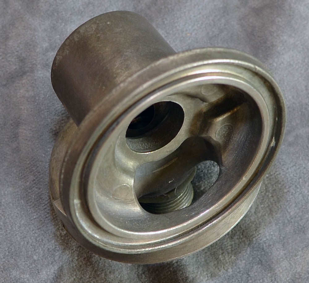

I also took a look at the stock oil passages and felt there could be some improvement. The main oil galley is ~.5" as is the feed passage from the oil filter adapter. The stock oil adapter bolt ID is .38" diameter and the feed holes in it are .317" diameter. I felt that there was some room for improvement here. Keep in mind that the inner diameter is only half the stork as the oil sees the area as well, which is more important. I opened up the bolt's ID from .38 diameter (area of .1134 square inches) to .468" diameter (.172" sq in area). That is roughly a 65% increase in flow area. I also opened up the feed holes in the bolt from .317" (area of .1578 sq in, there are two) to .365" (area of .209 sq in). I also massaged the oil filter adapter a bit, opening up the port as well as smoothing out the rough edges. Even with out the oil cooler/heater and remote filter mount these modifications should show an improvement. If my block was torn down I would have done some internal modifications to the oil pump to block passages as well as the adapter to galley passage. Maybe in the future. The only thing I am concerned about is how the bolt will hold up since so much material was removed. I will be supporting the rear of the filter adapter/heater/stock adapter to reduce stain on the bolt and stock mount.
Pics of the modifications:
It is not finished and installed yet as I need to do a mock up, decide on fittings and hose lengths, work out the coolant flow, order the rest and install it.

I am wondering, could the 90 degree adapter at the block be eliminated if a remote filter were to be used? Have not seen that done.
I believe there is room to replace the stock 90*adapter with just a remote adapter. However, a heat exchanger + adapter won't fit. I did think about this idea for a bit. Decide not to go with it for a few reasons.
1) If you look at the pic below the of the heat exchanger you will see a raised lip on the out side of the seal. That won't mate up to either of the CV filter mounts due to their wide filter flange. The lip would hit the mount before sealing. A different adapter would be needed. I am sure there are ones that would cover that aspect, but a lot of them have other draw backs as well. Namely the angle of the ports coming in. Many of those adapters have ports that enter the mount flat then turn a 90* into the filter. Flow loss there. Also, many of those are cast and I have read that they can leak. Both the adapter and mount were analyzed and selected to avoid both of those problems. Now, machining the mount to fit the exchanger could be an option.
2) Adding the exchanger to the end of the filter mount would mean I would have to either go with a shorter filter or position the mount higher. I would also have been forced to use the 745 mount.
3) Every time the filter is changed there is a chance you will be loosening the through bolt on the exchanger.
Eliminating the stock 90* adapter and just running a remote filter is not a bad idea though.
