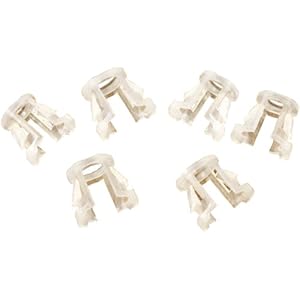

I ended up re-using my clips. They are pretty durable. The ones I got from my local NAPA were wrong. "Dorman 800-016 fuel line clips assorted 5/16 3/8" is what I should have got.
Amazon has them; http://www.amazon.com/Dorman-800-016.../dp/B00066UKGM

Returned my wrong clips from the last visit to NAPA and got the correct ones;
Napa RC3103 5/16"
Napa RC3102 3/8"
