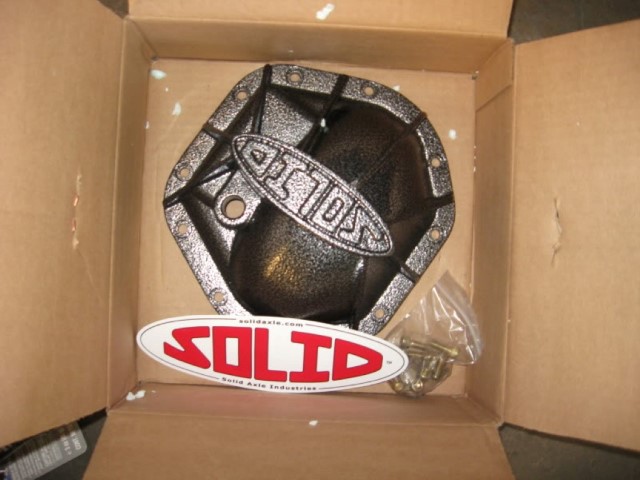

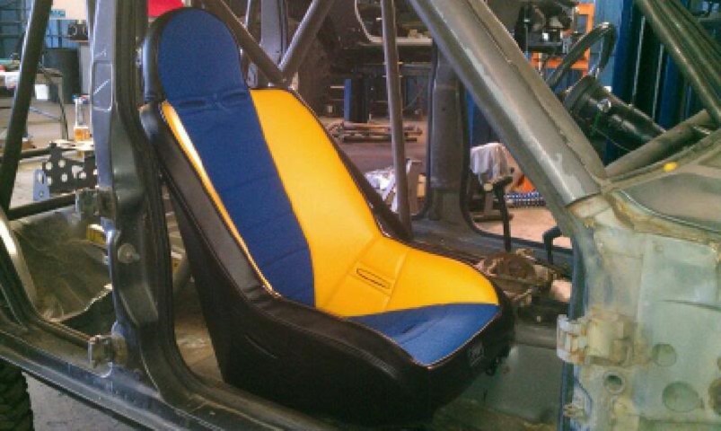

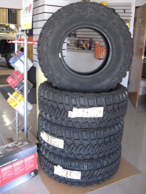

We've been lucky to have lots of help from some great companies. In no particular order, our sponsors:
Goodyear Tire-
SOLID Axle Industries-
Bilstein Shocks-
Hooker Harnesses
Big thanks to Infectious Off-Road Club for donating our custom PRP Seats-
[IMG]www.shadowco.org/~cal/4643/seat2.jpg[/IMG]
Full Traction Suspension-
Warn Winches-
Yukon Gear & Axle-
Brown Dog Motor Mounts
JKS Manufacturing-
Raceline Wheels-
G&G Offroad for physically putting it all together-
More to come, but we wanted to take a moment to acknowledge all those who have helped us, including !
-Matt
