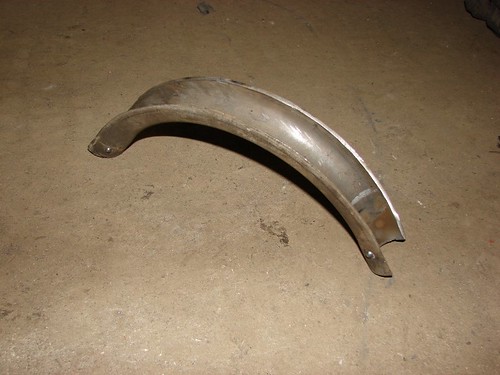

Have a 1.75" die for your bender, and don't want to spend the few hundred bucks for a 1.5" die?
Make a full-length bend out of 1.75 x .120 and cut along the neutral axis...
Now you've got a sleeve to fit over your die and reduce it down to 1.5".
It actually did a pretty good job for bending this 1.5" x .120 shock tower brace...
