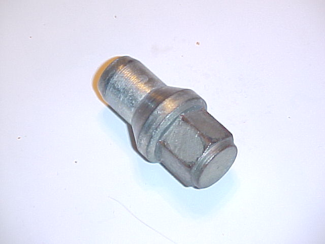

By the looks of it, you are running incorrect lug nuts. Instead of having a bevel at the base, it should have a sleeve that extends into the lug hole on the wheel....sorta like this
I don't use those extended shaft lugs. That would only be necessary if the studs do NOT extend out at least several threads past the wheel. Over-torqued studs that got really HOT from whelling style braking could fail perhaps? COULD be also the lugs are getting tight without actually being snug against the wheel. In otherwords, the stud is bottoming out in the lug.

Something is wrong, those are the wrong nuts for those wheels or the adaptors are missing.
Those wheels use this nut.
Those are the nuts I was looking for, but I posted one of the first images I found that looked similar on google image search. I am at work and didnt have a lot of search time. Notice that I said "sorta" like this?
