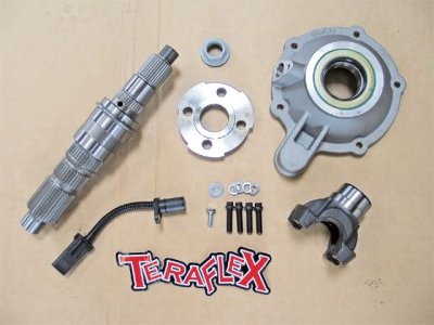

In the process of installing my 2-low, I wanted to determine whether the speedo connector on the Jeep, and the one on the T-case would fit together without any issues. I still had the tailcone removed from the 241, so I walked it over to the Jeep and gave it a go. Nope. No luck. I snapped a few pictures of the different connectors.
T-case:
Jeep:
Well crud. At this point, I was under the impression I was almost done, and the 241 was almost ready to be mated with the transmission. I could cut the two connectors off, and solder the wires together? No, I want to be able to disconnect the two if I have to drop the T-case again.
I started looking around for a simple solution, but not too many presented themselves. By sheer accident, I stumbled upon a fitting on Teraflexís website.
Link to product: http://www.teraflex.biz/products/con...ess-older.html
They make a female connector that works in conjunction with their ESS kit, for later model TJís. By looking at the picture, it appeared as though it would also connect to my 241 as well. Hell, for $13.99, it wasnít going to hurt to try it out.
Fits perfect with the T-case. Nice and snug. Cool, onto the wiring.
The 3 wires on my Jeep are:
Violet/Orange: +5V
Black/Yellow: Sensor Ground
White/Orange: Speed Sensor Signal
Compared to the 3 on the new connector:
Brown: +5V
Blue: Sensor Ground
Black: Speed Sensor Signal
With all my bases covered, the T-case was finally ready to be installed. It went up just fine, a tad heavier than what Iím used to. No issues with fitting into the transmission tunnel, although it does sit very close to the tunnel. I did have an issue with my transmission mount. The plate present between the transmission, and the actual rubber mount has a lip on the edge, and contacts part of the T-case. Quick fix:

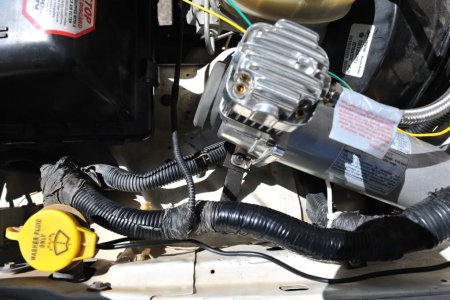

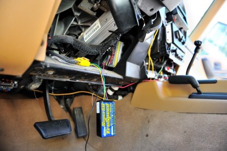

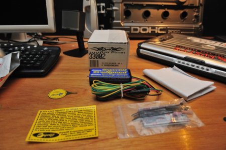

I received my Superlift Truspeed unit a few days ago. I installed the device yesterday, and wanted to provide an update.
Overall, the unit seems decent. From what I can tell, itís a sealed plastic box with 4 wires coming through the side. 4 screws hold the two halves together. I imagine removing the sticker and the 4 screws would void the warranty, so no inside images. Final hit was a little over $200.

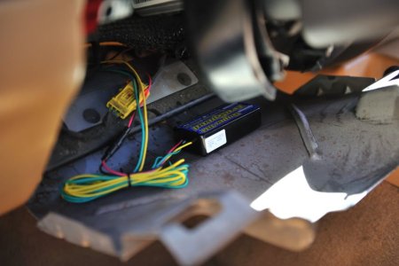

I wanted to mount it somewhere where I could easily access it, I could keep it away from weather, and somewhere close to the front, so I would not have to run additional wiring. I chose to place it inside the panel underneath the steering wheel. This would allow me to mount my + / - somewhere behind the dash. Also, the wire I need to splice into could easily be accessed through the firewall, and into the engine bay.

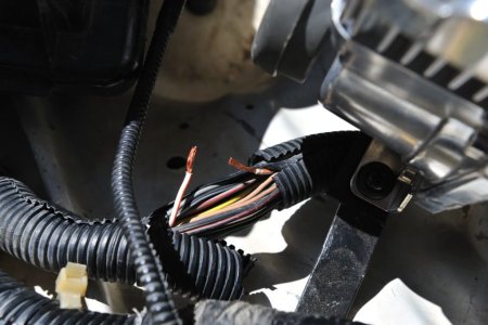

My 1997 XJís wire that runs from the sensor is WT/OR (White with an orange stripe). Knowing this wire routes to the PCM, and comes from the T-case; I was able to find the correct wire loom. You can see it in this image, to the left of my Viair compressor - The medium-sized loom, of the three present, with the split I made in it.
Cut, splice, solder, heat shrink wrap and tuck back in. For those who donít know anything about this unit - the signal routes from the T-case into the Truspeed Recalibrator, out and back into the PCM. The green wire is the input from the sensor, and the yellow is the output to the PCM. Here it is all velcroed, cleaned up and what not.
Itís really easy to adjust. I was able to determine my speedometer reading incorrectly by 15%. A quick few turns with the adjustment screw and it was back to normal. GPS and vehicle with correct speedometer reading comparisons prove my Jeep is now accurate.
