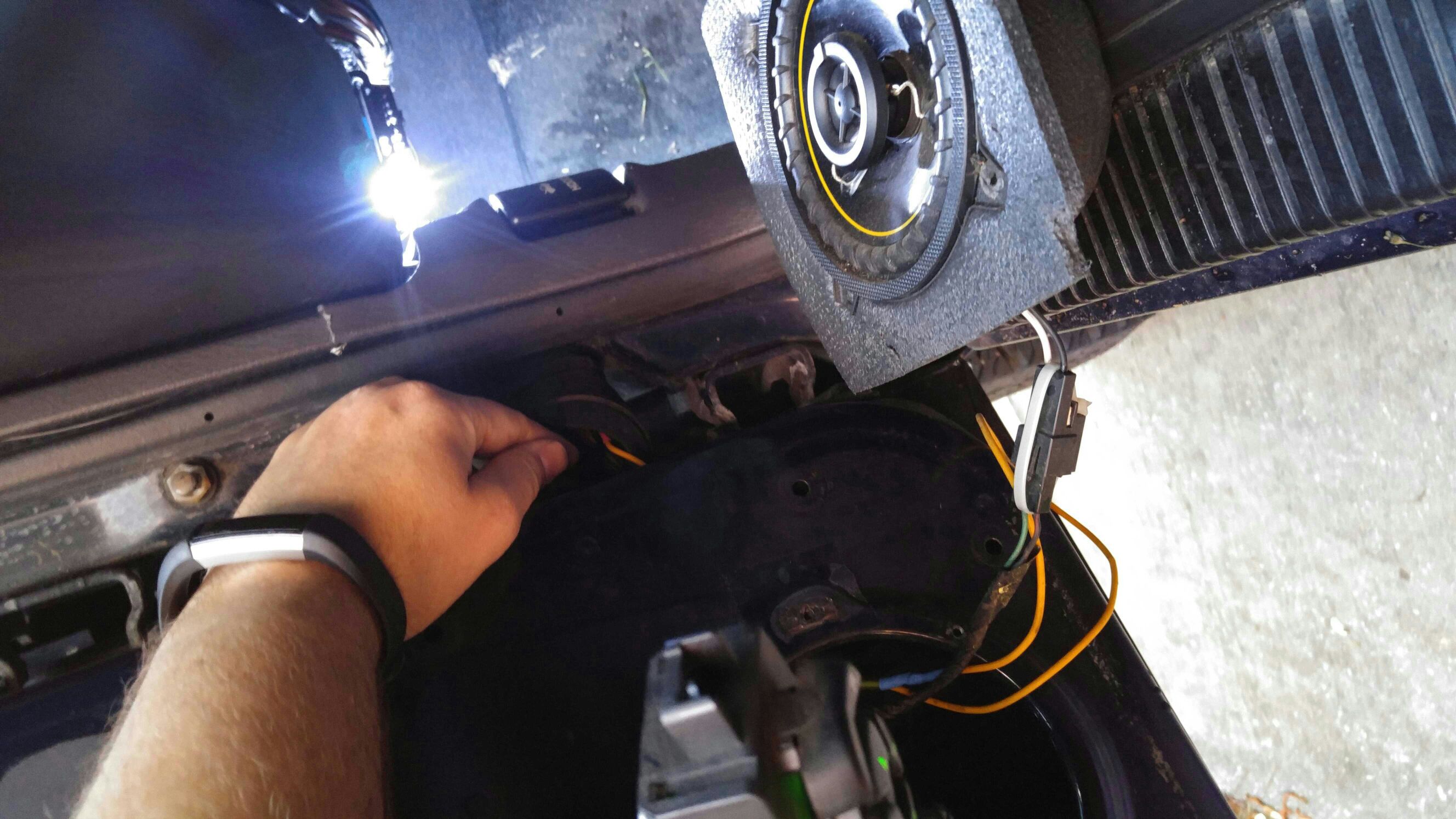

There are NO broken/chafed wires in any of the door jambs, and I followed them through the kick panel as well, nothing. The only issues I found was when I wiggled the speaker side harness (Crutchfield) at the radio that the drivers speaker would cut out. I bent the pins slightly, and that solved that issue.

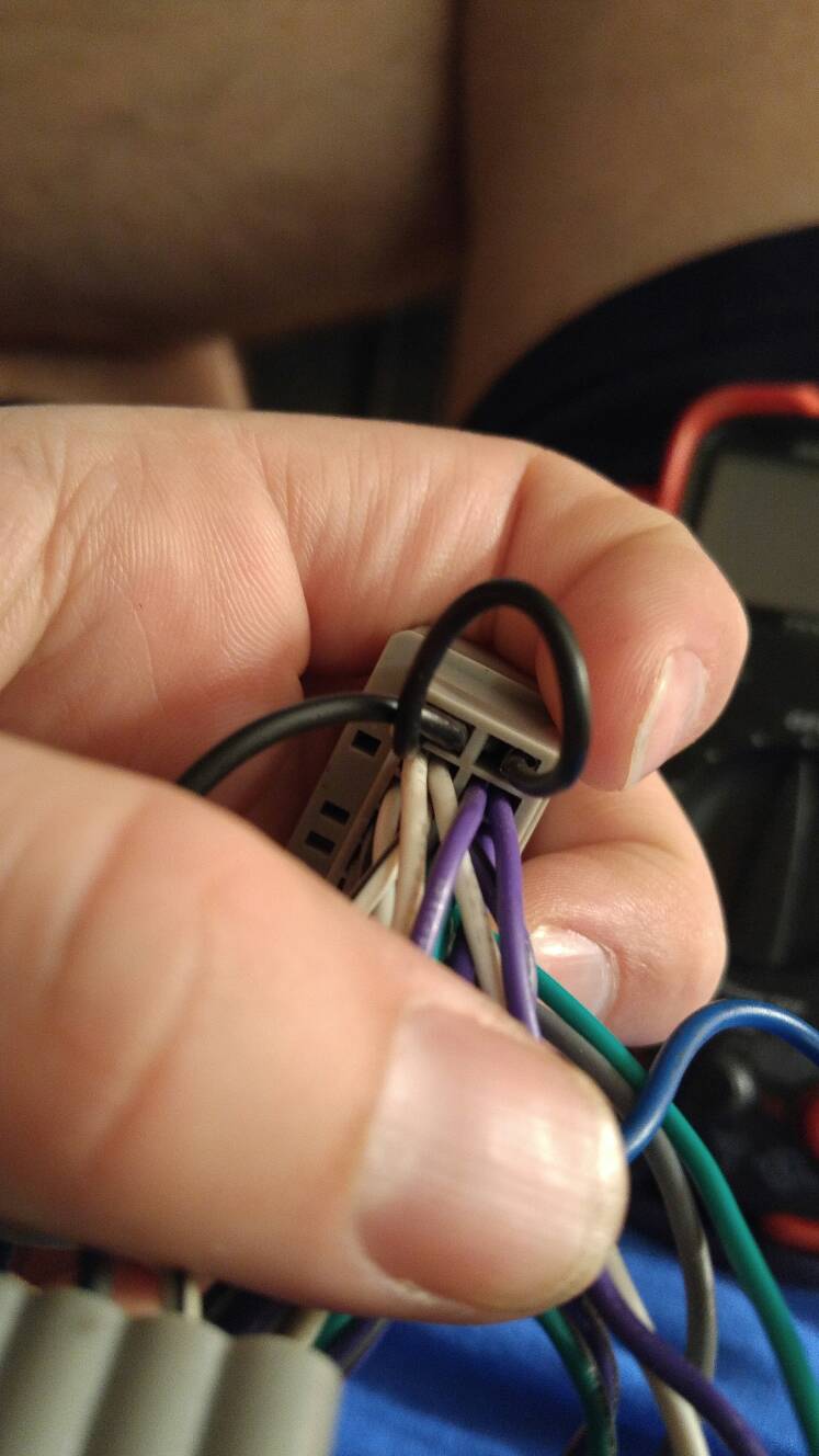

Tonight's plan is to get out and pull apart everything to test with the multimeter, and toss in the original radio to test. I did pull the Crutchfield harness, and as I look at it, I don't see where the ground from the radio connects to anything. Black Wire to the left in from the radio, loops over to the other side, then nothing! It's not modified or damaged in any way, so...

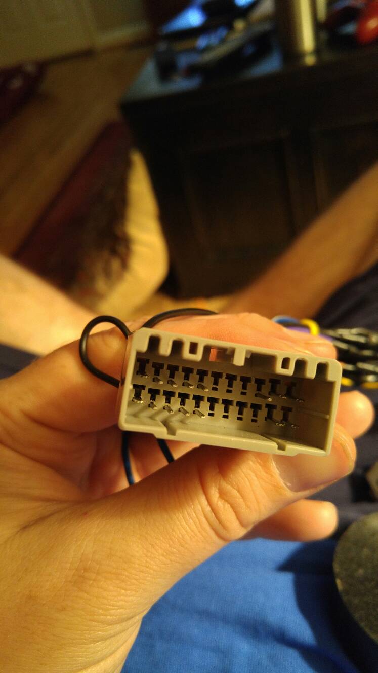

Here is the other side, with the cap opened up. The pins do not connect to anything.

I have installed the Pioneer radio on the 16th, but this time hooked up the unused ground from the factory harness to the dead loop of the Crutchfield harness. Can't believe I didn't notice the lack of ground almost 3 years ago when I installed.
