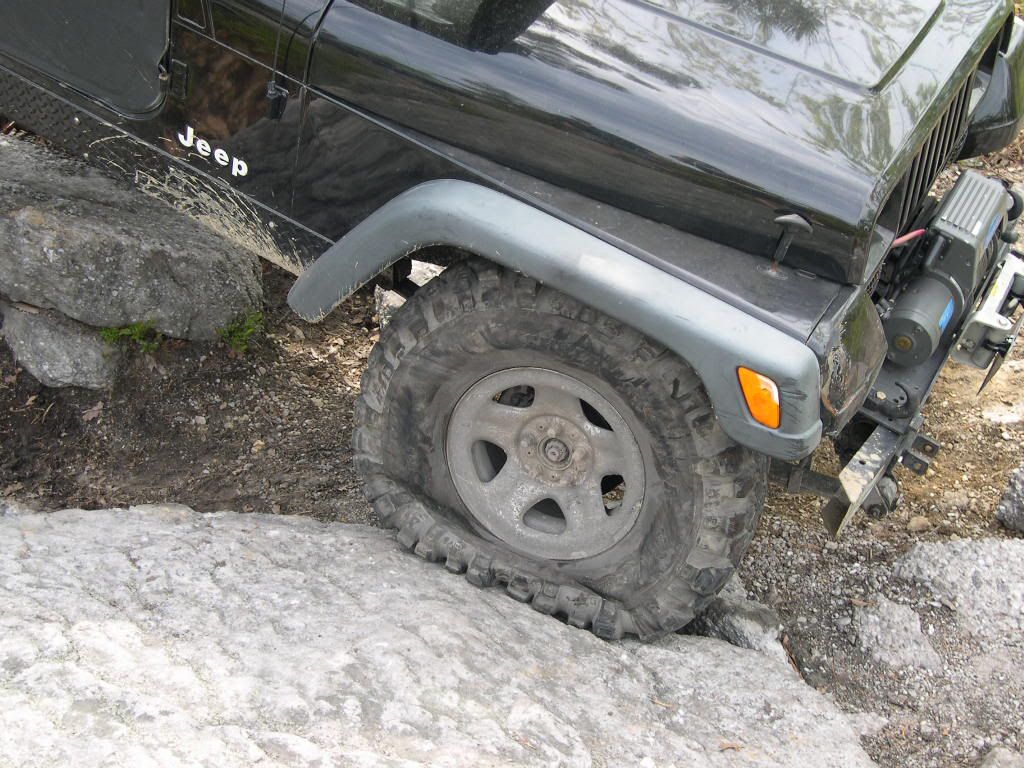

yeah, if he wants to lose his beads all the time on the trail
I have 34 10.50s on AR 15-8s,
run 8 to 12 lbs of air and have only
knocked a bead off once in 4 yrs of
wheeling and
I've been all over tellico,
but actually blew the bead at beasley knob.
Just my 2cts
wheeling and
Just my 2cts
thanks. what i was looking for. figured i would run what i have for now and see how it works. purely trail tire so no big deal, might try the screw beadlock thing.
