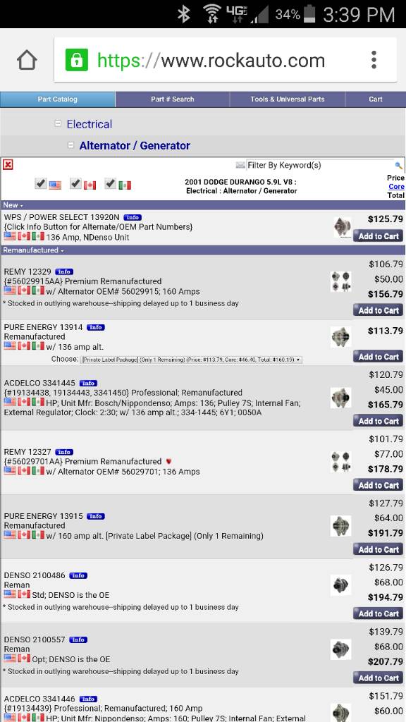

Well it was time for a new alternator, so I started looking at options. First thought was just the 137A from the ZJ, but I didn't like needing to rewire anything to match the terminals on the back of the alternator. When I looked at the Durango version, the plugs matched my 99, so that made it a better option. Added bonus is that the Durango 137A was about $40 cheaper than the ZJ version, and the 160A was only about $5 more than the 137A. So, 160A it was.
