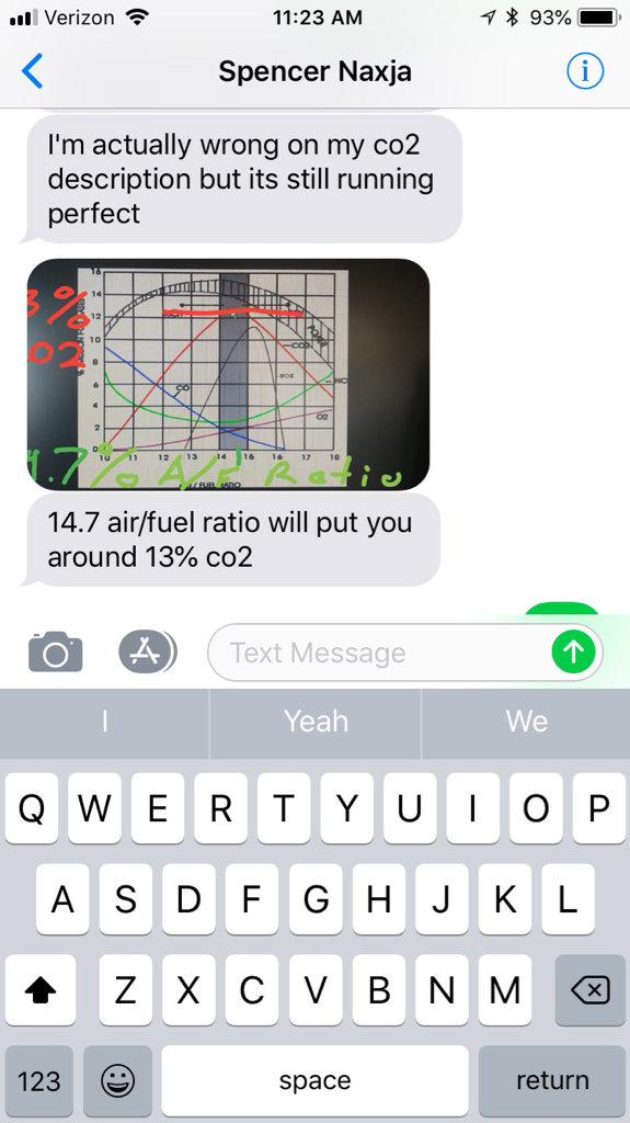

EDIT: I think we had a tech misinterpret C02 for CO on the tail pipe readings. We originally thought the tail pipe was rich (He interpreted 13% CO2 as 13% CO) when in fact it is about dead right for 14.7 with 13% co2.
