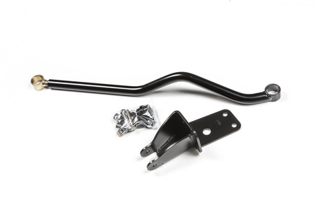

Are you using the axle end adapter drop bracket supplied by IRO?
