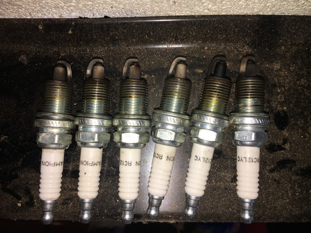

What did the spark plugs look like? Picture? Intake valve sticking? Collapsed lifter? I would pull the valve cover and whack the valve stems with a hammer. Inspect for bent push rods, etc.

Here is a picture of the spark plugs. Cylinder 1 is on the right. They follow order from there. I'm about to pull valve cover off to see what I see.
Plugs are out and about the same price as a valve cover gasket.New champion plugs set the gap and try again :dunno:

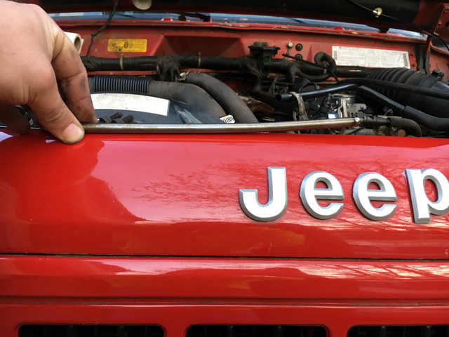

Ouchie!! Was it like that when you took the vc off?
Yup. Took a picture before I pulled it out. It's bad when you don't need to loosen the rocker to get the pushrods out. There are a couple other rockers loose. I'm going to pull all rockers and pushrods out tomorrow to inspect. I'll run a straightedge across the valves and see if I can manually push down the valves. Then I'll go from there.
If all seems well, I'm going to replace the pushrods and carry on. The rockers all have oil on them still, so, they have been getting oil on the top end.
That would certainly explain your good leak down test and no compression -- On cylinder 2 that should be an intake valve -- If it doesn't open, no air gets in to compress

#2 plug was darker than the rest indicating a problem, now obvious in that cylinder.

Excessive lash can bend a push rod. Once that push rod leaves it's seat, bad things happen.
Excessive pressure can bend a push rod. Maybe you have a problem with clearances, maybe your exhaust valve does not open like it should (Nevermind how I learned that!).
Leave your plugs out, crank the engine and watch how far the rockers move.
Yeah, it's pretty obvious now why your compression test failed. Perhaps the plunger spring collapsed/broke, or some debris/sludge prevents the lifter from preloading.
Excessive gap can cause the pushrod to unseat from the rocker. When the cam pushes it upward, it rides up along the outside of the rocker, bending it.
Before, it probably freed up once it pumped up and got warm. The rod end stayed in the rocker. The last time it slipped out.
