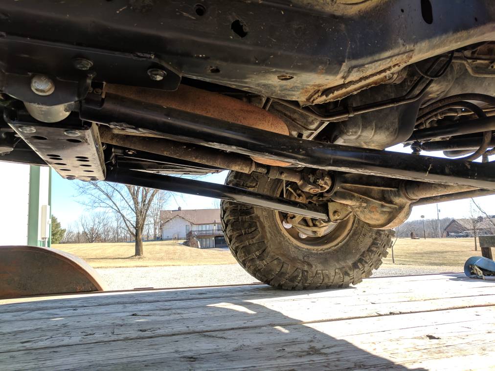

I replaced my Cavfab alpha kit with iron rocks rock link. Much stronger. There are some quirks with the rock link that I'm not fond of, but it's minor details as once you have it setup they don't matter. The upper link has to be bolted to the crossmember before you install the crossmember because of clearance issues. Changing the caster is a pain in the ass. You have to let the axle droop, or lift the body up enough to rotate the upper. Lower it back down then check it again.
All that being said, the rock link is the superior 3 link on the market. I had my Cavfab kit for 8 months or so. And bent a lower arm. Then the guy I sold it to just bent an upper.
