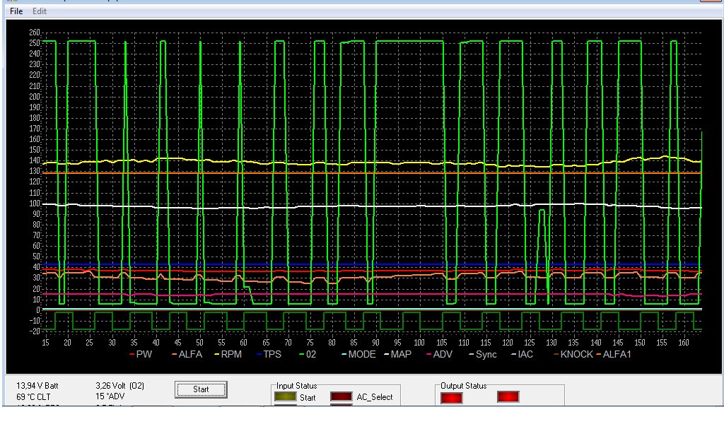

I'm using the RenixCom.exe software on my Renix XJ 4.0 1989.
Could you please share me the whole window?
I want to cross-check your values (CTS, IAC, TPS, PW...) with mine.

im not sure about the last picture with the o2 circled but the renix cherokee has a 0-5v swing on the O2 and thats normal.
but your alternator looks like its bad if your batt voltage is 5 volts.
Yes,
I put the voltmeter on the O2 heater wiring (with O2 connected) and I'm able to read 12V fixed (at Idle).
So, Heating element is powered.
It's strange that the BATT voltage is below 5V (4.38V).
I remember in the past that my alternator fails and I changed the alternator electronic board.
However, battery voltage is 12.70V.
Do you think that my alternator is providing 5V instead of 12V?
If yes, the overall voltage remains 12V....
If I'm not wrong, 12V engine off, and 14V during engine run (idle)
yes it should be close to 14v running. the battery voltage the ecu sees is only when the fuel pump is active. it could be a bad wire or grounding issue. im not 100% sure but the ecu might use that information to compensate fuel mixtures and spark duration.
Right.
Injectors are PWM driven, so, the battery voltage is taken into account in order
to have right injectors timings.
From my side it's strange the 5V reading on the battery...

Nonsense, the Injectors are either fully open or closed. I know they can open with 9 V from a 9V battery.
Where and when are you reading 5 Volts? The ECU supplies 5 Volts to the O2 sensor on Renix, and the O2 sensor is a variable resistor. Resistance varies based on O2 concentration gradient between Exhaust O2 concentration and the external O2 concentration.
12 volts is plenty for the O2 heater.
If the ECU is trying to maintain the idle and closed loop, and there is a fuel pressure or IAC-idle air or vacuum leak issue, the ECU may be switching to open loop at idle?
The PWM only controls the open time. The injectors fully open if there is enough voltage to open the solenoids.
the voltage reading may change the dwell time on the ignition coil. so it could be slowly burning out the coil by charging it longer than needed.
