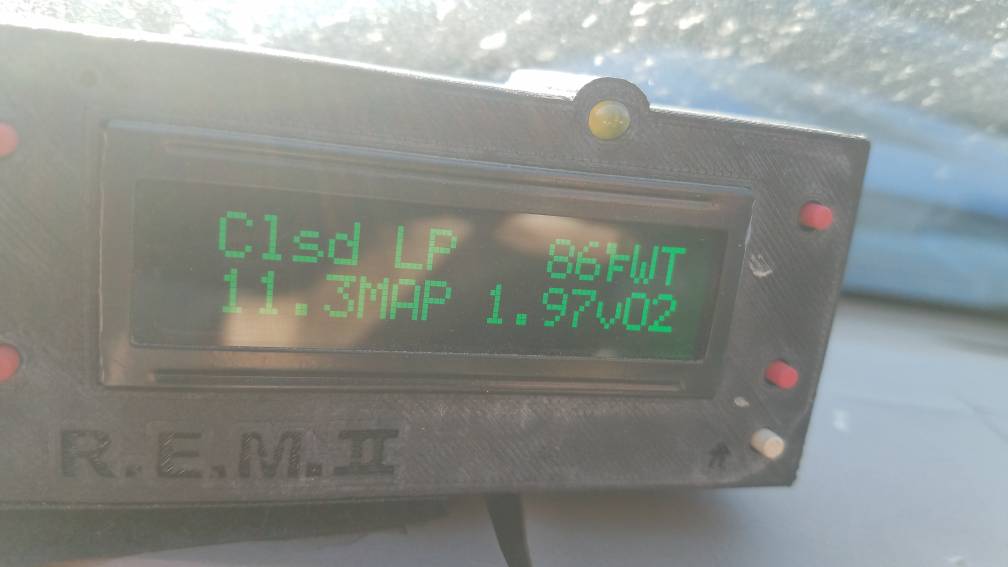

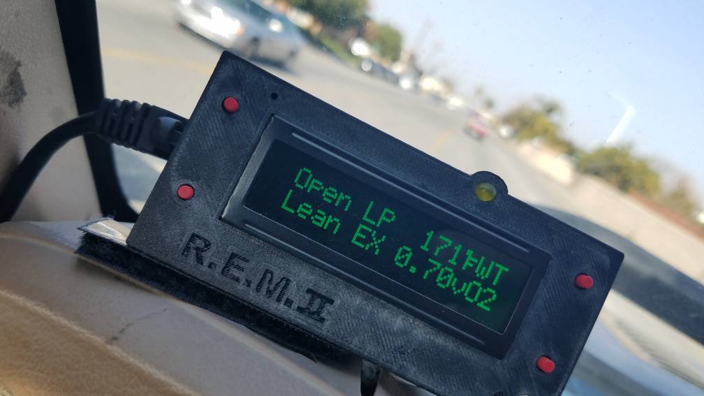

It only just started, do I don't think the cat will be affected. It also does not stay that high. It does range, just not as fast as closed loop. When it goes closed loop, it'll switch from lean to rich pretty quickly. The block temp sender is pretty inline with the reading I get from the head and thermostat. Runs right at 195.
It does seem that it works right the first time I start it, than the rest of the day it's not right.

The REM2 Shows the map and TPS... but I'm not sure what values are normal. The TPS reading changes when I press and release the gas. Outside of that... I dunno.

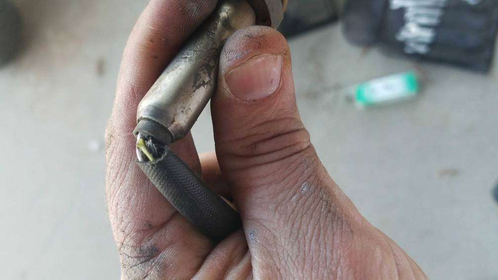

New o2 seems to have done the trick. Apparently my trans line and the o2 sensor want to occupy the same space.
