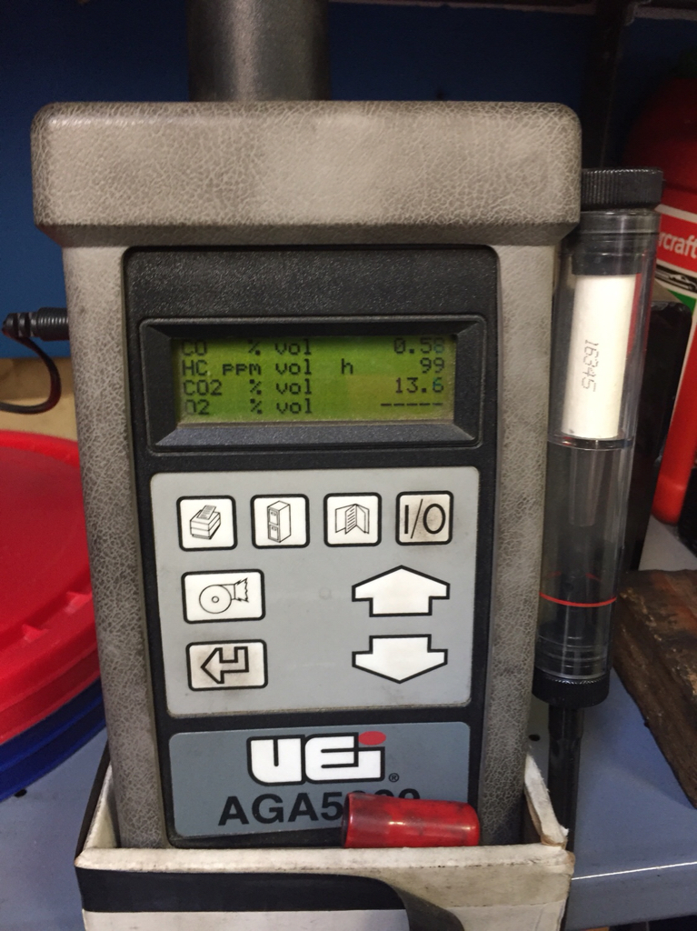

EDIT: I think we had a tech misinterpret C02 for CO on the tail pipe readings. We originally thought the tail pipe was rich (He interpreted 13% CO2 as 13% CO) when in fact it is about dead right for 14.7 with 13% co2.

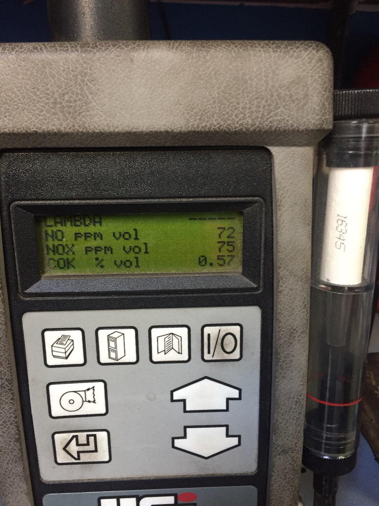

exhaust is reading super highly rich out the tail pipe
Oil seems to be getting in the gas
wideband will be reading slightly stoich to lean when exhaust is reading 13% fuel which should be closer to 1-2%.
The exhaust reads super incredibly rich when we hook up my buddies tail pipe probe, but the wideband is reading lean and it appears the PCM is dumping alot of fuel.
Ive fixed exhaust leaks, but if I had them why would tail pipe read super rich and downpipes wideband read lean ?

no I have a AEM wideband, and we used a tail pipe sniffer yesterday to check for fuel in the exhaust . the sniffer has one of many outputs that is %unbrunt fuel, and my buddy said that value is normally 1-2%, and mine was 13% . the wideband at that point was between 14.2-14.5, slightly rich but very close to stoic

I just talked to a tech buddy at a dealership and he said that the other tech misinterpreted the 13.4% on the sniffer at my other buddies shop. he said the 13.4% co2 is just fine to slightly rich at best. not horribly rich. so maybe the wideband is slightly off, but even then tail pipe readings might differ from a downpipes wideband by a little so maybe not.
