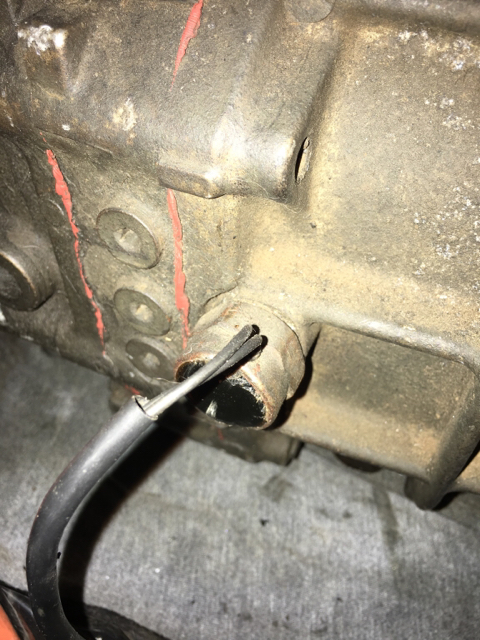

Sounds like you've got it all in hand, only thing I've read about was extending the wire for speedometer and then there the reverse lights and NSS bypass
Only thing I can't figure out is if the 2wd harness has a plug for the indicator light. I've seen people who never could get the light to work and others who seem to indicate everything works after there conversion.

The indicator on the dash is switched on via a ground signal from the t-case. The wiring is all there as well as switched ignition power. All you have to do is run a wire for the ground to the t-case switch (I can get you which color wire at the left hand instrument harness plug that you need to tie into).
