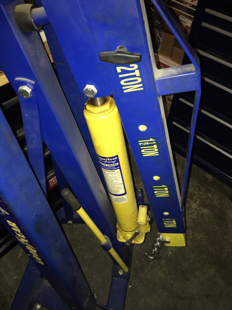

Not sure what hoists are out there, years ago I got a Goodyear branded (not sure who really made it) hoist from sams club with adjustable boom. Plus the legs fold up for storage.
i have had a 50/50 chance with them. the heavier stuff seems to be well put together. and i don't plan on being under it at anytime.
Honestly harbor freight is selling a lot of the same stuff as the auto parts stores. It all comes from China .
But I am extra cautious about buying anything from harbor freight, but usually their tools and heavy duty stuff looks the same as the hardware store and parts houses, not that I would buy an electric drill or air compressor from them.
The 2 ton crane you picture is sold by at least a dozen different brands. I've had mine for over 10 years and love it. The biggest thing I would change with it is to put a large knob on the release valve instead of using the slotted pump handle.
Mine has a lever for the release, which I liked until last January when I bumped it trying to pull a motor out and away from the engine bay.
Nothing bad happened just a oh shit! moment.
I think my jacked got caught on the lever and when I step back it snagged. Luckily I'm so familiar with that hoist no time was lost shutting the valve.
But when lowering the engine in that lever is priceless.
