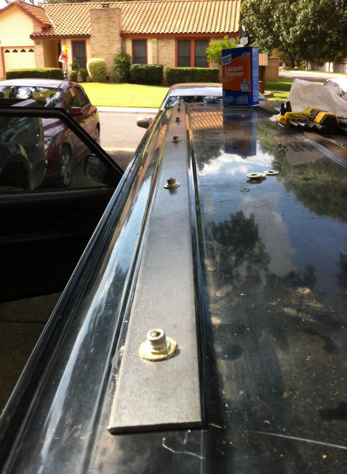

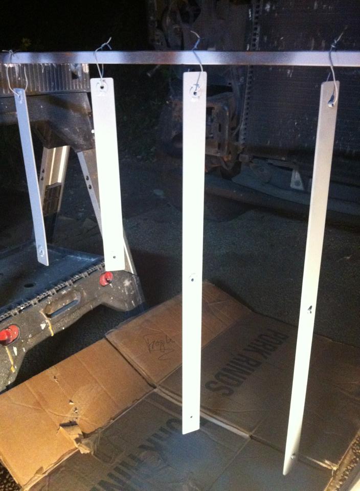

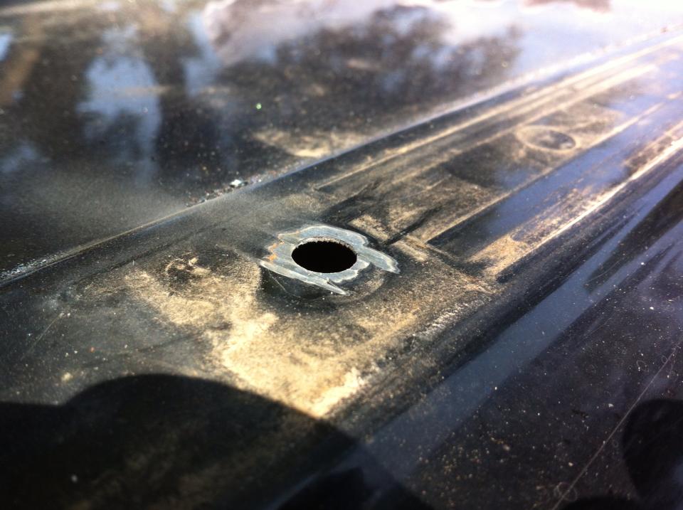

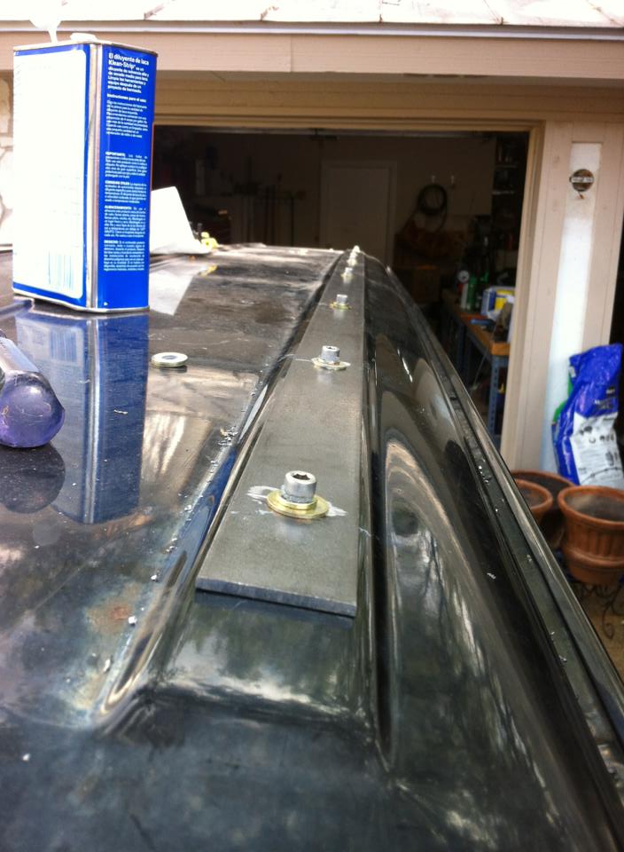

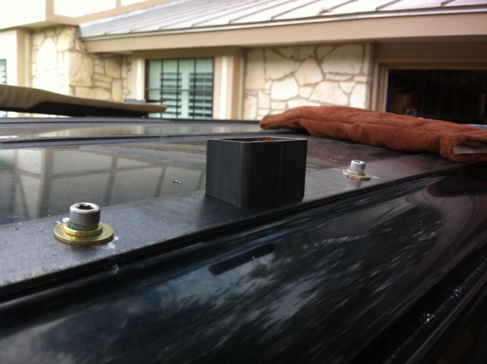

This weekend, I finally started building the roof rack I've been envisioning... But thus far, only the mounting system is done. Basically 1.5" x 0.125" steel strap with 1/4-20 weld nuts internally, and an identical strap on the roof that will serve as the base of the rack.

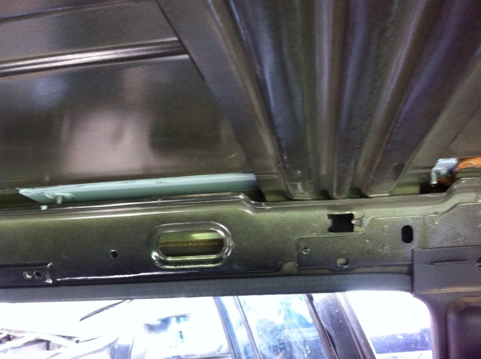

This rack will incorporate tree sliders (1.25" 11ga DOM), so I'm also considering tying the rack into the two centermost "ribs" on the roof via similar means directly over/straddling the stamped roof crossmembers inside the vehicle. Once in place, I'd strip the crossmember at a couple points (fore/aft edges) and punch it up against the strap, and then spot weld it for good measure. Again, still not 100% on this, but it has definitely come up in my brains.
Anyway, pics:

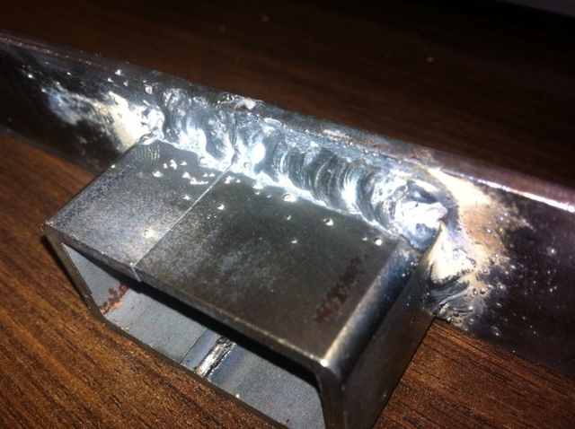

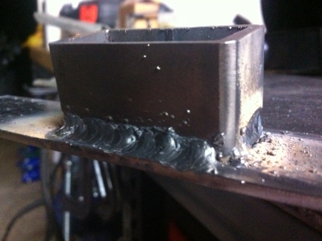

I'll post more pics as progress is made, but the current task is practicing welding the 1" x 2" x 0.125" box tube (foot/standoff material) to the strap using my little Lincoln Weldpak 100 HD... Penetration isn't *quite* what I want yet, but I should have that worked out by this evening.

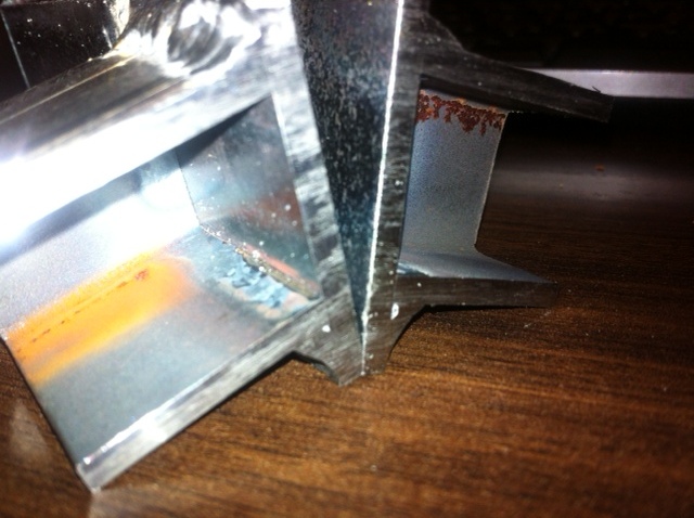

Oh yeah, and a few pics of my best practice weld just before heading to bed (welding the mitered piece above to a 1/8" strap scrap):
Penetration is about 85% of what I want it to be, so I'm going to play with beveling and pre-heating the pieces with a torch tonight. That was the final weld before going to bed last night, after a barbecue and nearly a 12-pack, so I think I'm finally getting the hang of this crappy little Lincoln Weldpak 100 HD.

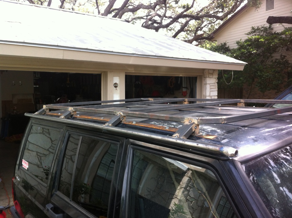

I tack welded all of my rack in place. It will warp on you when you weld it up off the jeep and unbolted. A donor roof would have been nice for this project.
Oh without a doubt. The weld above was on some scrap. I'm going to get the main feet and halo welded together on the vehicle itself (core structure), then all the 3/4" pieces (fence, floor, etc) off the vehicle.

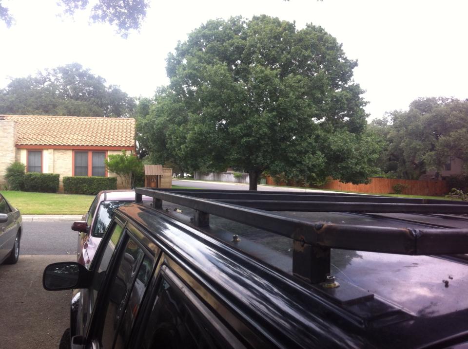

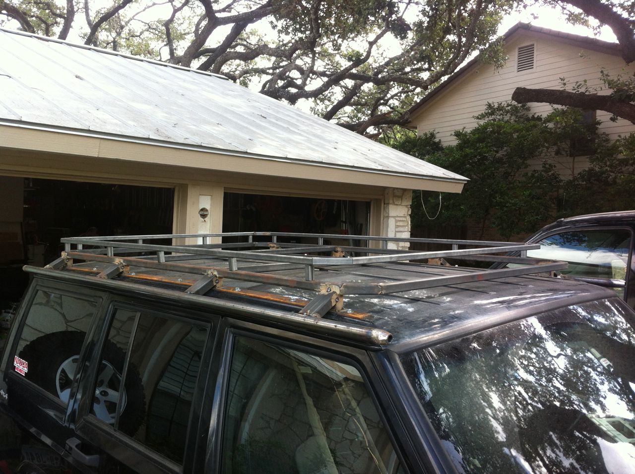

Halo 50% welded and feet tacked on, mocked up on top of the XJ for tweaking:
My dumb ass didn't think about distortion from heat, so upon welding the inner/outer seams on all of them (1/8" welded to 14ga), I ended up with about 6mm of deflection from the roof on the inner two feet. Goddammit.
The plan at this point is to ratchet the thing down for tacking, and go ahead build the sliders. Once tacked on, I'll weld the fore/aft seams first (like I did before) to keep the whole thing true, then focus on welding the feet to the roof strips (again, fore/aft welds first). I was hoping to avoid an upper fence for a while and see how I like a completely flat rack, but I'm beginning to think it'd be wise as it'd help keep the thing true. On this rack, it'll only be ~2/3 fenced (open front) in the end.

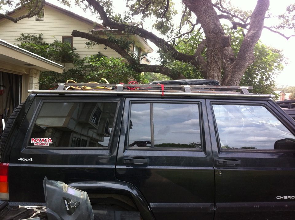

No major updates (busy couple of weeks), but progress was made today:
Hoping to have the driver side rail cleaned up and tacked on this evening as well. As a bonus, I'd like to start the upper fence, but I don't think I've made up my mind regarding what I want.

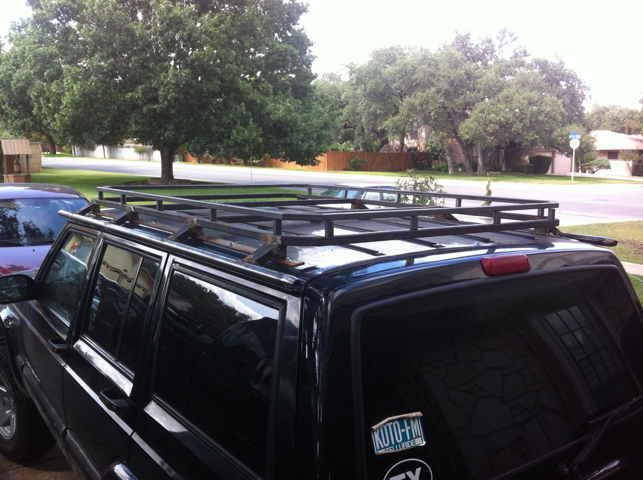

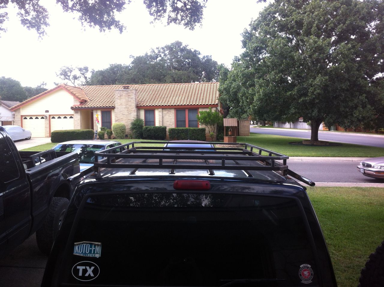

Minor update - upper fence cut/tacked and mocked up in these pics (it has since been fully aligned and tacked on):
Total weight using a bathroom scale thus far is 69.8 lbs (eek).
The only remaining things to do are lights and flooring, the latter of which I haven't decided on.
Does this seem heavy for a rack this size?

Very nice work!
My roof sliders weigh in at 55# but I do not have the "rack" portion. When I need a rack I use a Yakima Basket Case attached to the last two cross runners with large zip ties. The Basket Case is limited space but it also only weighs in at less than 20#. I do nopt have any interior in the back of my jeep past the front seats so I have plenty of inside storage.
Very nice work!
Thanks man, much appreciated! I'm surprised how well it's coming together, but starting to see how I should've done things differently. This is by far the most complex thing I've ever attempted to fabricate. The weight figure makes me feel a lot better too - I had no idea what to expect in the end.

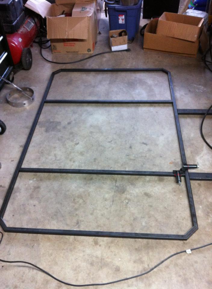

When it comes to flooring, I'm torn between installing 5 longitudinal runners in each section, or 3 runners with expanded steel on top.
Anyone have any tips on the pros/cons of each? I've never owned a roof rack like this (only OEM "racks"), so I have yet to see the practical benefits of either option. I'm thinking tube runners only for the sake of allowing odd-sized items to stick through the rack, as well as to allow things to be bungeed/strapped anywhere on the rack (instead of only on the sides).
Thoughts?

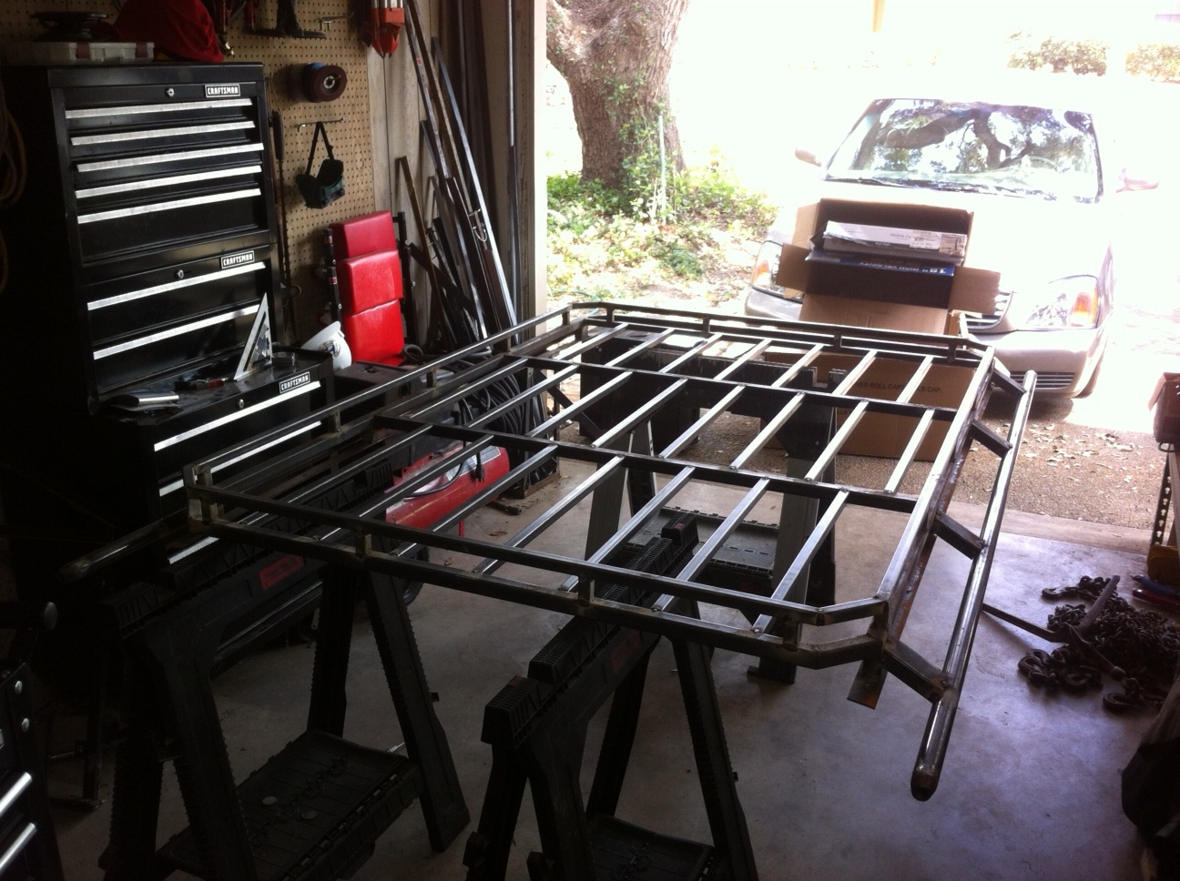

Progress pic:
By the end of the evening, I finished all the welding and got about 15% of the cleanup work done with the flap disc. Seems like I'm gonna need to order a palette of these 36-grit bastards to finish this.
Flooring sections were offset like that to prevent too many continuous lines - I knew this thing wasn't going to be perfectly true, so I figured I'd add some flair to help absorb imperfection. Learned a hell of a lot of this build.
