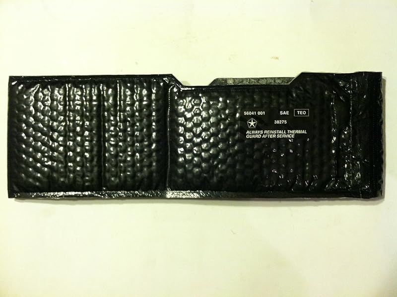

I just checked my Factory Parts List and could not find an entry for a heat shield. So one has to wonder if it had been fitted by a previous owner. Leastways, for '97 to '01 there wasn't a factory shield.
I use a private battery supply house here as they always have the best prices and stand behind all of the products they sell. The battery installed is a Deka Batteries Intimidator AGM. They are made in Pennsylvania. Good American Quality!
I'm pretty certain that the sleeve was factory. I bought the jeep in 2001, so it was only three years old. It also looked like a factory part.
Factory part number is 56041 001. Plus the various iterations after that. See link below for 56041 001AD.
55176 267 .COVER, Battery Diesel Engine - Engine: EN0
56041 001 .COVER, Battery Gasoline Engine - Engine: EP0, ER0
55176 267 .COVER, Battery - Engine: EN0
56041 001AB .COVER, Battery - Engine: EP0, ER0
55176 267 COVER, Battery, Diesel Engine - Engine: EN0
Buy it here:
http://www.jeep4x4center.com/battery...6041001ad.html
