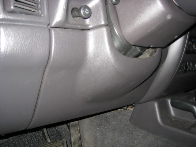

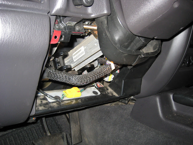

Re: Installing a ZJ/XJ overhead console:

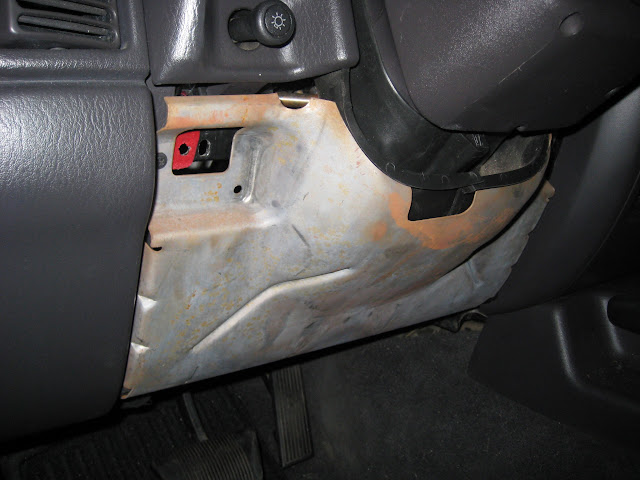

thats the grand cherokee BCM, found under the dash on the left hand side of the steering wheel. behind a metal plate with 4 screws holding it in, have to remove the bottom plastic piece. I pulled on out this weekend at the junkyard.

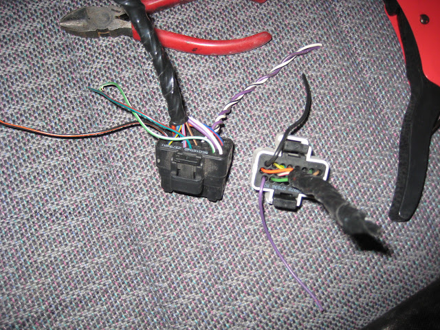

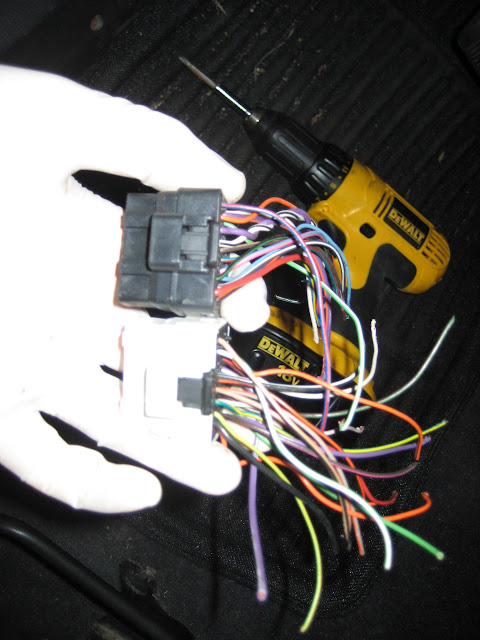

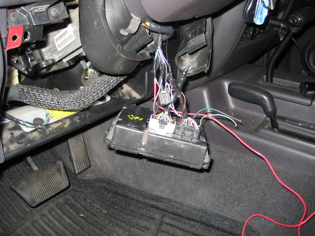

You need the ZJ BCM. You connect the temperature sensor to the BCM, and then connect the purple and white CCD bus wires on the BCM to the XJ purple and white wires. Connect the purple and white from the XJ, the overhead console, and the ZJ BCM and everything will work correctly.
Connect the wires like shown in this photo:
Originally Posted by 2001Jeepman View Post
Where is this unit found? I have a 2001 XJ. Is this unit in the XJ? Curious, as this may answer all my questions
No, that is the ZJ BCM, the XJ does not have a BCM, so the temp sensor connects directly to the XJ trip computer in an XJ. If you use a ZJ trip computer then you need use a ZJ BCM, connect the temp sensor to the ZJ BCM, connect the CCD bus(purple and white) from the ZJ BCM to the XJ. That will pass on the temperature sensor signal to the overhead console, and the overhead console will work 100% like the factory unit does this way.
