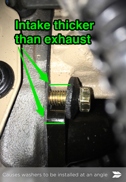

Here's what I noticed: the exhaust manifold and the intake manifold flanges were not the same thickness.
This new exhaust manifold flanges is thinner than the stock one.
The bolts go in straight but since the flanges are different in thickness, the washers go on a little slanted.

My question is: has anyone else ever seen such a thin aftermarket exhaust manifold flange? what would you do in my situation to fix this? Do you think the difference in thickness is causing the problem? Should I shave down the intake part?

X2 on that. You could fix the different thickness manifolds with some custom washers, you'll need a lathe and mill and some bar stock for that. A machine shop could make those at a reasonable cost, they wouldn't have to be close tolerance.

To address the differences in the flanges, I would make thick, custom washers, with cut steps, to deal with the difference flange thicknesses, helping to evenly tighten them.

Have a machine shop mill the intake washer flats to the necessary thickness.

This new exhaust manifold flanges is thinner than the stock one...
If you have verified the difference in thickness by measuring both exhaust flanges, send that new junk back as sub-standard.

I may send the exhaust back if this doesn't work out. It's definitely thinner. I still have the stock one and can put my caliper on it and send them a pic for a refund.

Re-reading this thread, so the exhaust is thinner than the one you removed and the intake is the same as the one you removed?
Make sure the headers aren't interfering with the intake. Installed some APN headers on a 2001 a while back and the header tube for cylinder 5 interfered with a cast "gusset" (no idea what else to call it) between runners on the intake. Had to cut some of it to clear it and get them fully seated. The thickness difference shouldn't be an issue (mine was more substantial).

I just went through this with DNA motorsport. I emailed them before I bought the manifold to ask what the flange thickness was. Their response was that the manufacturer didn't specify that measurement but it was guaranteed to fit all oem measurements. My DNA manifold measures 0.39" and a stock is 0.493". I'm guessing they both start out with 0.5" flange stock but grind more off to compensate for warpage. Again just a guess. I filled an informal complaint. They gave me back $20 and I got to keep their POS manifold. I contacted speed_daddy and emailed "Nikki" the customer service rep.
