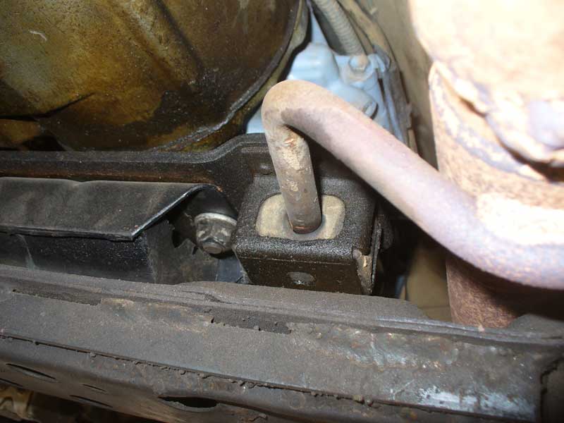

There should have been a hanger, looks like a long finger, welded to the exhaust pipe that slips into a rubber grommet on your cross member. The bracket for that shares the same bolt as your transmission mount.

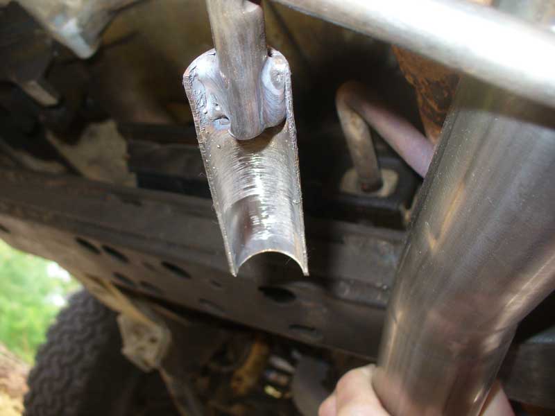

Be aware there are a couple of different designs for that piece of rubber. When I installed the Borla header in my '96 I had to change from the round bar support rod to the half moon shape. Here are some pics to help with what I mean:
I needed to switch from that above to this below:

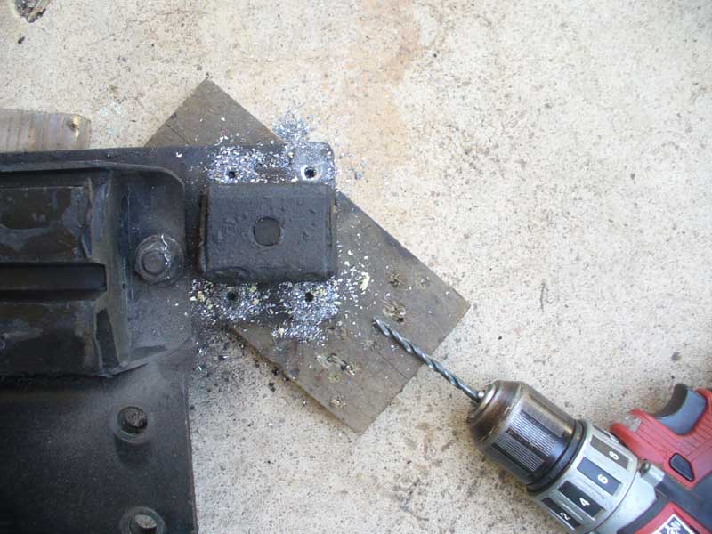

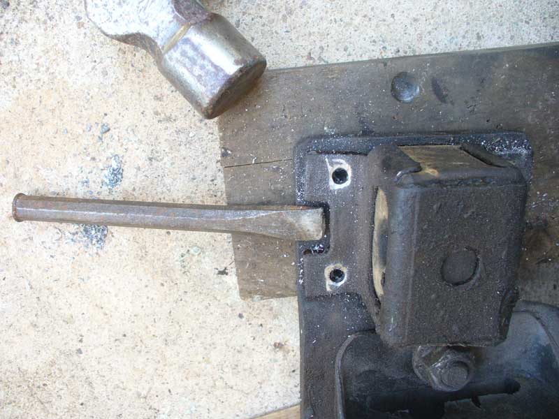

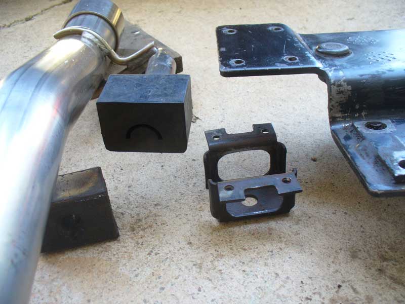

I was able to get the correct piece of rubber from Morris 4x4. If I recall correctly it was a Crown part. Replacing it required drilling out the factory rivets, using a cold chisel to separate the steel bracket parts (they really press those rivets in there), swapping the rubber pieces and then putting it back together with 10-32 screws and nuts.
Hopefully we are talking about the same thing and that makes it clear for you.
