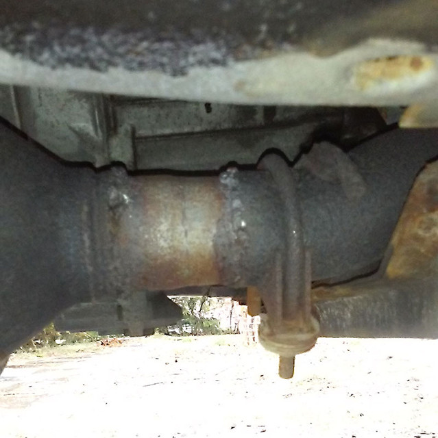

Ok guys, here we go.... what do you think is there enough of the down pipe left to work with here to install a new cat? I guess I could use a butt joint clamp if I got a clean cut on the cat pipe that's left. Any suggestions? p.s. i'm not even sure what the clamp is on the right. i think it might be left over from a previous repair.
