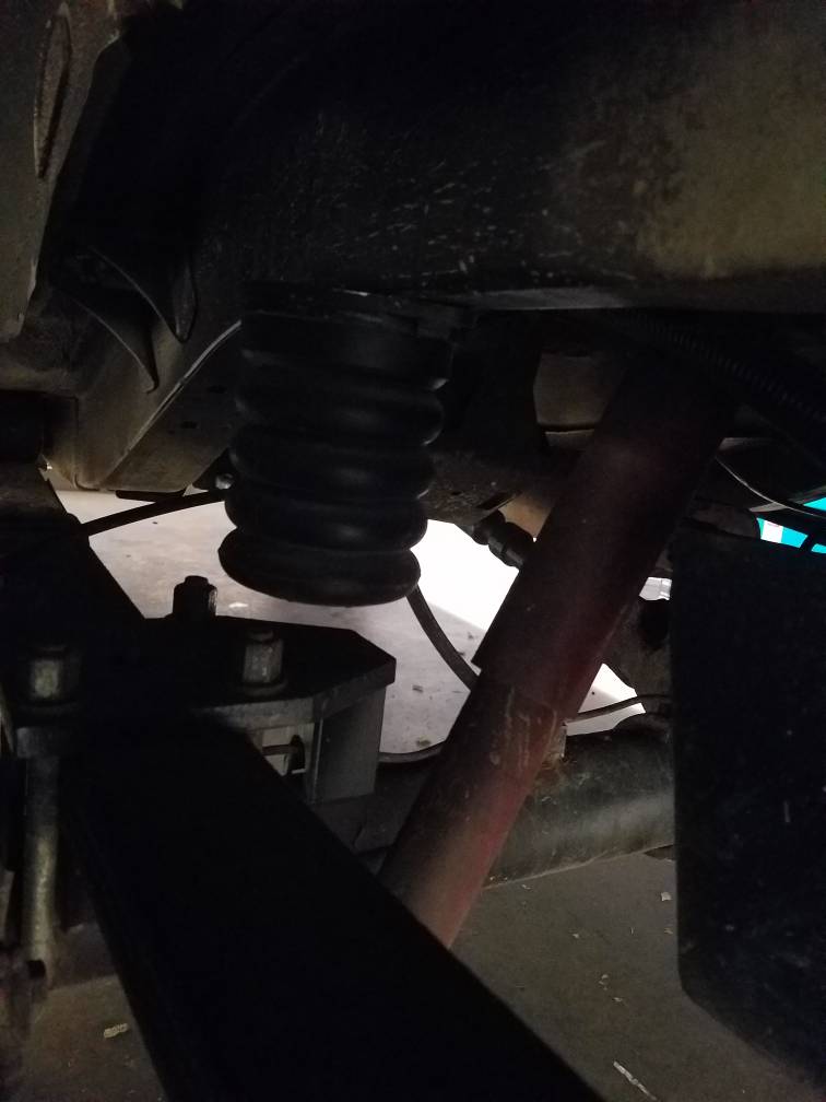

So I'm planning on using my XJ to tow a small travel trailer a few times a year so I can get back in the remote spots. I have been making a few changes to make that a more reasonable idea, one of which was adding sumosprings in the back. Really couldn't find much of anything on them, but they are essentially a progressive bumpstop that acts like an airbag under compression. They replace the rear bumpstops, so they don't limit droop. So far I've been very happy with them and the rear suspension rides very smooth over the high speed stuff. Have not towed with them yet. We will see how that goes.

Well my bump stop pads are extended leaf spring plates, so they are elevated above the axle. I used the standard no lift sumo springs, I have about 4 inches of lift and the sumo springs are about 1 inch from engaging on my leaf spring plates, when sitting at normal ride height.
I did weld a custom support pillar on the bottom of the leaf spring plate to prevent the sumospring from stretching my u-bolts or bending the leaf plate. I can take pics if you want.

Hopefully this pic helps. It's 2x2 tubing notched for the brake line, welded to the bottom of the extended spring plate.
