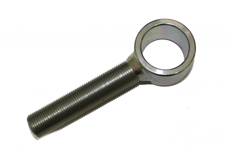

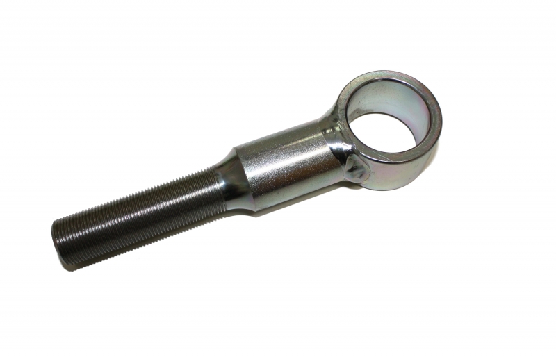

Which is why there are hard joints which are basically built into a shell. The Johnny joints made by Currie for upper axle bushings are an example - and are unfortunately too big.
I'm trying to retrofit a Johnny joint into an Iron Rock Offroad trackbar (frame end) . The ID of the bushing is approx 1-1/2", and approx 1-1/4" wide. The mounting flanges that this fits into are 1.6" wide - a narrow Johnny joint fits in perfectly, as it measured 1-5/8 mounting width. I'd gladly use that joint, but it's in a RE trackbar that I'm using with the IRO mount on another rig. Unfortunately, the RE bar is a 3/4" thread into the bar, and this is FAR too small to fit the IRO bar.
IRO makes a retrofit bushing the will fit this assembly in place of their rubber bushing. That's fine but I'd rather stick with the known quantity of JJ for this application. I like to standardize things as much as possible across my rigs. IRO seems to make a good product but I don't want to be stuck with an unsourcable part when it comes time to service this.
Of course some folks are asking why I don't just use the existing rubber bushing, especially since it's brand new. Very simple - it's not doing the damn job. I have motion between the trackbar and bracket. Yes they are all IRO parts. Yes they are properly torqued.
Honestly, if I could just get a straight answer from someone on the damn thread pitch for the IRO bar where the bushing assembly screws in, that would simplify this. I called them three times and they either tell me they will call back when the tech guys get back from lunch (hell of a long lunch, I guess!) or they go into a spiel about their special rotational joint which is designed just for this problem. Ffs, just answer my question IRO. I guess I'll just have to get the micrometer out and identify the threads myself... And hope there is a forged rod end version of the JJ they is compatible.

7/8" 14
https://www.ironrockoffroad.com/prod...-male-end.html

Are you absolutely certain of this? Because I found this in their website after a little inspired googling...
This states it's an M22 thread.
If you're certain it's a 7/8-14, I'll buy a skinny JJ rod end of that thread right now... But I don't want to waste $60 if you're not certain.... I'll post the kit it's going into in a moment.

As an aside, pretty sure the narrow JJ's are 2" mounting width. So while you can find that thread, you will not likely find one for the width you need.
I literally have one in hand. It's 1.6" mount width.

How old is your bar? It could be either, not sure when they changed the thread from M22 1.5L. You should be able to look at your bar and know which end out of those two you have, should be obvious.
