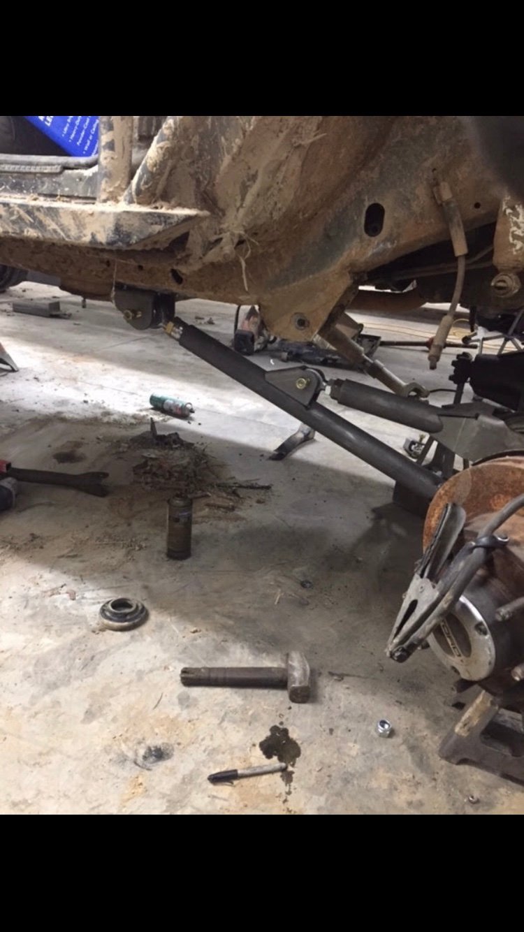

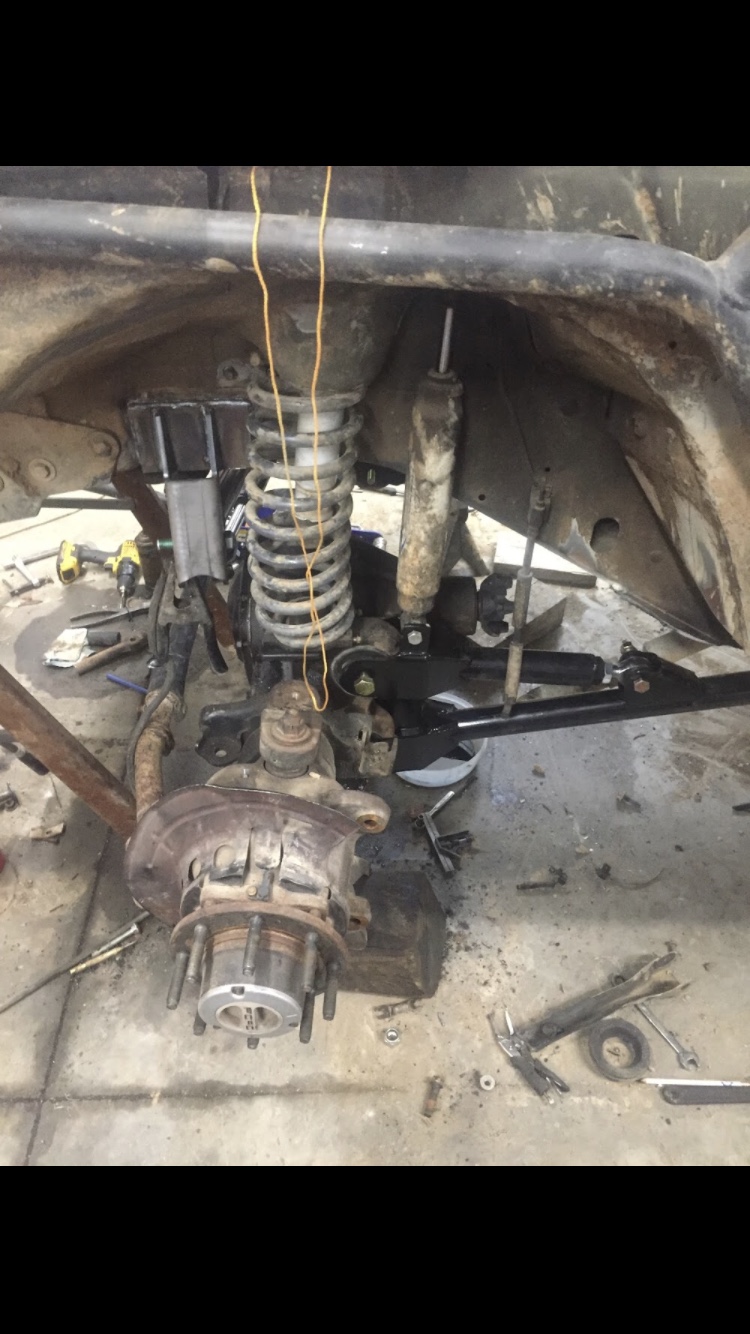

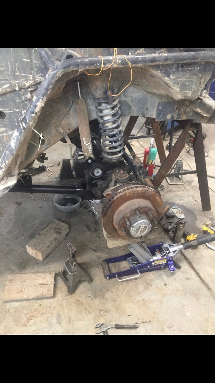

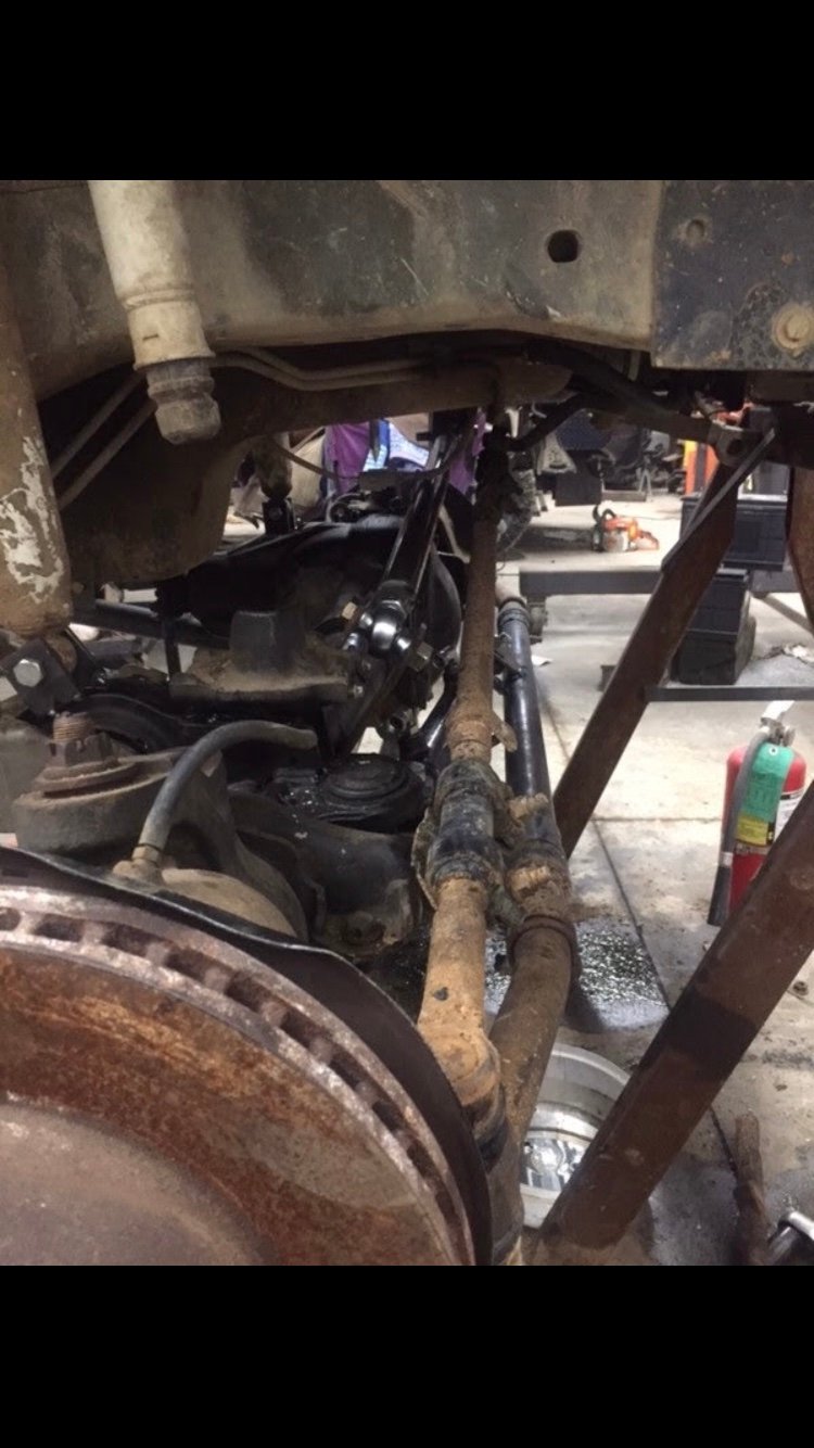

Can you post some pics of how you set up your axle brackets too? Thanks
Here’s some during the build. Unibody was plated, this was just during mock-up.
The trackbar mount/plating didn’t work. It’s been redone. It was a good idea. But absolutely failed.
Passenger shock mount welded to axle side radius arm bracket so the upper can be removable. The drivers shock mount is welded to the upper arm, because the mount on that side is cast.
Other then that, this is pretty much how it’s been ran for the last year. The stock coil buckets can be drilled and tapped into the bump stop pads on the axle and will line up perfect width with the xj coil buckets.
Noteworthy changes needed, upper shock mounts need reworked.
