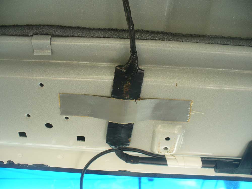

I might have a couple of useful pictures for you. These are from when I redid the headliner in my '96. I was taking these pictures more for the sake of recording the fine use of duct tape on Chrysler's part, but I think these will provide you with some idea of what is to be found up there.
This first pic is of the space directly above the windshield and a bit to the right. The slightly raised area with the two holes in it, one of which shows bare metal, is the location for the sun visor retaining clip. There is not much to provide a sense of scale, but you may be able to estimate scale by using the distance between those two holes for the sun visor clip:

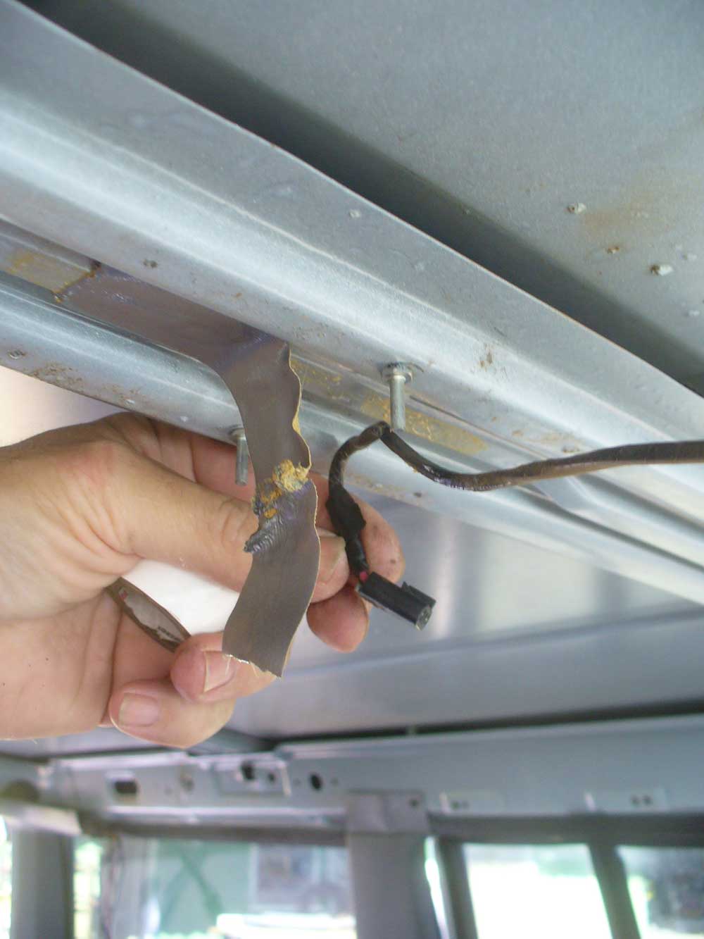

This second picture is of the support for the dome light. It is probably not nearly so useful as the first, but it is the next support member available to you:
Figure you have several inches worth of mounting surface in the area directly back from the windshield, and then you have to extend all the way to the dome light support if you think you need more support structure than you can get from the windshield area. And of course, be aware of where that dome light wiring runs. It is probably in an inconvenient location and you will have to work around it. (In case it isn't clear, that is the dome light wiring that is being retained by that fine duct tape.

Just so I can confirm, in the first pic, those three holes to the left of the picture that are in a triangle, that is the center of the windshield,correct?
If you were to guess, from the visible surface of the crossmember where the three holes are to the inside surface of the actual roof skin, whould you say there's 1/2-5/8" of clearance?
I'll probably use those three holes to attach a piece of sheet metal that extends rearward a bit then attach the CB bracket to that. It's also nice to know that the power for the dome light comes from the front like that. I always assumed it came up the "B" post and across. I might add another dome light in that area as well. Maybe a pair of those MJ "B" post lights that can be switched on manually or disabled all together by moving the lens.

I am pretty sure that those three holes (the triangle) mark the center.
That estimate on depth also sounds reasonable.
Once you open things up you will be able to confirm both of the above issues.
